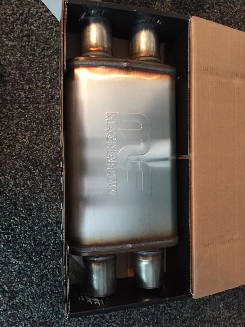

Thanks zack if you don't mind me asking how much was the x pipe
zackmd1
zackmd1
Oct 1, 2013
140
5,283
3,451
Maryland
Zack
1970 Mustang, 1965 AC Cobra, 2023 Ford Bronco 2Dr
$115 from amazon. Not bad for an x-pipe and muffler essentially if you ask me.

Hey Davekro!
I just got my sound clip uploaded a bit ago! Here it is! Keep in mind this is without cats and with long tube headers so this system should have tons of rasp. Thankfully though the 11385 plus the two round magnaflow axleback mufflers keeps this all in check. I will try to answer your questions one by one!
[ame]
1) Yes the ID of the 11385 inlet and outlet measures 2.3".
2) It should be easy to do this. The suitcase center to center is 4.25" while the 11385 is 4" so there might be a slight issue there. I don't think it is a big enough difference though for it not to work. Just might take some persuasion ;)
3) Like I said above I have two magnaflow round mufflers (same as used in their competition axleback) headed out to 3.5" double walled tips. The interesting thing about these tips is that the ID is just about 2.3".
4) For an LT header catless exhaust it sounds great! Kept the rasp in check and does not done to bad... There is drone around the 1700 rpm mark but it is much less then the previous systems I have designed. It is hard to say if the 11385 is responsible for this but it is possible.

Zack,
3) I see from you video you used 4" round x 14" long MF 10415 mufflers and mounted behind the axle. (with tips mounted to them?)
What brand & p/n tips are you using now?
4) I forgot about the LT's & catless part. I assume you do the entire system all at once, meaning install LT's, 11385 and 4" round MF mufflers.
Wow, that has some LOW resonance, ouch. I look forward to your drive away and interior videos. I have been hyper focused on banging my head against the wall (trying to remove drone by swapping the thingies at the end of the system). Like the guy at Flow master said to me today, I think I need to try adding and H-pipe and resonators, but I sure do like the ease and price of an all-in-one crossover w/ resonator included like the MF 11385. Do you know what the innards of it are composed of? What did it look like looking down the inlets & outlets?

It is actually not as bad as the video is making it! The camera was a bit overwhelmed from the audio. The next sound clip I will have my camera man take a few steps back! Interior resonance is not bad at all. Like I said I have a hint of drone around the 1700 rpm mark with some drone on deceleration. Not bad at all though and certainly not annoying for me. Check out my LT exhaust thread for some pictures of inside the 11385. It is a perforated x-pipe with what I am assuming is stainless steel mesh and fiberglass packing comprising most of the oval. If you are looking for an h pipe and resonators then I would just go with the 11385 as it is really combining both into one. (except x pipe instead of h)
3) The tips are just some I found on eBay for $25 a piece.
http://www.ebay.com/itm/161205646173?_trksid=p2060353.m2749.l2649&ssPageName=STRK:MEBIDX:IT
4) Yes I did the complete install so I can't comment on how the 11385 alone changed the exhaust note.
My guess is that swapping the suitcase for the 11385 will provide you with a bit more sound. Your exhaust note will gain a new "growl" instead of the rather blunt note it currently has. My suspicion is that it will cure most of your done but don't quote me on that!
