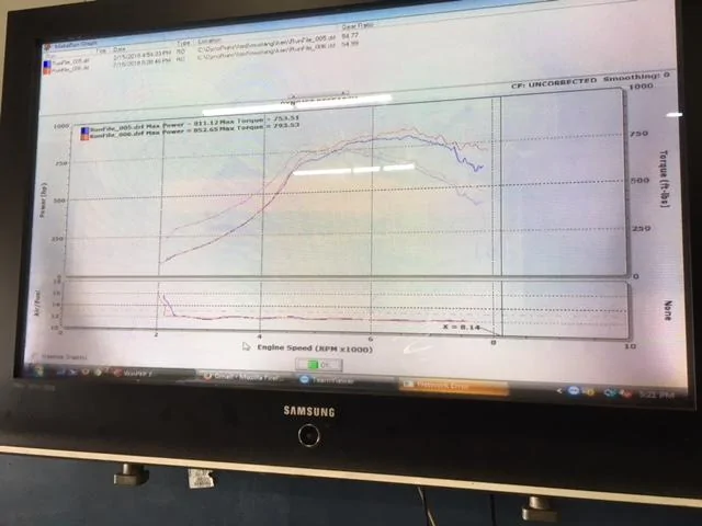

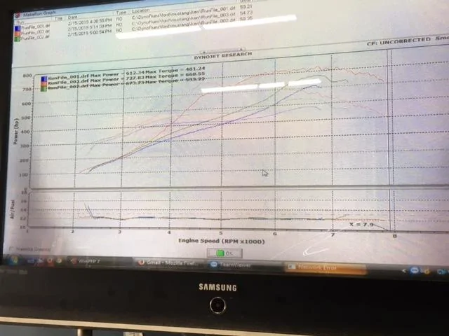

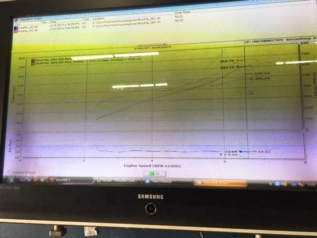

I finally got my car back on the dyno day with new hellion sleeper kit. The mods are listed below. I can't wait to get back to the track and see how it feels with almost 800 FT LBS. Jon Lund JR did a great job on the tune and the car has more in it if I want to push a little more.
Stock engine with OPG/timing gear, Return fuel system, ID 1050X, Pump E85, Unported 2018 intake, hellion sleeper with precision 6266 JB, 6r80 245 3c stall, 3.73 gear, boost leash on CO2, 14psi
