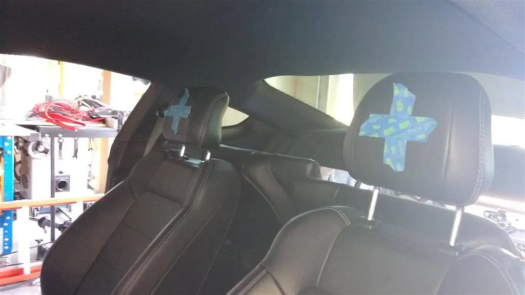

I was about to remove the seats when it dawned on me that it might be a little difficult to take time alignment measurements with no seats in the car. :facepalm: I'm trying to get as much prep work as possible done so that I'm not fiddling with building tuning files from scratch once I've finished the physical install. So it's measurement time.
Also, when it's 92F in your garage, and you're sitting inside a closed car taking time alignment measurements, it's approximately eleventymillion degrees (Farenheit) inside the car.
I put both seats where they usually are and put an "X" with painter's tape in the middle of each headrest.

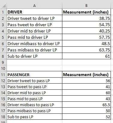

I then measured from the center of each speaker's grill to the middle of each X. I made the attached spreadsheet to help capture the info, but here's a screen grab of it. Coincidentally (not really, I did it on purpose) the order I've got the drivers listed in mirrors how the JL Audio TUN software lays them out in a 4-way system. It goes left tweet, right tweet, left mid, right mid and so on. I've gotten used to "looking" at the system like this so I stuck with the order.
Theoretically the passenger's measurements should be reverse mirrors of the drivers. But the passenger seat gets moved around, depending on who's riding with me, so I put it in what I think is its most-used position. I also move the driver's seat from time to time, but I put it in "the usual spot" for these measurements.
I realize these measurements are only starting points and they may be off by a 1/4" but by the time I finish tuning, all the delays affected by these starting points will likely change anyway. But at least I have a starting point.

My distances are about 5" to 8" less than yours. Maybe you sit farther back or more reclined. Or maybe you're taller and need to. I sat in the drivers seat and measured to the tip of my nose. Probably not the most accurate but it gets me close. I still have to do impulse measurements and probably should do that before I do any more serious EQ adjustments. My DSP has a place to add additional delay offsets to each channel so data from the impulse response should allow me to tweak the timing. I'm kicking myself for not buying the TwK 88. You really need parametric EQ. I have a nasty wide peak at 315hz in my drivers mid-bass and some other problems areas. On my 31 band fixed Q filters, I have 315hz pulled all the way down -12db and it's still not enough to tame the peak. Going to be a real challenge matching the left to the right side with 31 graphic eq. The right side is much better due to the longer distance to the speakers. I am really interested to see your first measurement of each driver with no EQ to see if we have similar frequency response problems.

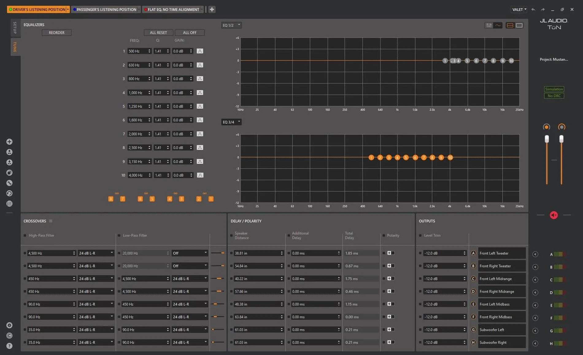

I probably didn't explain that correctly. The JL Tun software gives you two assignable, 10-band parametric EQs per input. You can link the two EQs in a stereo pair or independently assign them L/R. Here's a pic of my current tune. I have EQ 3/4 selected (midrange driver/input) and you can see the frequency centers I set.

I thought the TWK88 has 10 band PEQ for EACH output? You will want to unlink those EQ's so you can do independent EQ adjustments for each driver.
