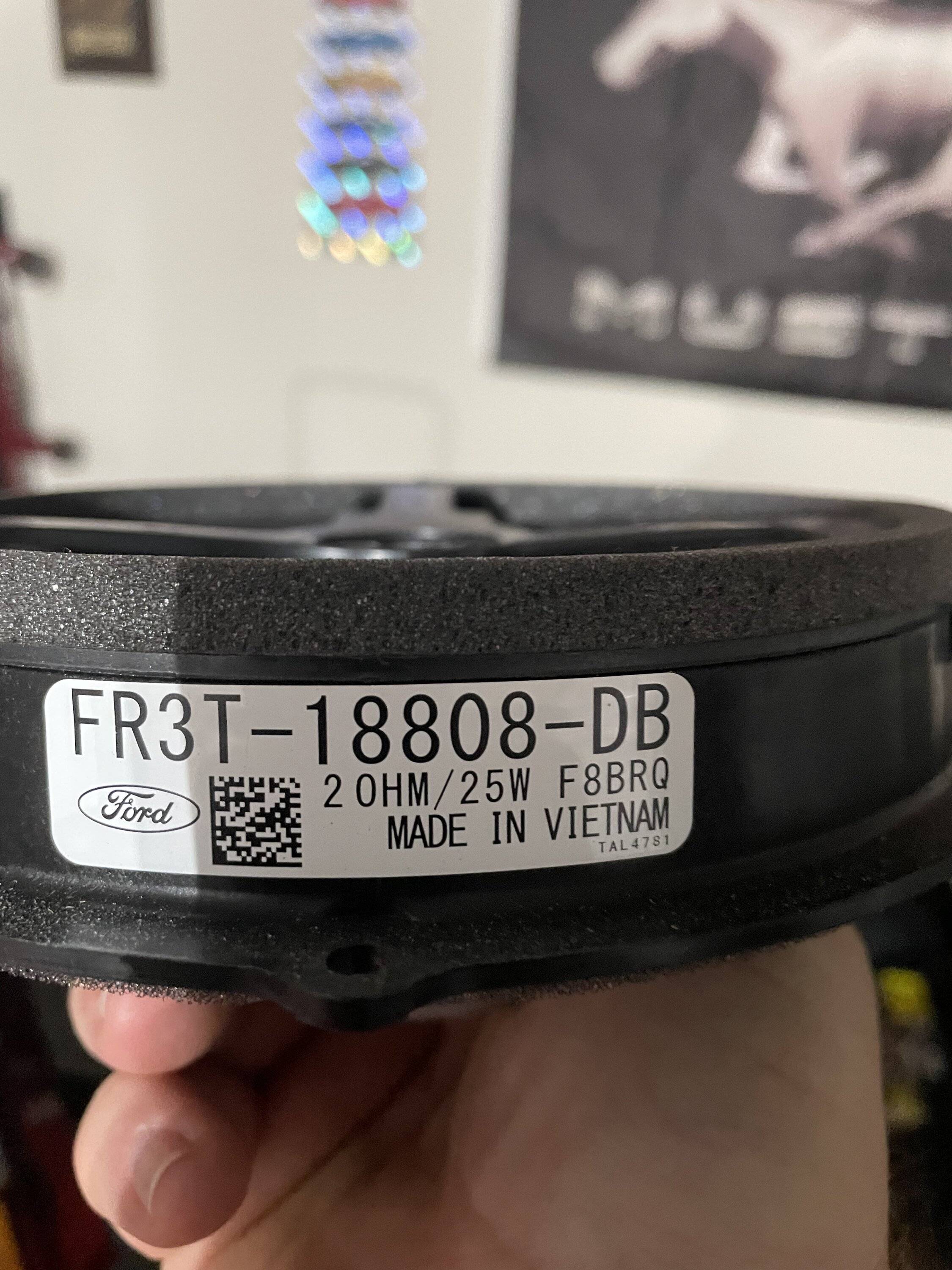

Reading the attached thread link on the rear speakers is what lead me to believe that they are 2 ohm.
Hi All, When I started my audio upgrade, I first replaced the rear speakers on my 2018 9 speaker system with the coaxial units from the 12 speaker system. The Ohm rating for the rear coaxial factory speakers from the 12 speaker system is 2 ohms.

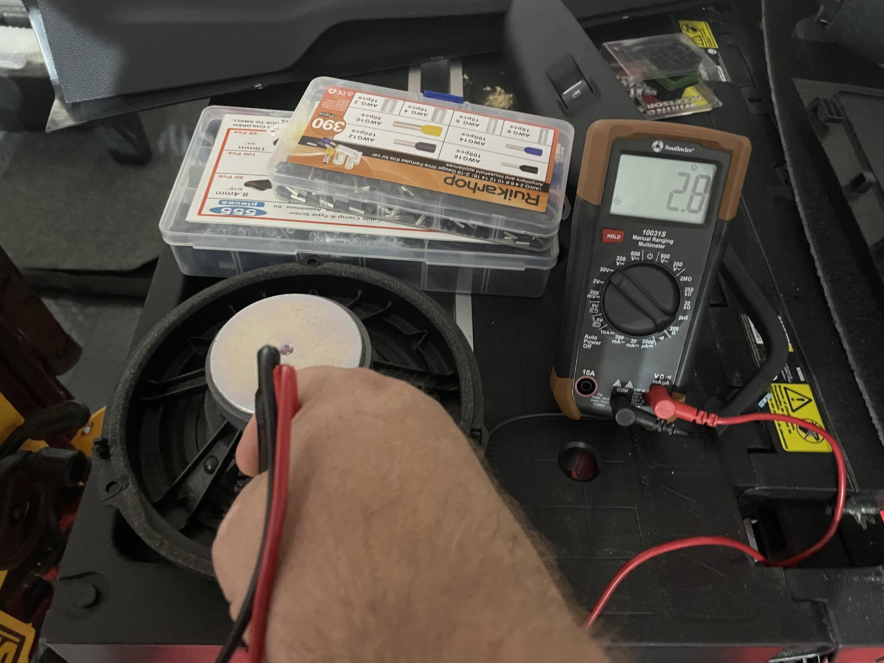

They are INDEED 2 ohm speakers but they ohm out at 2.8. I checked both of my OEM B&O rear speakers. But here’s the caveat. They are coaxials with the tweeter wired in parallel so each of them is 4 ohms.
Ah, just like they make up 4 speakers of the 12 speaker system.
Thanks for the pics btw.
