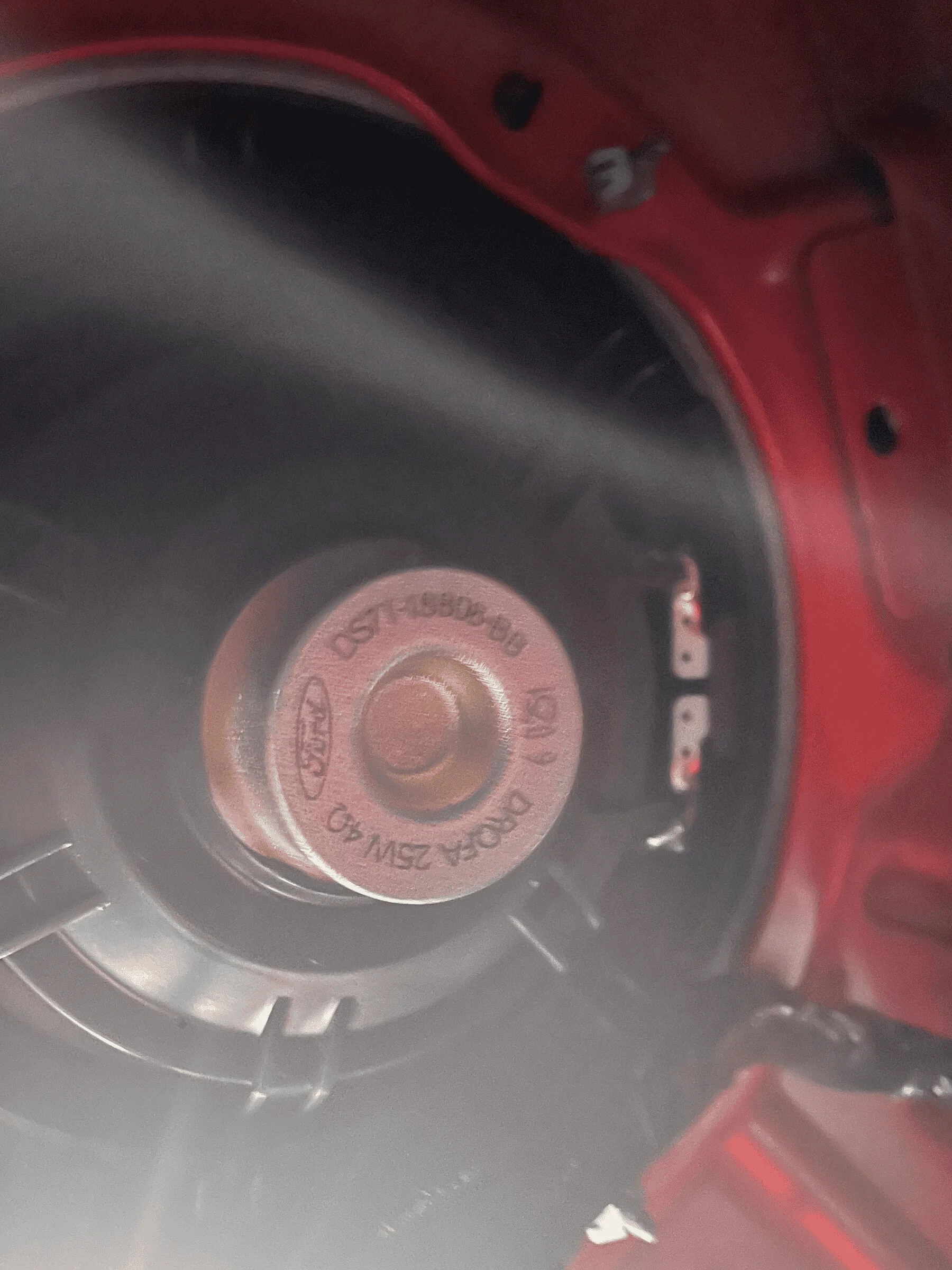

I have a messed up rear deck speaker in my GT350. My wife shoved too much crap in my trunk and now have a broken speaker. I have the B&O system and I'd like to upgrade (if I'm buying a new speaker, I'm not going to replace it with the stock one), but I'm not ready to go full on replacement of all the speakers, amps, etc.
My question is, since the stock speakers are 2Ω, would you replace the rear deck speakers with one of the few 2Ω ones on the market or just go with a nice 4Ω knowing that it'll be just a little bit quieter?

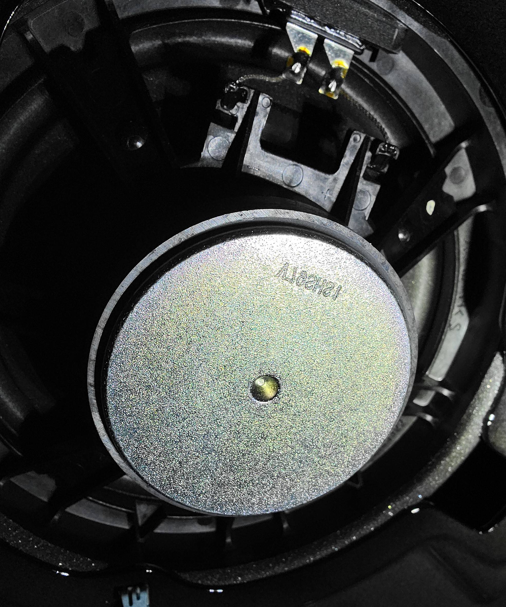

What year Mustang do you have? My 19GT 9 Speakers are 4 ohms

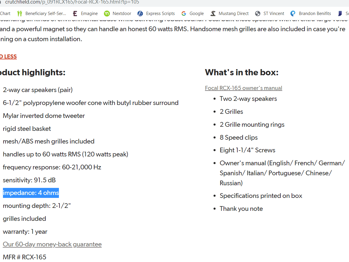

Ah, thought the B&O rears were 2Ω.
Well My 19 GT Are 4 ohm and When I look up speaker replacements on Crutchfield they show the rear deck on the B&O System as 4 ohm?

Yeah, I've already looked. No context clues on mine other than a backwards alphanumeric that doesn't yield any google results.
Mine are like yours. Data shows they are 4 ohm. That pic of the red car must be a lesser system.
