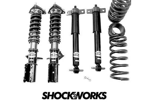

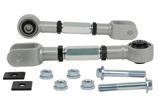

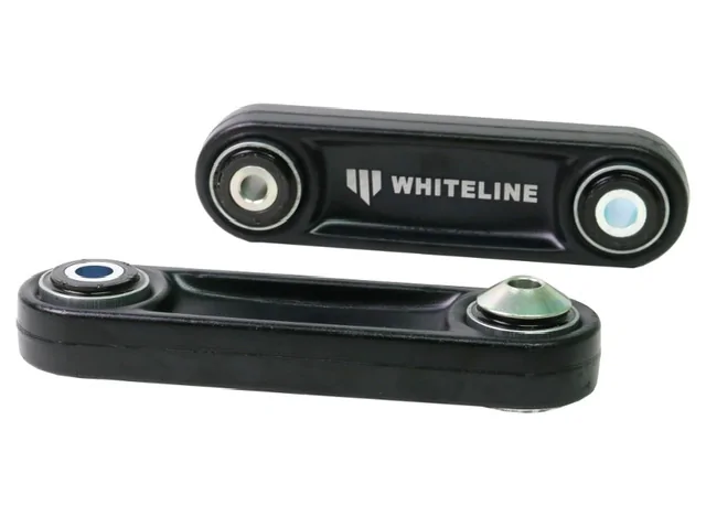

Thanks for all the input, I eventually decided to do a big upgrade and went with Shockworks Coilovers, Whiteline sway bars and rear toe and vertical links.
The ride quality is firm, but comfortable. Overall the handling and traction is superb, a significant improvement on the Ford Track Handling Pack.

@Aubrey - never seen those. Do they publish the spring rates? Glad you are enjoying them!
