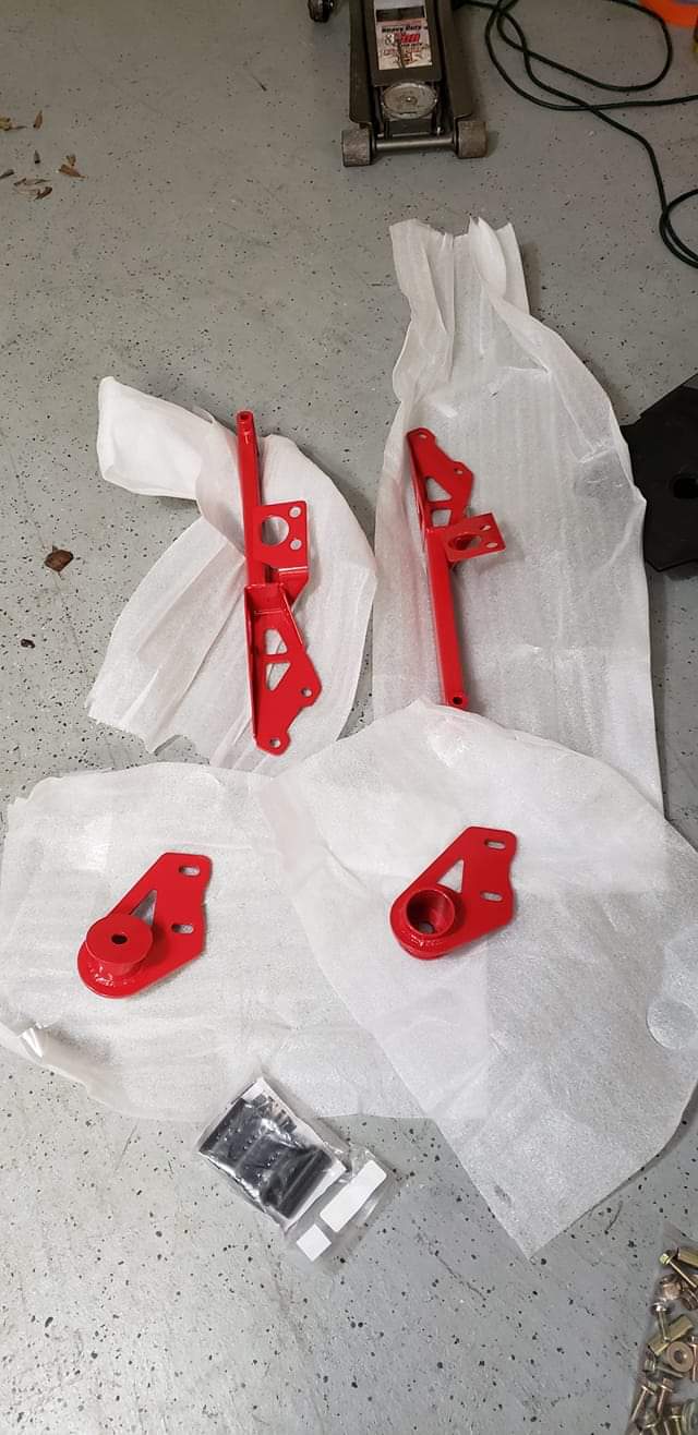

BMR CB010 was installed while I was doing springs, so this was pretty easy. I received the cb762 a few days later. Which I promptly installed. The rear braces are super easy to install. The front braces require a little more finesse. Definitely keep everything loose until all the bolts are started. So far all wheel hop seems to be gone and zero increase in NVH. The rear is much more planted now. I think BMR should offer their cradle lockout kit with the rear braces from the CB762 as a kit by itself.
