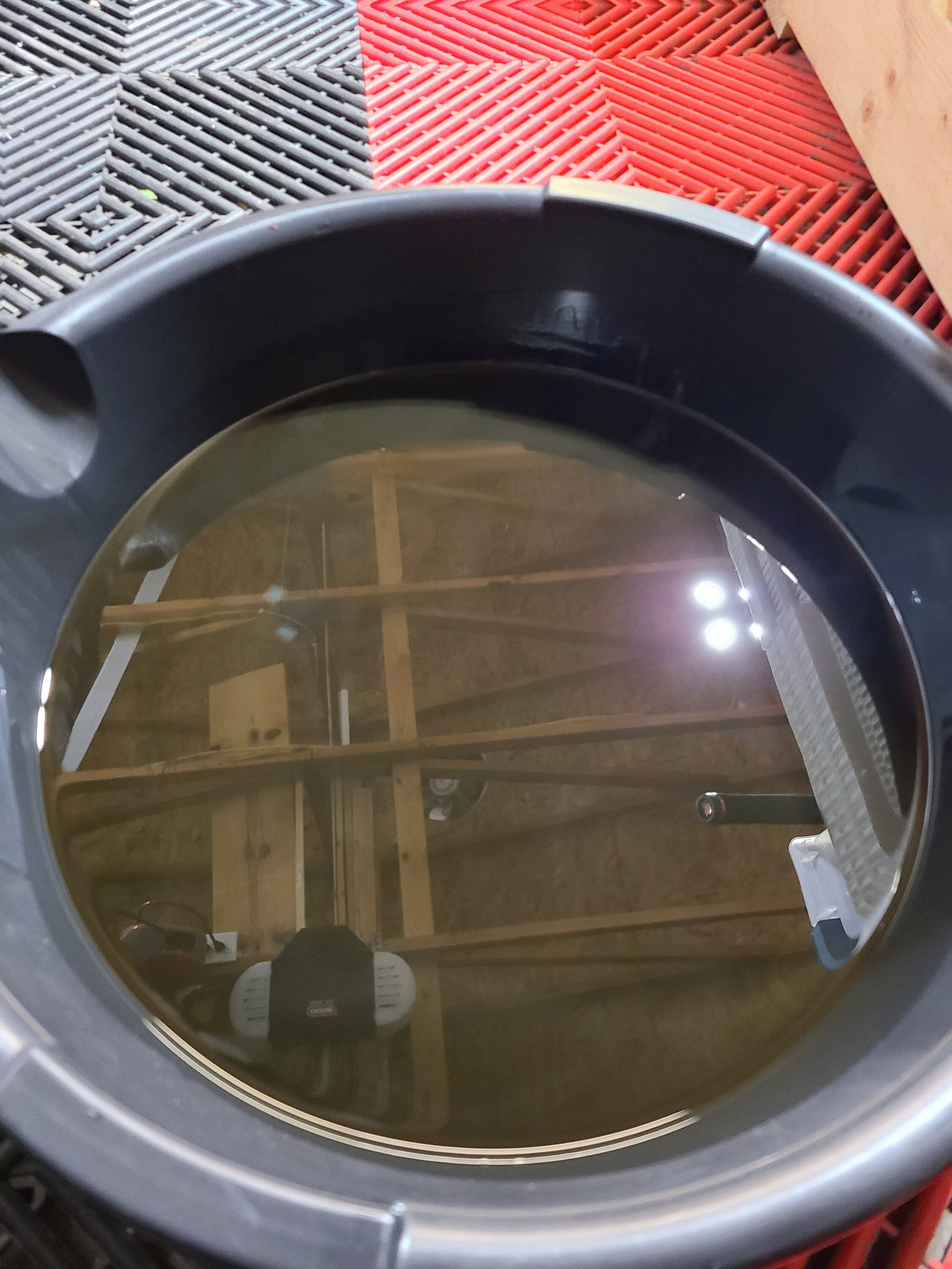

It's fairly normal, same story here. If there's no audible grind, you're not hurting anything. Just feeling the synchro working. I think it has to do with the alignment of the shifter. My car is similar to yours, WOT shifts feel butter smooth with zero resistance. But the torque is throwing the whole motor and trans backward under full throttle.
If you want further reassurance, I dropped my trans fluid out at 17,500 miles to swap in some Motul DCTF (and remove the factory fill and any break in material), and the fluid was absolutely spotlessly clean of any contaminants. And my car has had those "nibbles" since I picked it up with 10 miles.

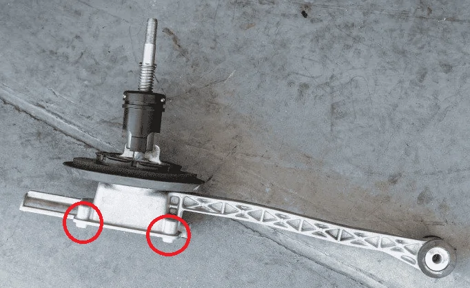

Try installing the Full Tilt Boogie solid OEM shifter mount.

I didn’t even know Full Tilt had such a mount. Does it work with aftermarket shifters? I currently have the Steeda Tri-ax race shifter with stiff springs, as well as the clutch spring.
Doubt it. The Full Tilt bracket bolts up to the bottom of the OEM shifter where circled:
