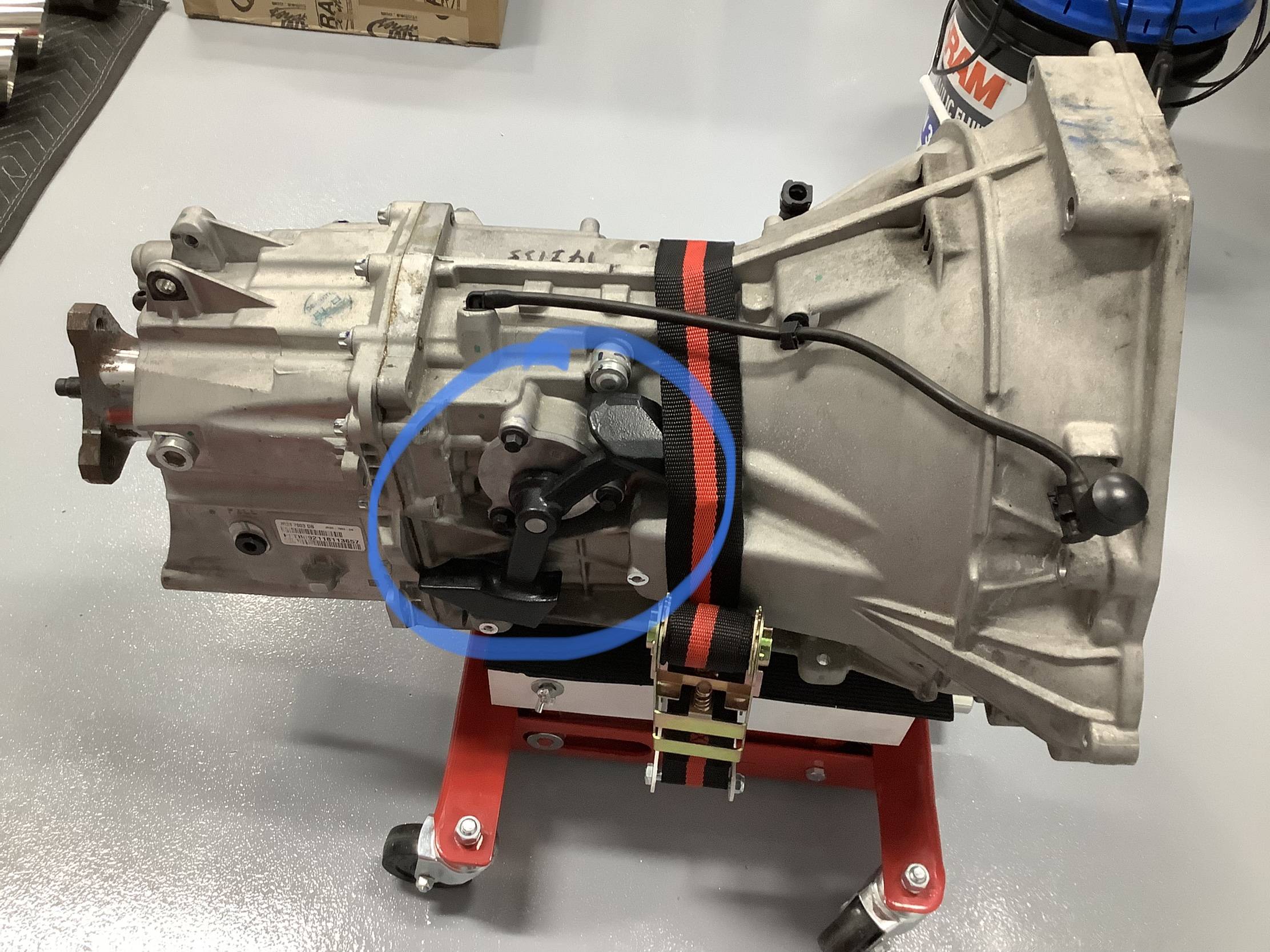

Keep in mind the rattle might be coming from the counterweight on the side of the tranny too. It rattles a whole lot.

Mine won’t be going back on when I’m finished with the rebuild. I bought a delete plate from Calimer.
I will try to take a video. It may come through on the sound but it's very pronounced in the "feels" dept.
I will check that when under there. The trans moved about a qtr inch on the jack when the crossmember was removed. FAR less than when the mechanic installed the shifter over a year ago.

Try duct taping it up and then revving it in neutral to see if the rattle goes away. If it does, you’ve found the problem and the Whiteline mount might not be the issue.
