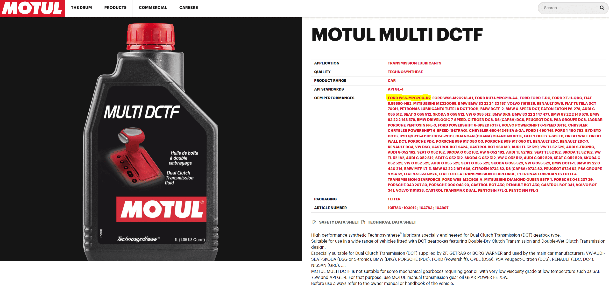

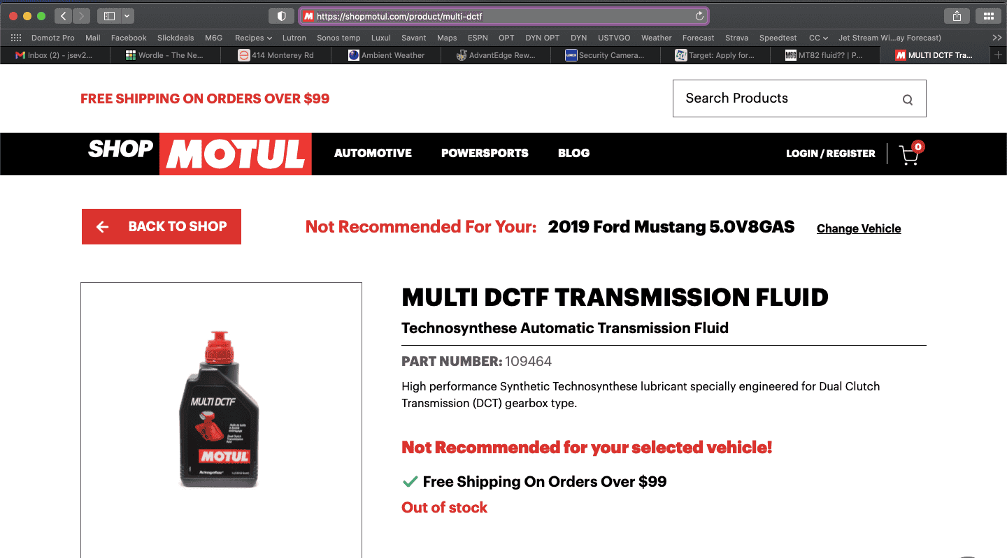

Interesting, I can't find a link on the Motul website directing you to ShopMotul and I see no mention of 'High torque DCTF' on the Motul website either....
Whois shows different registrars...

The MT-82 Trans spec is DCTF. Any reason why you wouldn’t consider a high quality DCTF fluid such as Motul Multi-DCTF ?

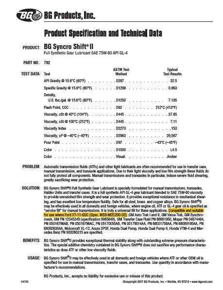

BG Synchro Shift II Meets or exceeds Ford's Specifications for their OEM DCT Fluid, spec. Ford XT-11-QDC (Spec. WSS-M2C200-D2)
I’ve been a GBSSII uses for over a decade in other vehicles so I’m aware.

I would use Motul DCTF but as for BG I do not consider "compatible and suitable" to be the same as "meets or exceeds".
Bob, because the Ford spec is for a DCT transmission fluid, BG Syncro Shift II works in all manual transmissions. So it meets or exceeds the Ford Specifications for use in the MT82.
The OEM supplied Tremecs call for an ATF fluid, but everyone knows an ATF is a poor choice in a manual transmission so we use BG SyncroShift. Does BG Syncroshift (or any manual/DCT fluid) meet the specifications of an ATF? No, because it is a manual transmission fluid. You would have a bad day running anything but ATF in and Automatic transmission. The MT82 is not a DCT transmission, it is a conventional manual transmission.
After offering our kits for 7 years and the feedback received, I am confident in stating that BG Syncro Shift II far exceeds the fluid performance requirements of the MT82 series manual transmission. The BG product has been used in the MT82 since it was introduced in the Mustang, so that's a 12+ year history.

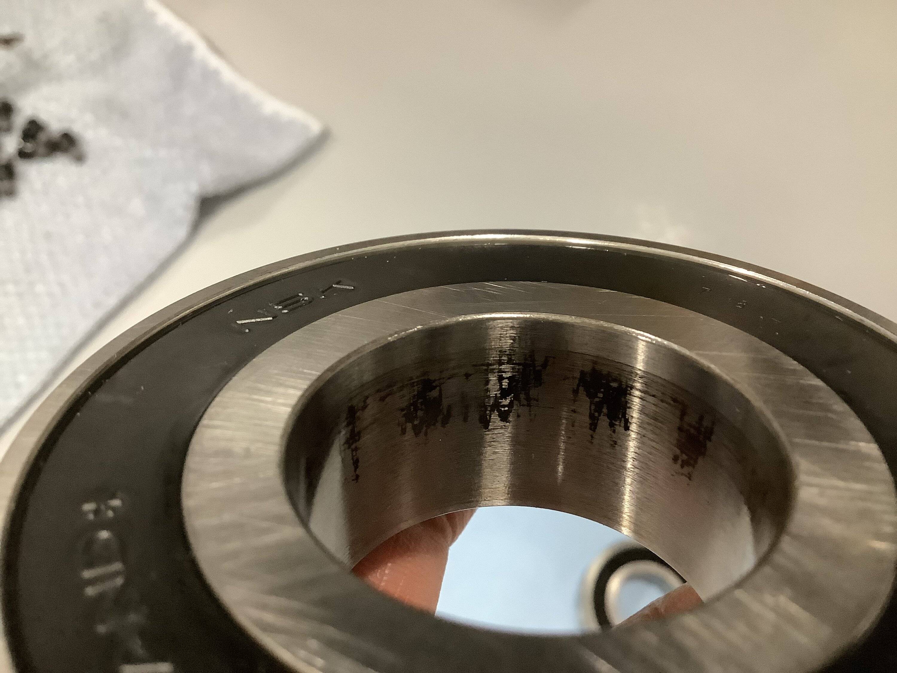

Upon teardown of my MT82-D4, I noticed that coating on the synchros was gritty like sandpaper and easily rubbed off on my fingers. The inner bearing race on the input shaft also looked like this. I don’t know if this was caused from the factory fluid or not, because I only had BG in the tranny for maybe a couple hundred miles before the teardown.
