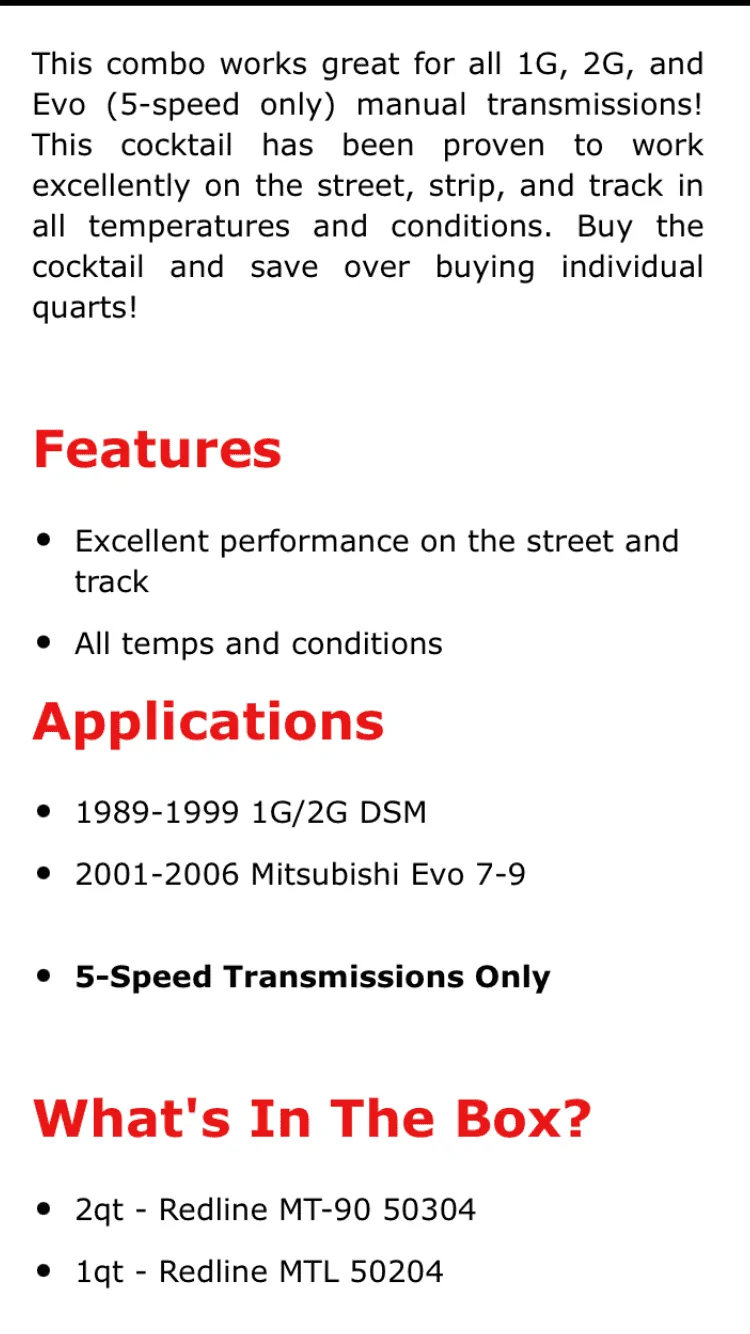

Apparently the old “calimer cocktail” was 2 quarts Amsoil syncromesh and .75 quarts of Amsoil trans 75-90. Then he changed it and said he recommends only Amsoil 75-90 trans fluid and that was on his Facebook page in June of 2021.
Give it some more time and you’ll see Motul Multi-DCTF will be recommended…….
That Amsoil cocktail is nothing more than a plagiarized version of the Redline manual transmission cocktail from the 1990’s

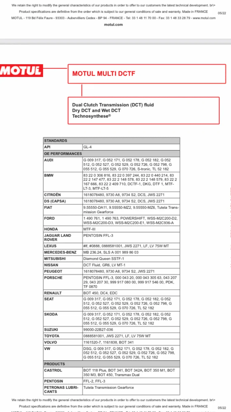

When I visit the Motul site it says the Multi DCTF is not recommended, the High Torque DCTF says it is....
Where does it say that it's not recommended?
The product page states it meets Ford WSS-M2C200-D2 spec for MT-82.

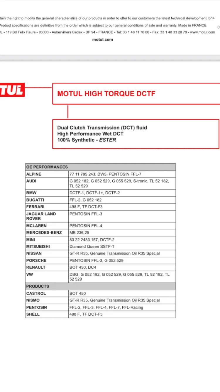

I’m not sure how long Motul High Torque DCTF has been available, I think this is a newer product.
It’s clearly labeled;
Multi-DCTF is Semisynthetic (Technosynthese)
High Torque DCTF is 100% Ester based
For those that don’t know the Multi-DCTF was developed and tested for 1200 HP Nissan GT-R track cars.
I’m interested in knowing exactly when did Motul start offering the High Torque DCTF.
