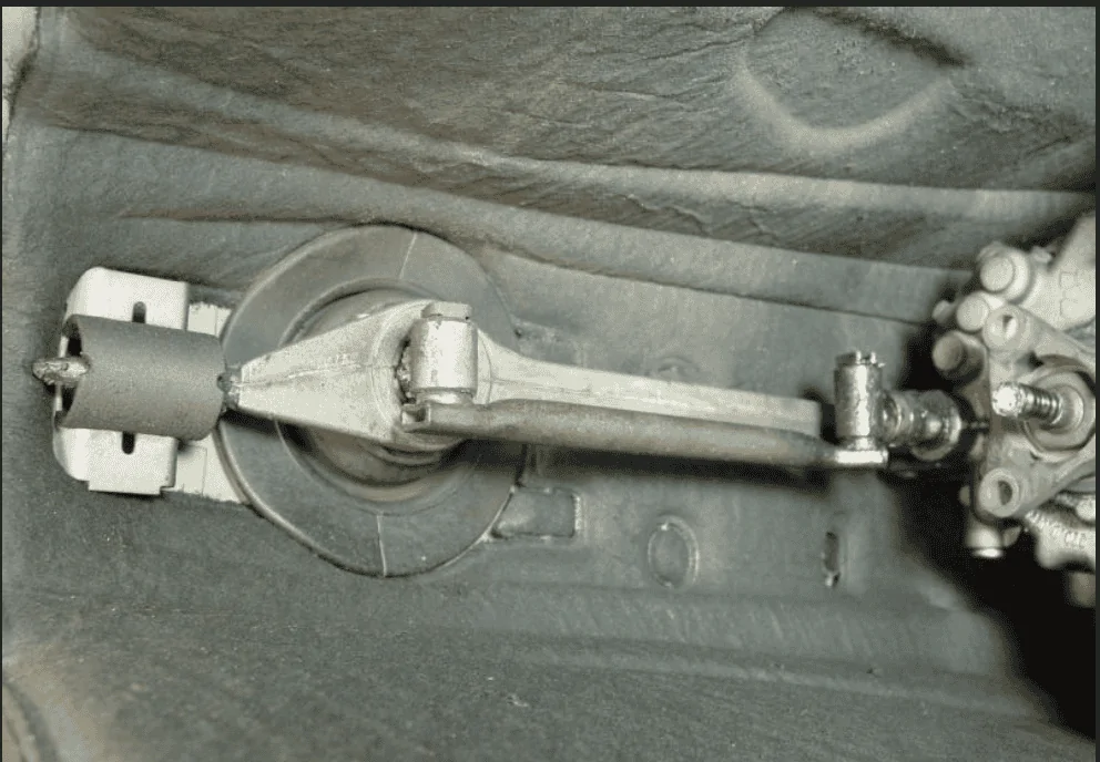

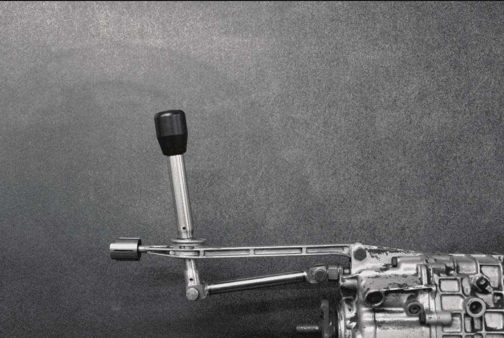

Not necessarily. On BMWs all shifters are transmission mounted. There is no NVH. There's a lot of rubber involved - you might hear people calling BMW shifters rubbery- but a lockout is something that's completely unheard of. And some of those cars use Getrag transmissions as well.
You have a stationary rod on which the shifter pivots on. The front of this rod is bolted to the trans (rubber bushing). The rear to the transmission tunnel. This is the only connection to the frame and it is made via a supple rubber bushing. The bottom of the shifter is linked to the selector rod which shifts the gears.
On race (road course) cars, people sometime upgrade to chassis mounted shifters (and delete the stationary rod) but these only work if you also upgrade your engine and transmission mounts to solid units. Otherwise your engine and trans move around while your shifter doesn't and you can't find your gear (especially in a corner!).
I gotta say coming from BMWs I was surprised to find out Ford is using a chassis mounted shifter on a factory street car with soft bushings. It's no wonder people are having issues.

Welp, just found out the Ford setup is actually pretty similar with the front of the shifter bolted to the trans and the one chassis mount bushing on the rear :inspect:
