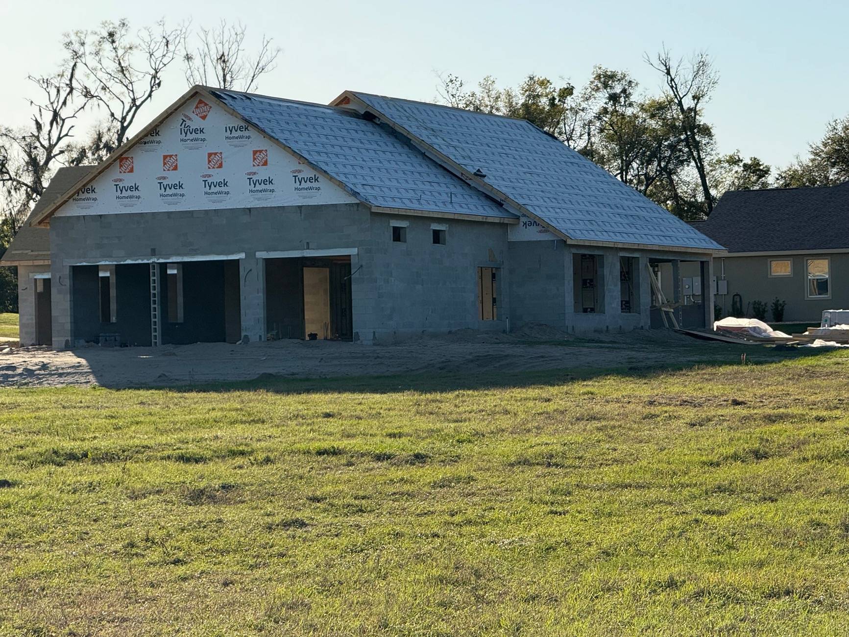

Looking good my friend. Moving along nicely. I can’t tell, is that a two or three car garage back there?
Thanks! That pic from the back is actually the lanai which will have French doors and side lights. The doors were delivered yesterday, so they should be installed soon.
These are the only pics that I kept of the garages. They’re actually side entry garages. There‘s a 2 car and a 3 car. The 2 car is the one with the peak above it from the front view of the house and to the right of that is the 3 car. You can kind see the 2 car a bit in this pic.

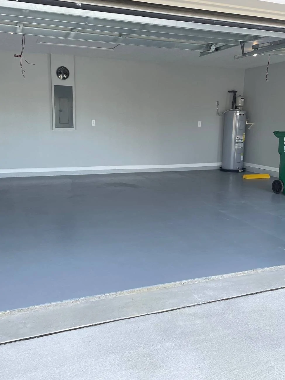

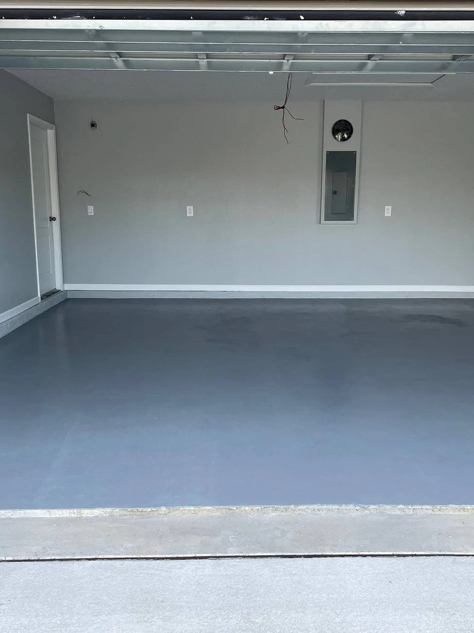

Here‘s our son’s. I did his without fleck because he turns wrenches a lot and it’s easier to find nuts, bolts and screws when dropped than it is with fleck.

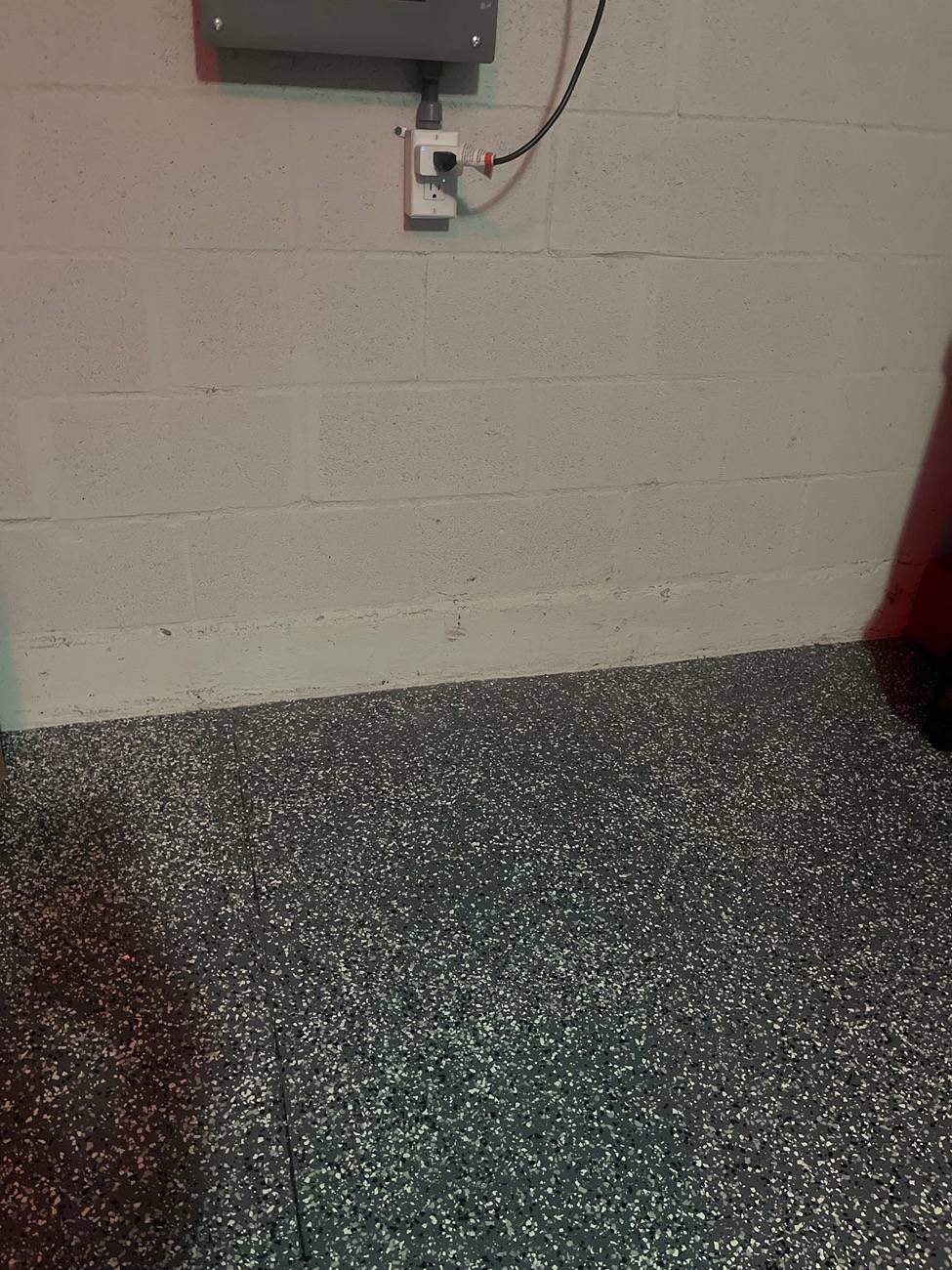

A couple of our daughter’s floor before the footings were painted to cleanup the epoxy that I got on them. One thing I’ll mention about the fleck is, if you go with a heavy broadcast as seen here, it’s gonna be more durable (especially once the topcoat it applied.
