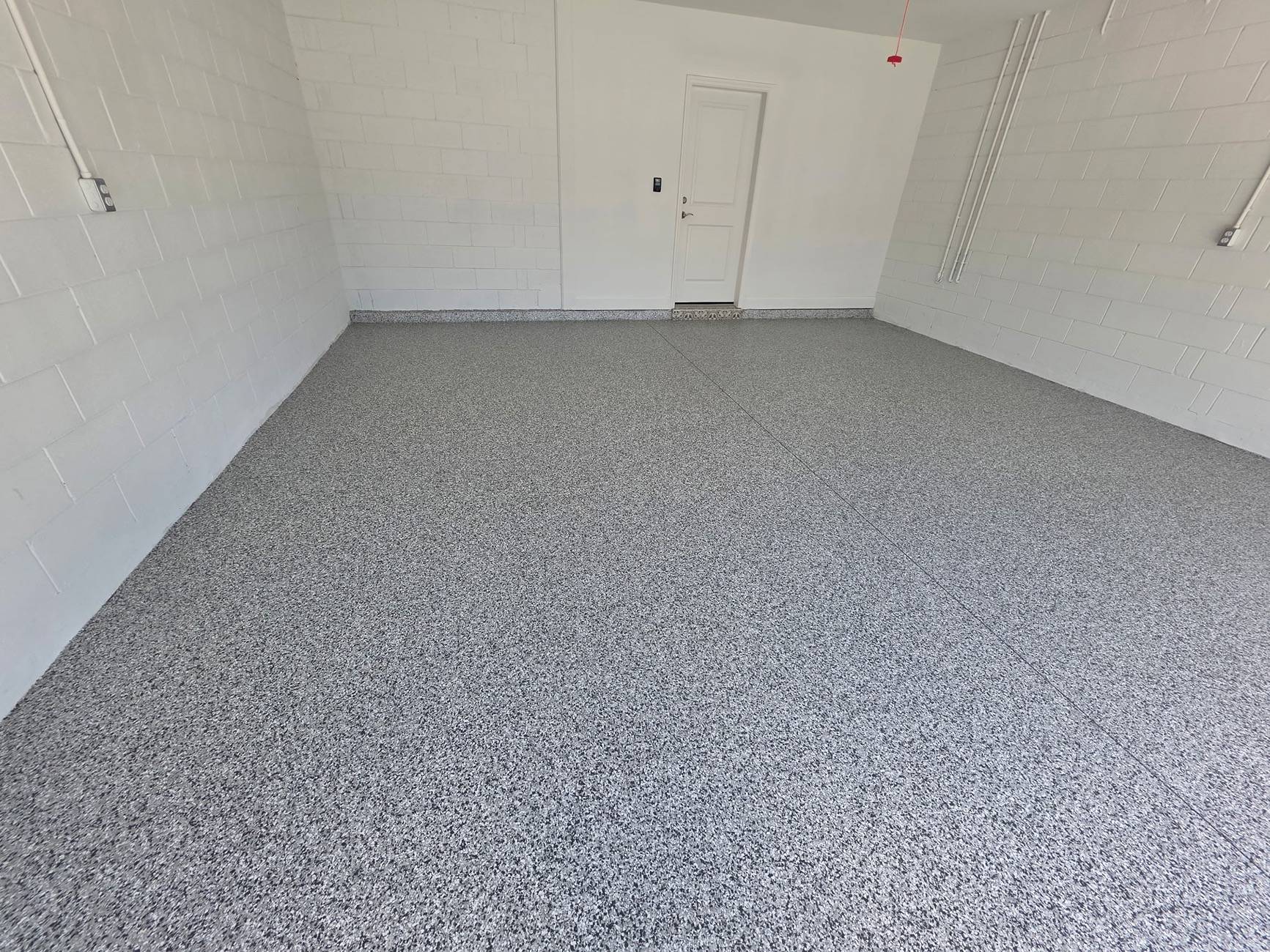

Day two of the two day process done today and will cure for a couple of days. We wanted to do it before we got there so it was all said and done. Let me know what your boys think.

Lookin good, almost looks like carpet.

It looks good. No residual on the walls which shows they exercised care in the application process. How many topcoats did they put down? How long is the warranty on it?

1 top coat, he uses a medium thickness so it's durable but has some grip with an orange peel type texture..residential lifetime warranty against peeling or chipping.

By the way I forgot to answer your previous question. He did use a diamond grinder to prep the floor before application.

By the way this came up on the community Facebook page when my wife was asking around for recommendations for the floor. People were complaining that their floors had tire marks on it and I asked him about that. This is what he told me which I had no idea about.
Some car tires can stain the floor after driving when they are hot it is called plasticizing...It is a chemical used in some Z rated tires called Plasticizer it's a flex agent used in tires that may leave a brown stain after driving when the tires are hot where the car or cart is parked..

Yes, that is correct. I’ve experience this in the past. It’s best to let the tires and engine cool before parking in the garage. Not only will that help with the tire marks, it also keeps the garage cooler which is huge if youā€˜re working out there.

Looks awesome!!! I really wanna get mine done at some point.

A little more expensive than I thought it would be but I know it’s gonna be worth it when I get there. I wanted to get it done before we go out there which makes it even better when I can just pull my car in there.

Do you know what brand the product was that they used on your floor?
