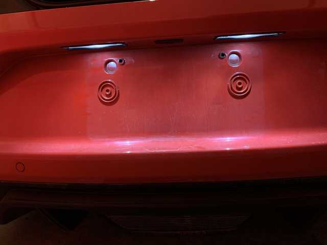

More than on way to skin a cat. Dislike the lower holes of tags & frame Looks half-ass, and yes 2 screws will hold fine.
With 4 screws, matching bolts in my case, bolts look better. With the tag on the work bench, start with lower holes.
Bolts thru the frame and plate, nuts on the backside. After nuts installed, cut bolts flush with the nut.
Ran a tap 1/4 20 in the upper holes, hang tag, a cleaner or finished appearance .
need a picture ask
