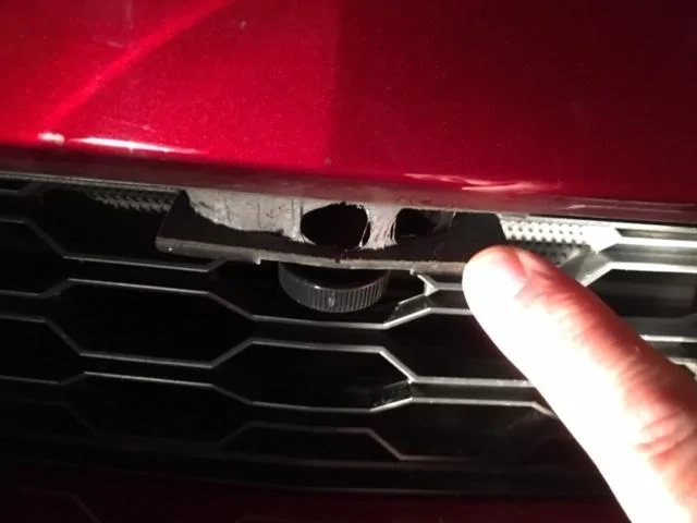

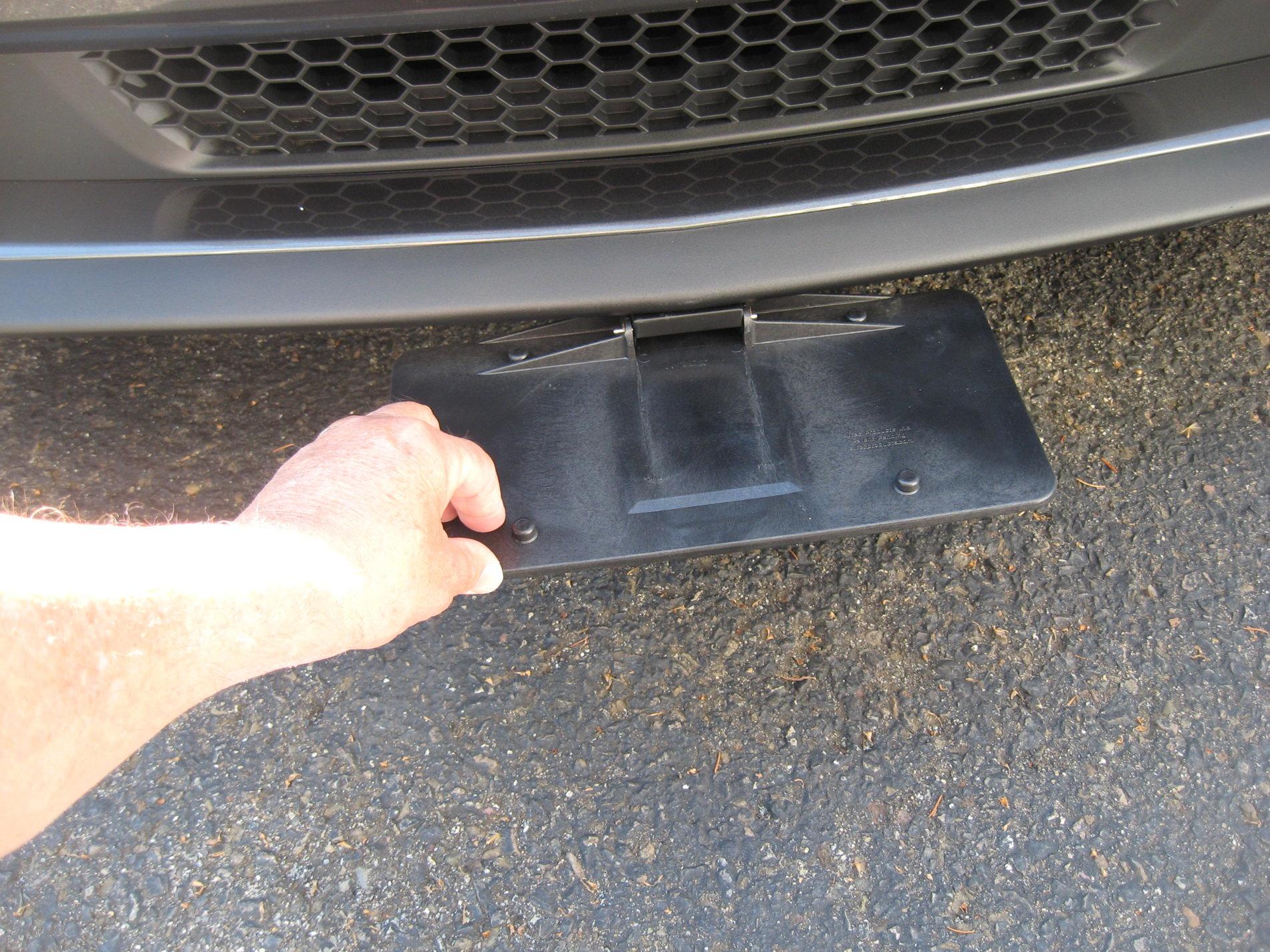

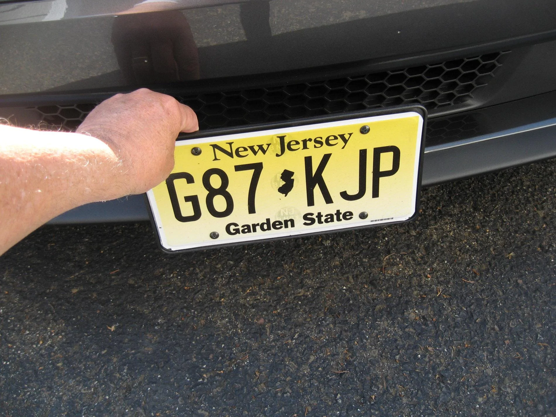

The bracket is really small but holds well. Here is a pic from my 15 EB. I was taking it off as I no longer needed it.

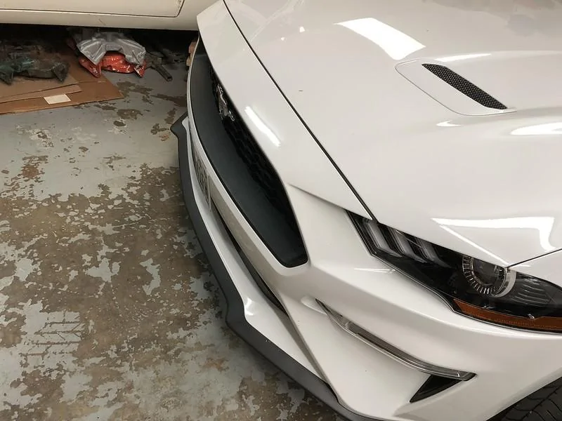

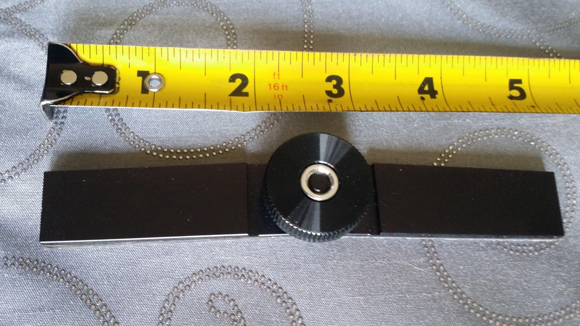

This is the bracket for a 2018-2019:

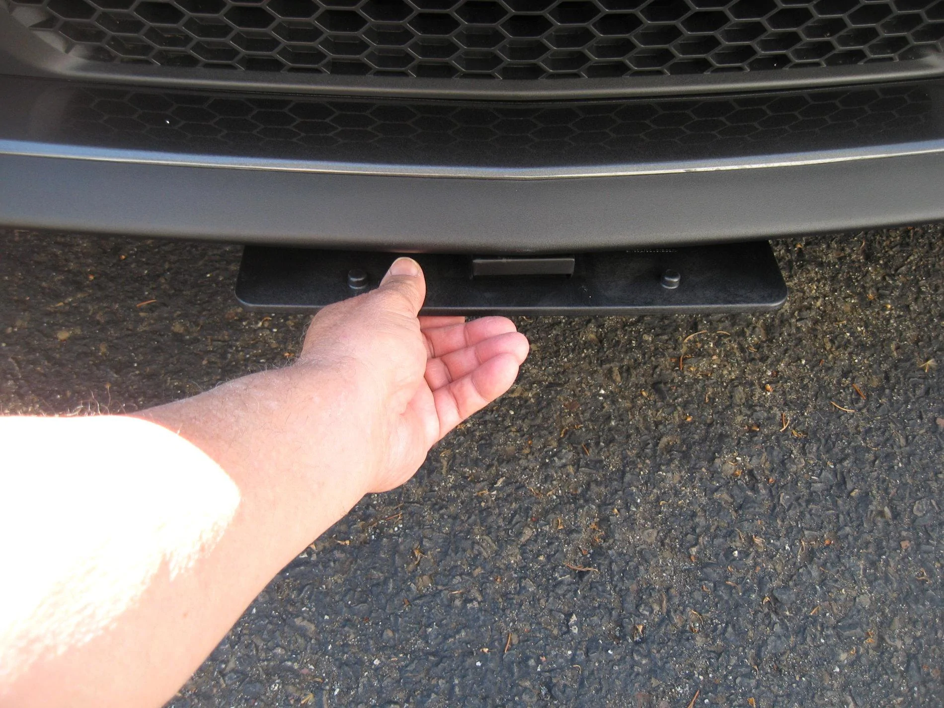

I had the same front tag on my last Mustang.

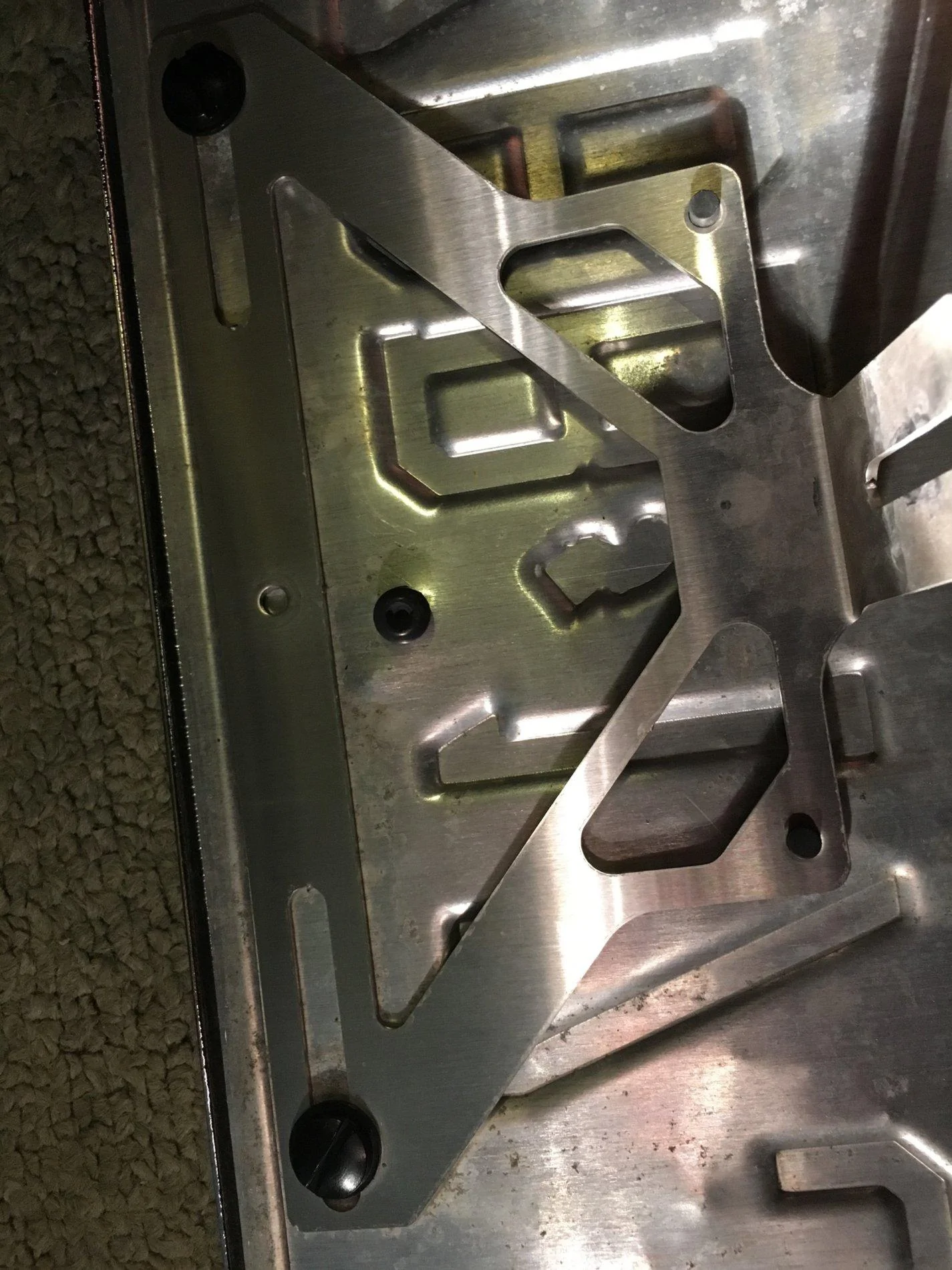

I made my own, only had to buy spacers and screws. Made a bracket from scrap aluminum.

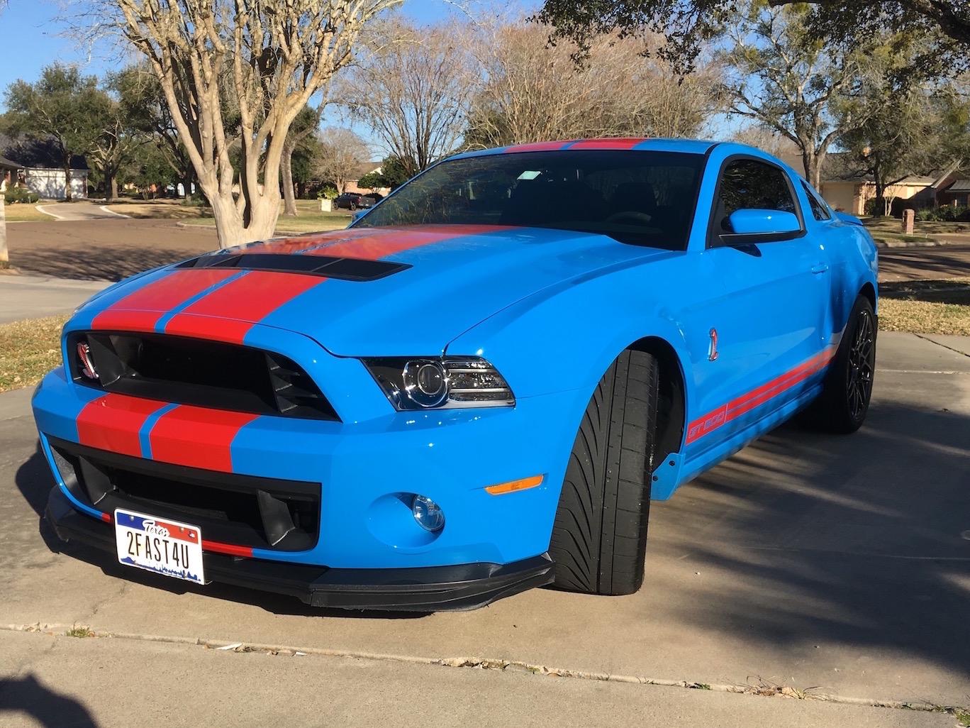

OK guys, I have a Bentley Continental Supersports and had this plate issue come up. I took the bracket that came with the car and studied it for like 3 minutes. Went in my garage and got some automotive grade 3M double stick tape, lined the back of the bracket and stuck it on my front bumper. Its that thick 3M tape and I dare anyone to try to pull that bracket off my bumper without a heat gun! But when the time comes, whip out the heat gun and WALA no holes and a pristine bumper! Don't underestimate the hold of that automotive grade tape. Also when I get my 2020 GT500 I am going to install a plate just like the one on my profile pic. Uses the existing bolt holes under the front splitter . Anybody that drills holes in the "blacked" out mid bumper to install their plate should have their head examined!

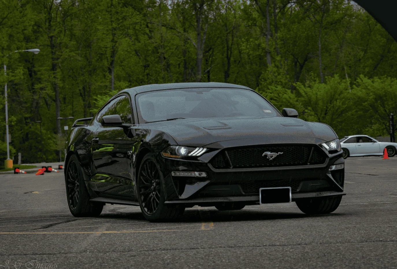

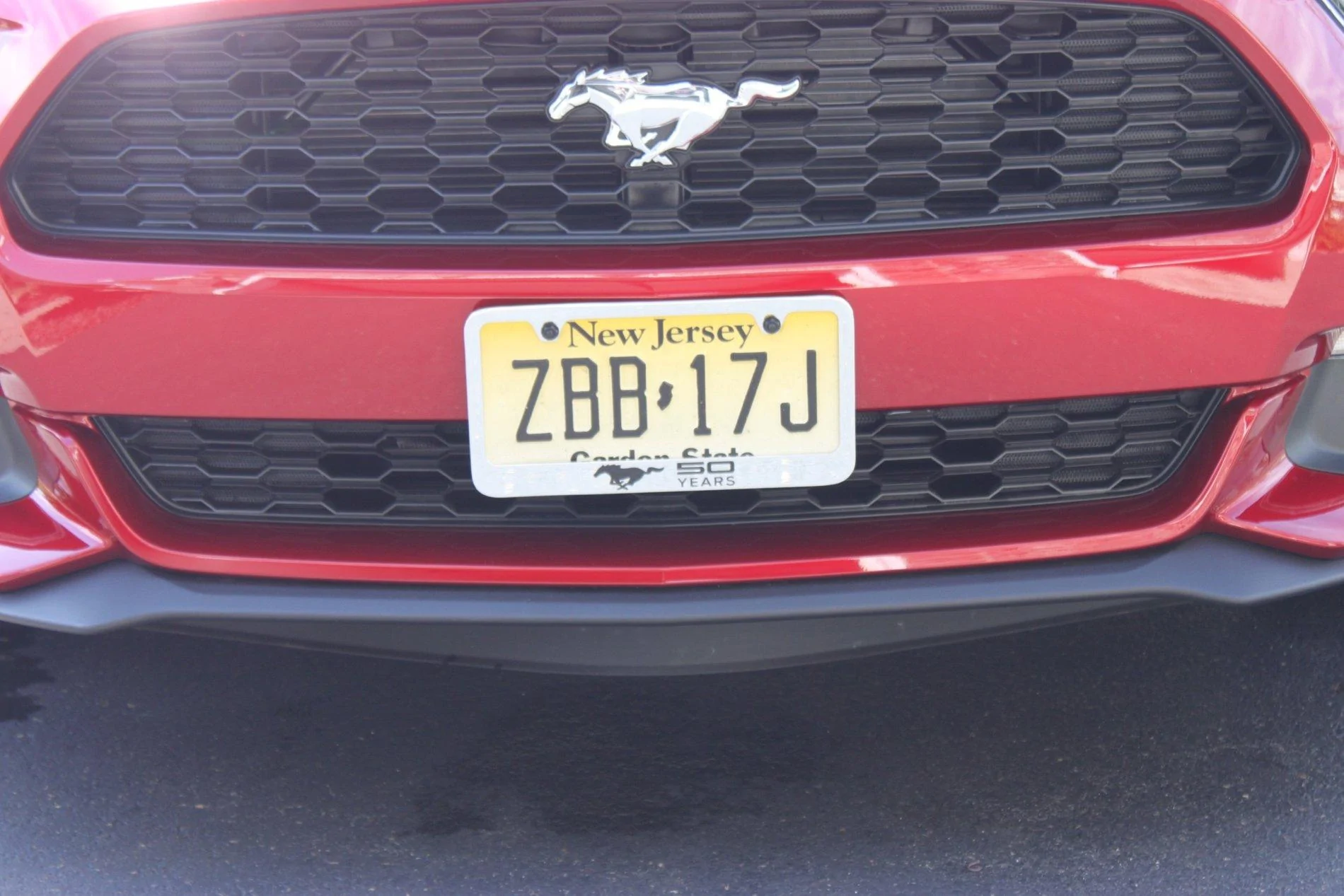

+1 for 3M tape - this photo was taken a year and 9 days ago, still holding strong and looks great. Probably been through a couple dozen car washes as well:
Mustang_License-12 by clair_davis, on Flickr
