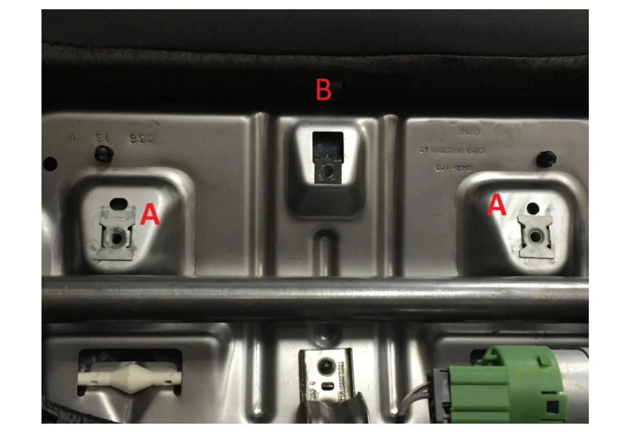

Sure can. Uses existing holes in the seat frame. Easiest to remove the seat bolts and tilt it back still in the car. Pretty solid mount. The seat bracket itself is wrinkle finish steel. The extinguisher mount is well machined and quick release with one hand. Bought the extinguishers from Summit Racing.
Where did you get the 3 clip nuts for under the seat?
Our GT350’s have the holes but the clip nuts aren’t there. How did you get the BK R-2160 Seat Mount to screw in?
Yes that looks correct. I used all the hardware that came with the BK bracket. Did you put those clips in the holes A & B? Those are threaded inserts I believe. I took the clips out and put in the supplied clips. The screw/bolt for B was difficult to line up and it's pretty small so I used a magnetic socket.

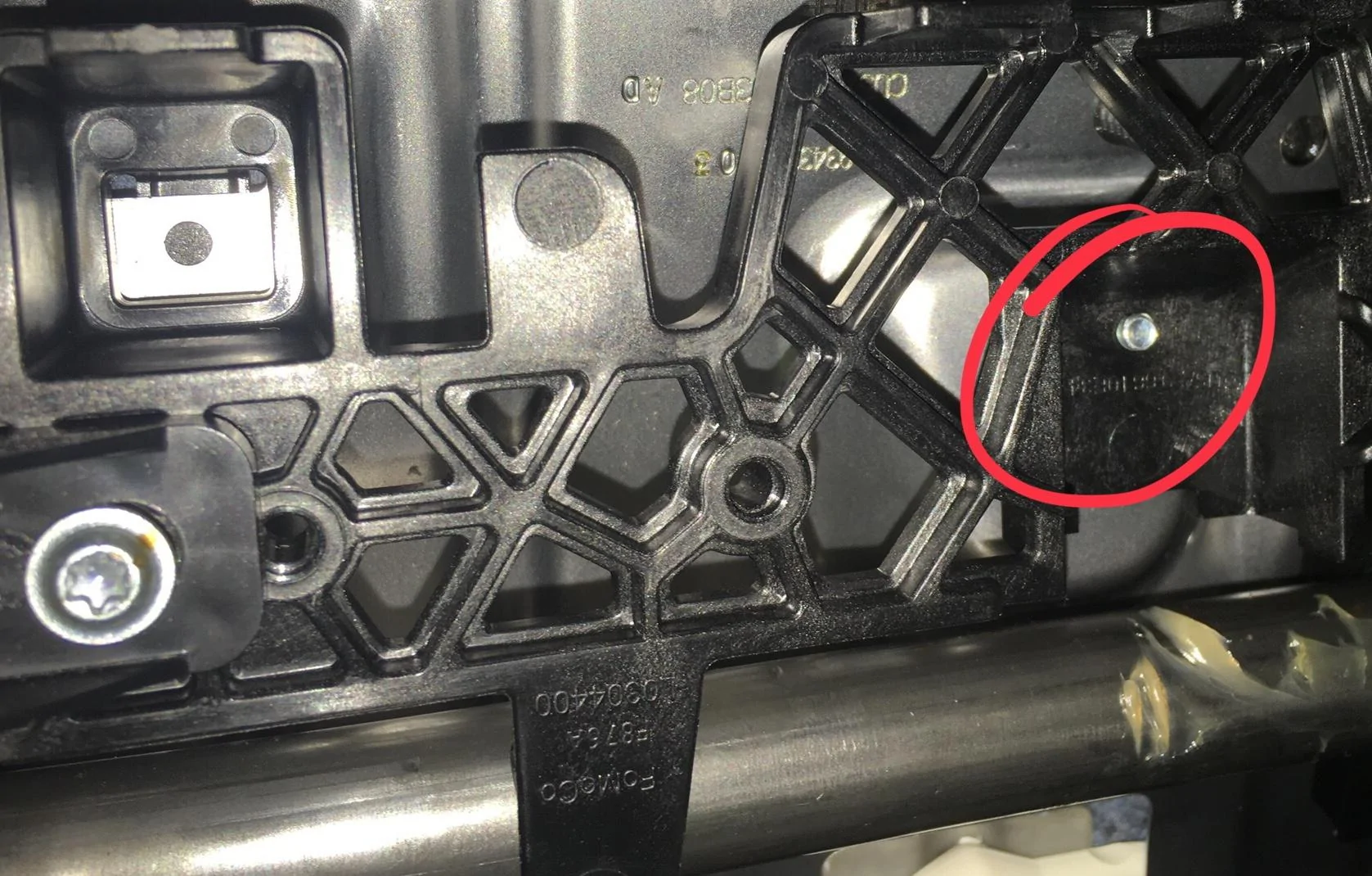

Hey bud. So I have my entire passenger seat out of my car. How do you remove these screws that hold on the plastic piece?
