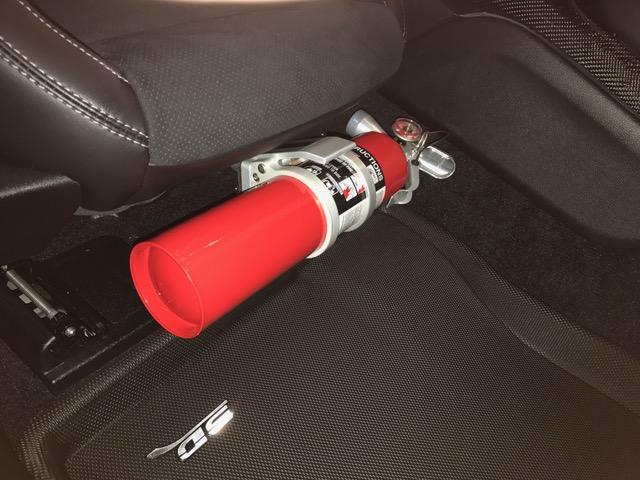

I used the bracket and quick release mount from Brey Krause. Bolts to bottom of seat on either side and moves with the seat. Well built and pricey but worth it.
Could you show some more pictures of how it mounts underneath? thanks

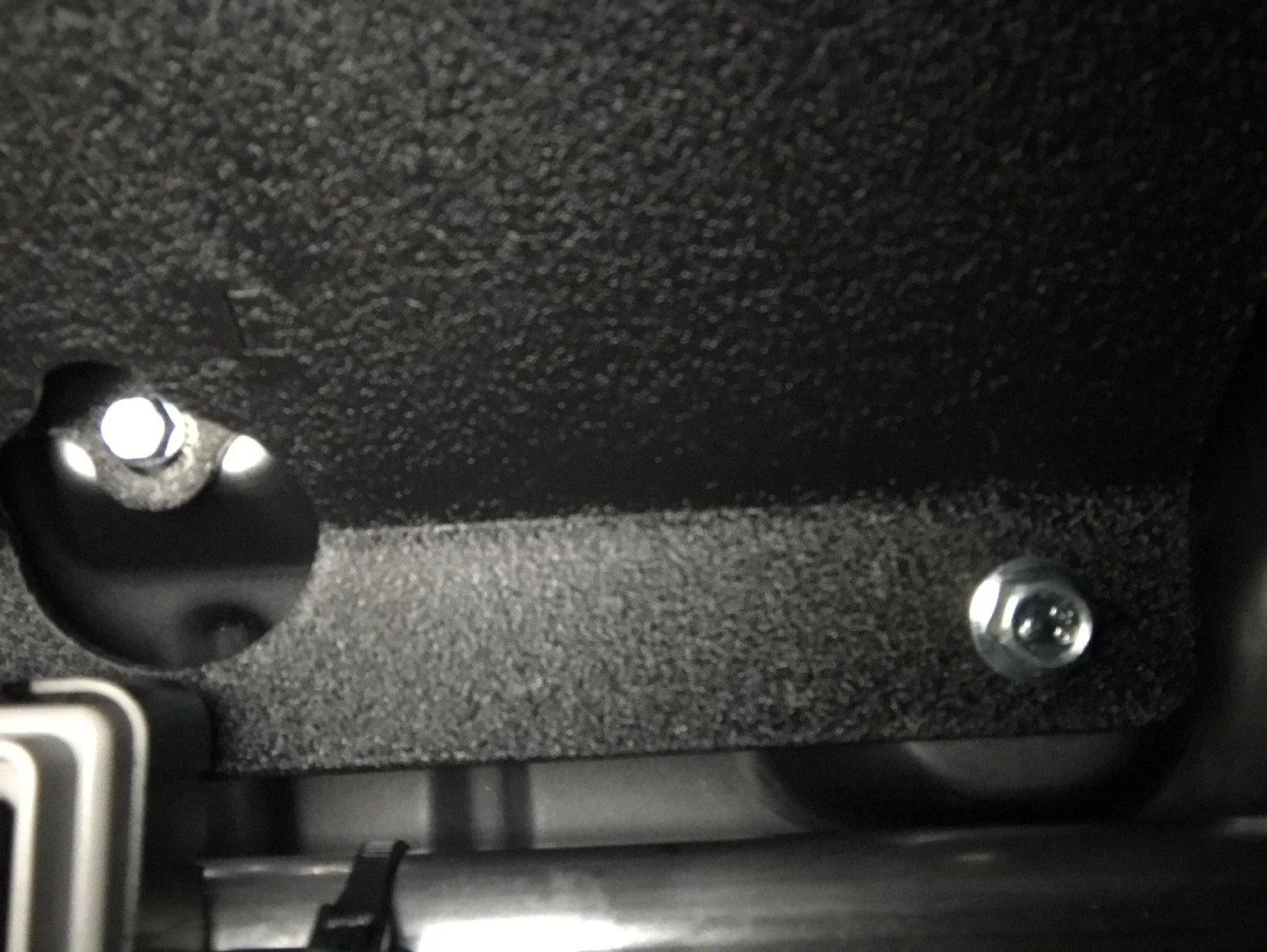

Here's a pic of it installed under the front two bolts of the passenger seat....

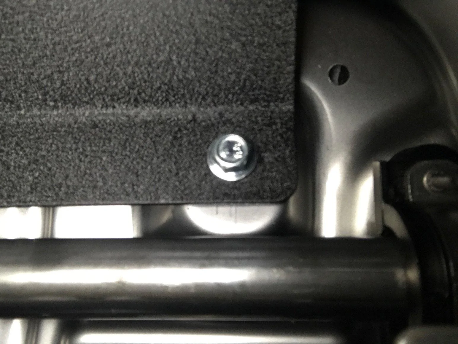

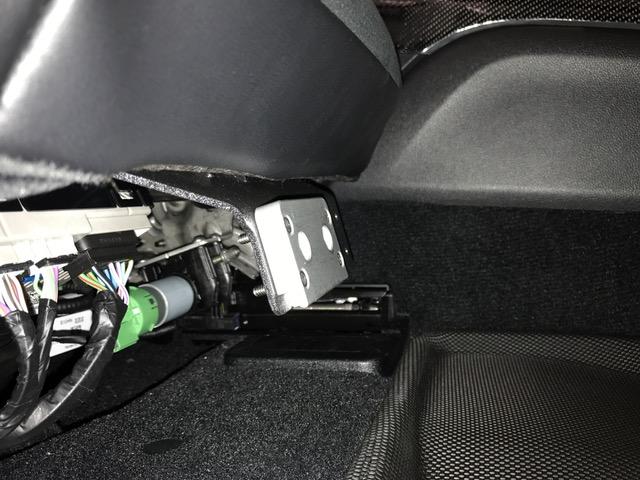

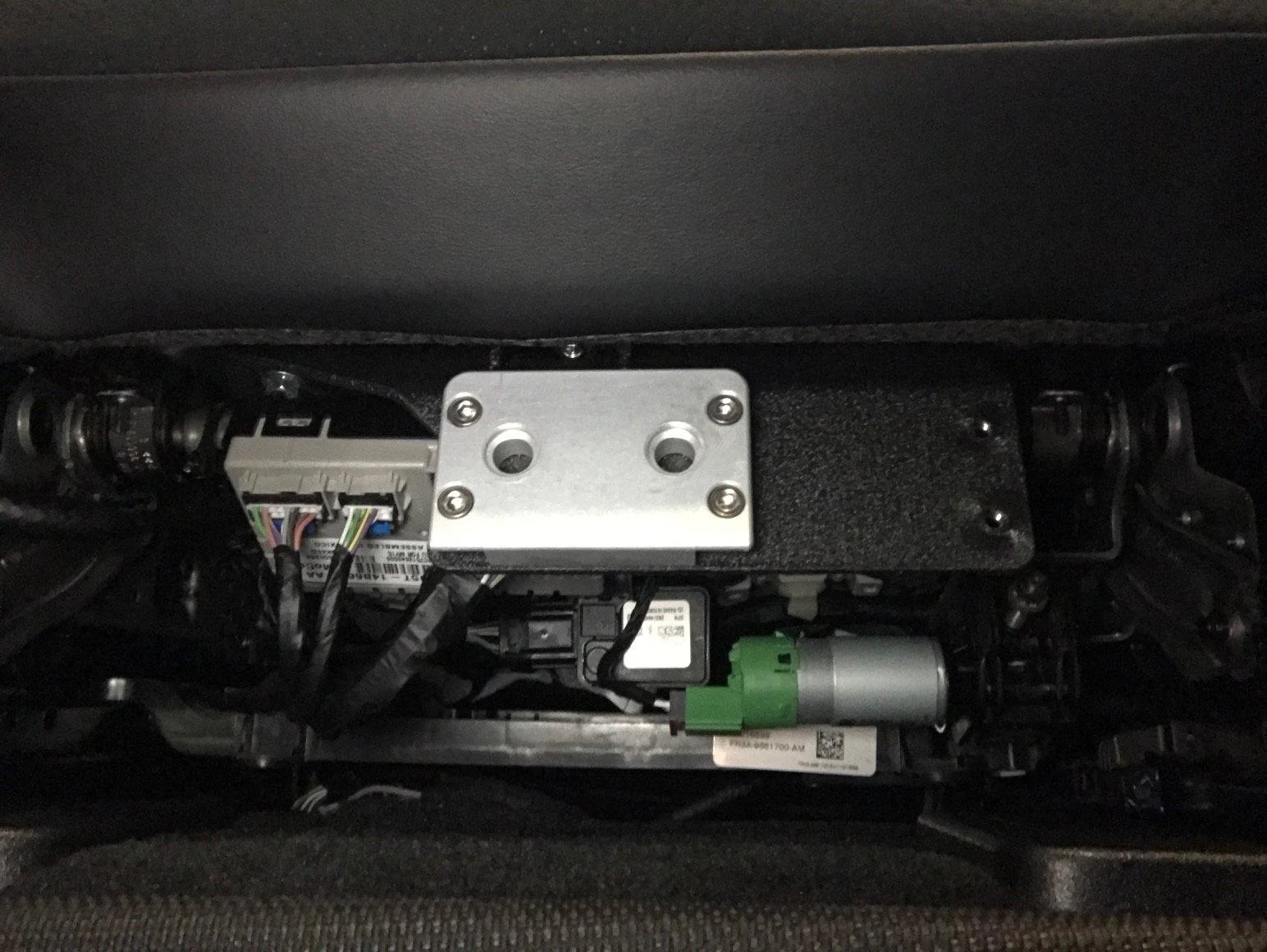

Sure can. Uses existing holes in the seat frame. Easiest to remove the seat bolts and tilt it back still in the car. Pretty solid mount. The seat bracket itself is wrinkle finish steel. The extinguisher mount is well machined and quick release with one hand. Bought the extinguishers from Summit Racing.

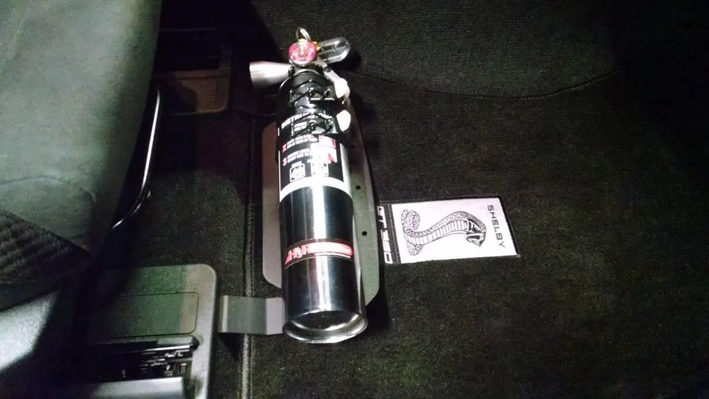

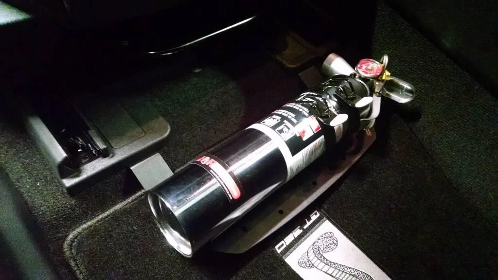

Sorry for the bad photo and dirty car, but here is my custom made mount. Made it out of an old street sign and bought a 3LB auto fire extinguisher from Home Depot for ~$30. I'll try to get some better and cleaner pictures soon.
Here are the measurements if anyone wants to make one.

Heated Cooled Seats?

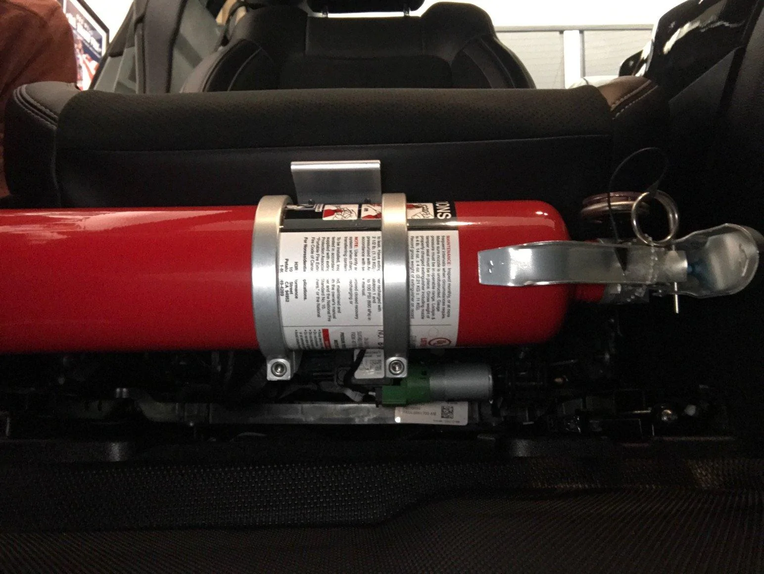

Hey bud, are those the Heated/Cooled Seats in your GT350?
I have this exact BK R-9520 Quick Release mount and the BK R-2160 Seat Mount and a Halon Extinguisher but couldn't figure out how to install it on my heated/cooled seats. Did you have to do any modding under your seat? Did you have to rip anything out or did it bolt right up?
Gray Area GT350
Oct 4, 2016
194
591
Minnesota
Brad
2017 GT350, 2013 Boss 302
Yes good catch. Forgot to mention that on the passenger side heated/cooled seat there is a plastic mount for some electrical hardware that uses the mounts for the BK extinguisher mount. Remove the plastic mount and electrical stuff from that mount first. Secure the electrical stuff with some cable ties elsewhere under the seat. Then mount the BK plate and your all set. The drivers seat does not have any same/similar stuff in the way so if you take a look under that seat you will see the 3 mounting points in the seat frame.
