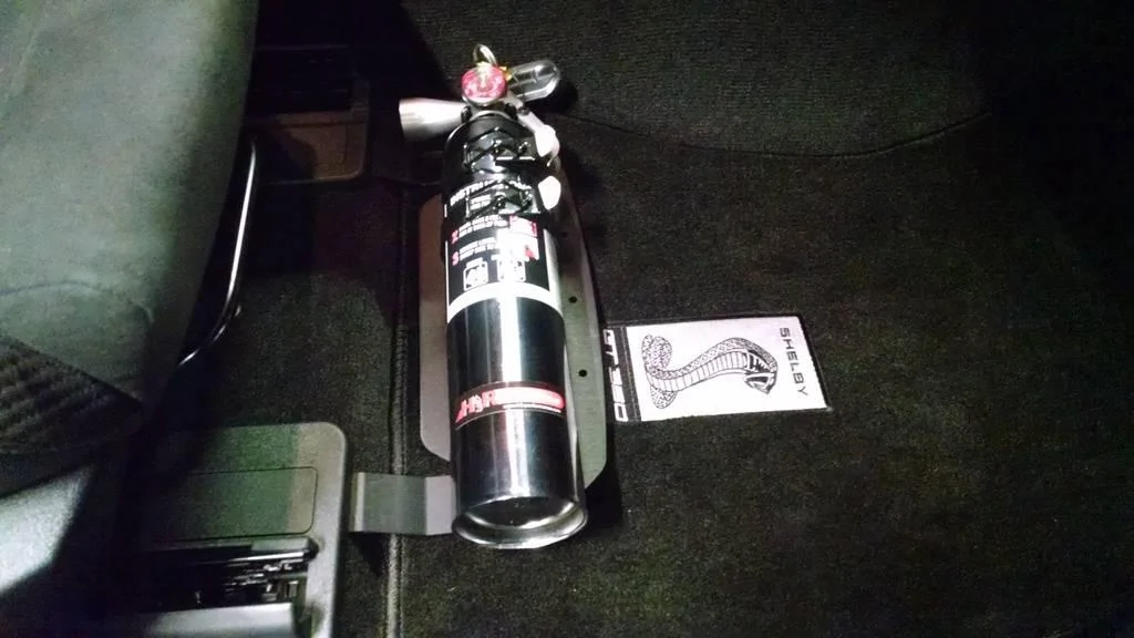

I found a pretty nice fire extinguisher mount on-line recently through a company called Speed Tactics. It's nicely made out of aluminum flat stock with a finish that compliments the interior very well. Super easy installation - just mount the extinguisher to it and then remove the two front bolts that hold one of the seats down, slide the bracket under the seat mount, and reattach the seat bolts.
The part of the bracket that slides under the seat mount bolts is slotted so you can adjust the bracket fore and aft, too.
