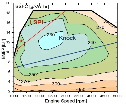

Actually that may be the problem, Up to 3000 Rpm you are in the very deadly LSPI danger zone.
The Attached file is for an Ecotec motor but the ecoboost engine is similar enough that it shouldn't be significantly different.
if all you do is lug your motor at <3k rpm all day your probability of LSPI Is significantly increased.
