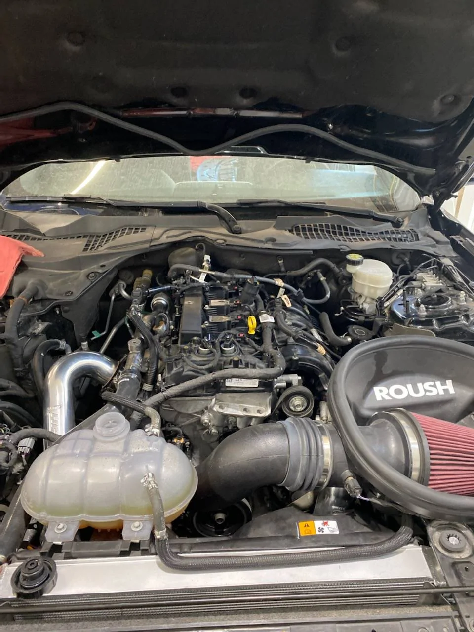

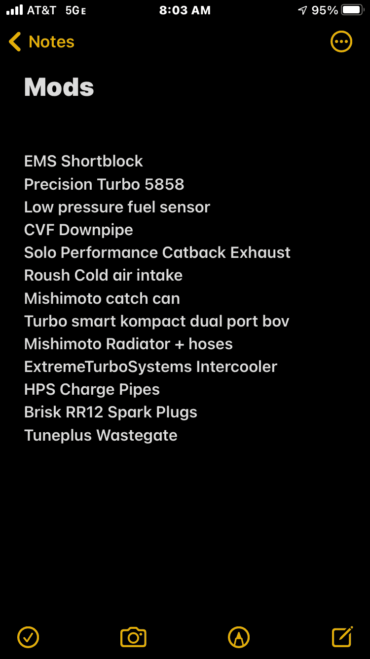

That's a nice setup!! Jessie at EMS should be able to hook you up with his Turner, for a good 400 horsepower E30 tune! You're way ahead of me.
Gonna be tuning it locally. Originally was being tuned by pdtuning when I went ecoboom and I have a good shop around here to tune it for me. I would go e30 but don’t want to worry about the hassle of calculating an e30 mix every fill up

You're going to be limited by the fuel pump with that setup.

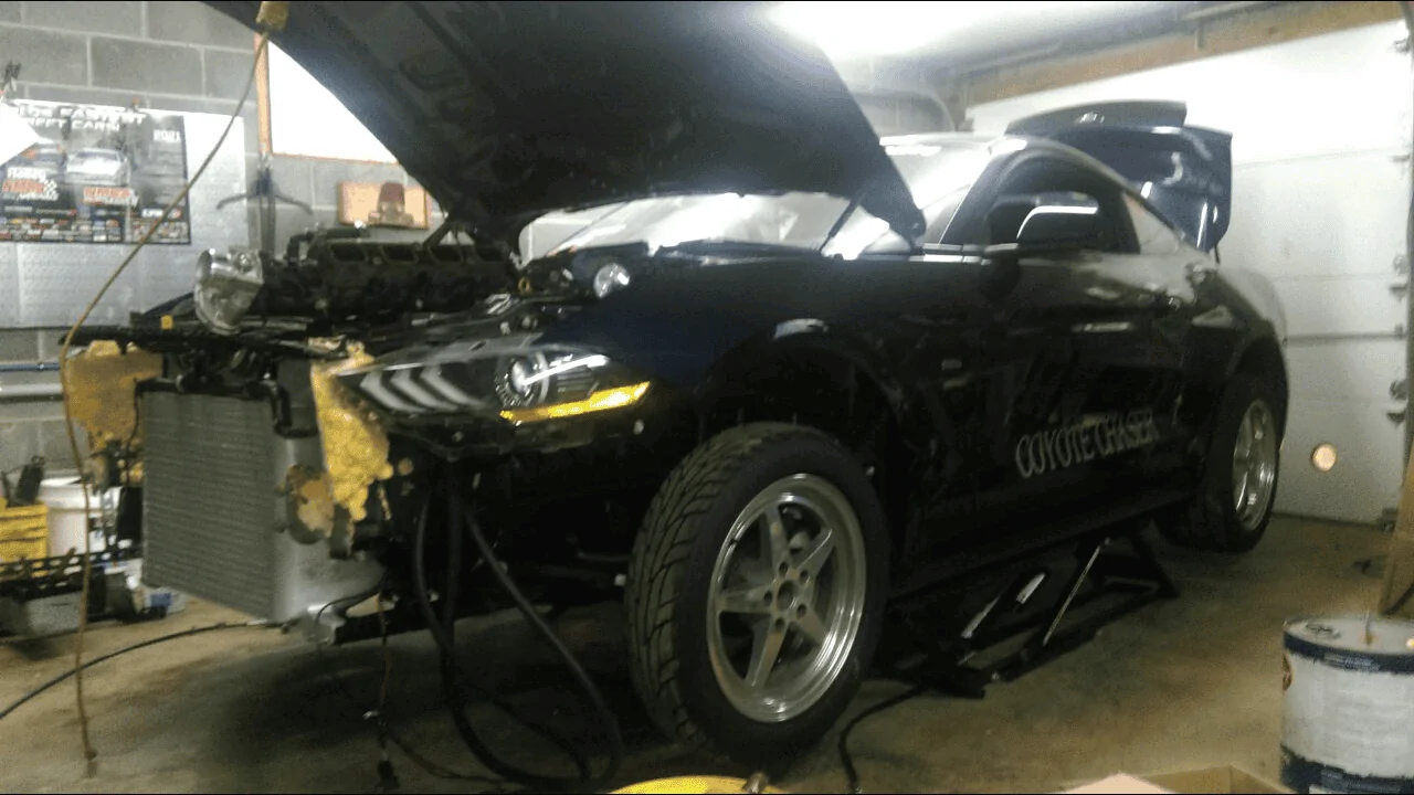

I got hold of Jessie Ringling of EMS (engineering motorsports solutions) and purchased a new intercooler from him.
I also ordered an E85 kit from him!
