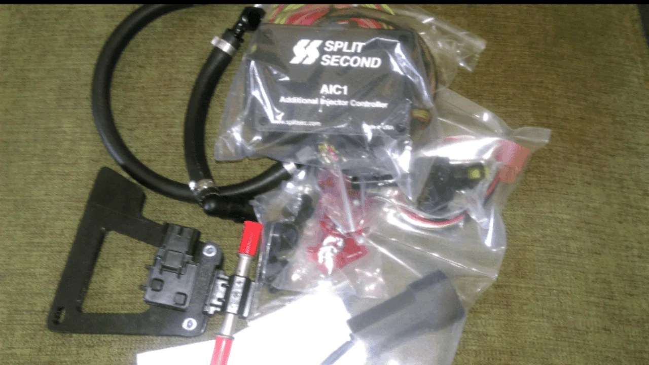

what all is in the kit for e85? hpfp and injectors?
Package #1 includes the fuel block and fuel rail plus 4 low pressure fuel injectors (no hpfp required).
Next will be the plumbing, fuel lines, fittings, non electronic controls. And finally the electronic controller itself, wiring, sensors, relays, etc.
After everything has been installed, Jessie will arrange for Ryan of PD to program my ECU to receive information and send commands to and from the additional hardware.

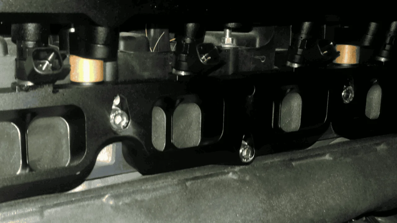

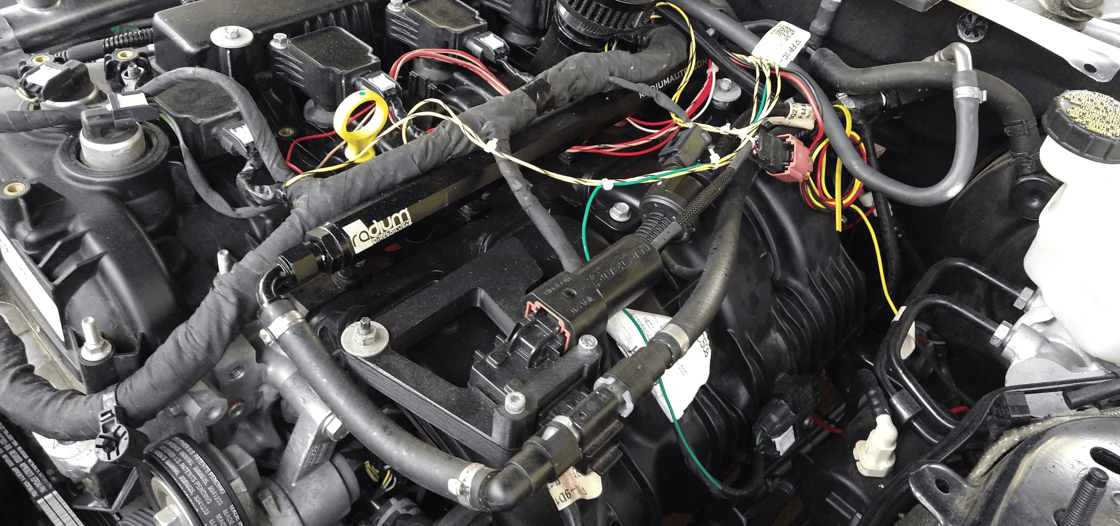

Update on the E85 kit. Everything went together really well. Very happy with the equipment quality and after sale support!

Did you install it yourself? How difficult was it? I’m looking to go this route once I get the money and trying to calculate installation fees and tuning. Also How much does it make?
I installed it myself with the help of easy to follow instructions provided by Jessie Ringley of EMS.
I was only running an OTS cobb tune, so I went ahead and purchased the complete package, which includes tuning by Ryan Martin of PD.
Once completed, I should be right at 400 HP.
Looks like it's almost done with final wire housing and tesa tape that last remaining steps. Exciting!
