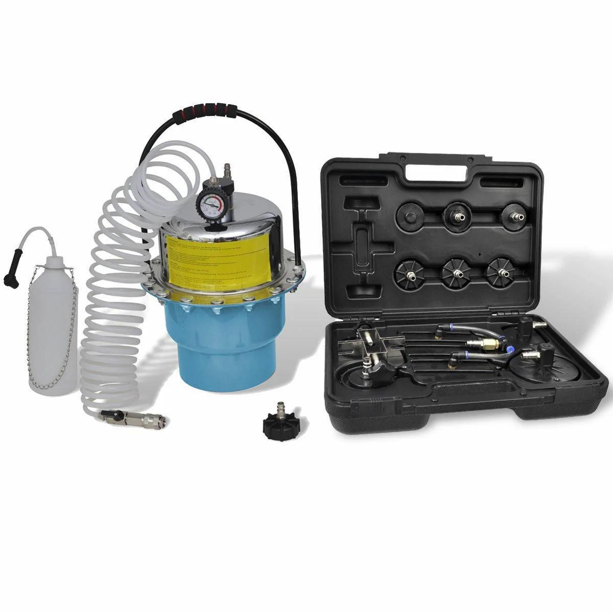

i had been using the motive bleeder for years and i recently switched to this one last year. This unit is 10x better than motive bleeder.
You can also bleed the system up to 50PSI.

And the name / model of this one is ?

I looked long and hard at pressure bleeders last year. I liked the one you have but I was concerned that it was designed for large quantities of fluid, and the most I use in a whole season is about two litres, and even then it's not all at once. How is it with small quantities?

Looks like it could drip out some ‘shine between fluid changes..
+1 on the make and model request.

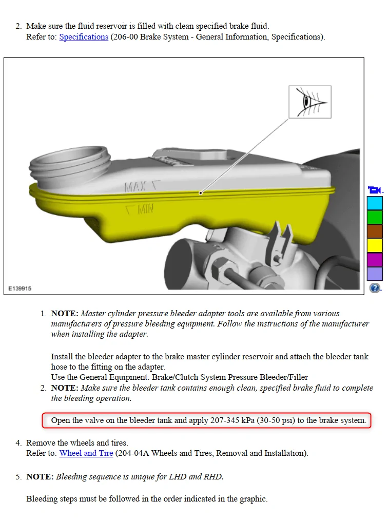

... but you shouldn't go above 15 psi or so...
I'm not saying there is a reason to do this, but the 2018 factory service manual specifies pressurizing the system with 30 to 50 psi... apparently they want the fluid to move so fast that it scrubs the brake lines clean... lol.
