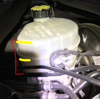

Can someone share how much needs to be drawn out? Seems like a really small reservoir. Top yellow is max, bottom yellow is minimum.

No, draw all the old fluid out of the reservoir (but still leave the standpipe covered) and then fill the reservoir and the bleeder bottle with the new fluid. This way you won't have to stop and fill the reservoir a bunch of times. The bleeder will transfer fluid to the reservoir as needed and as it is bled out of the system.

I updated the post above as I know myself and others are a bit clueless. I'm not quite sure where the standpipe may be on that reservoir. I assume it's the below the bottom part of the plastic reservoir?

Regardless of which vehicle I'm doing, I suck fluid out of the reservoir first for exactly the reasons that @Tomster mentioned. If I'm using the Sealy, I leave the level low and just hook up. The pressure bleeder takes care of refilling the reservoir. On the GT350 I top it up manually and start pumping the brake pedal.
