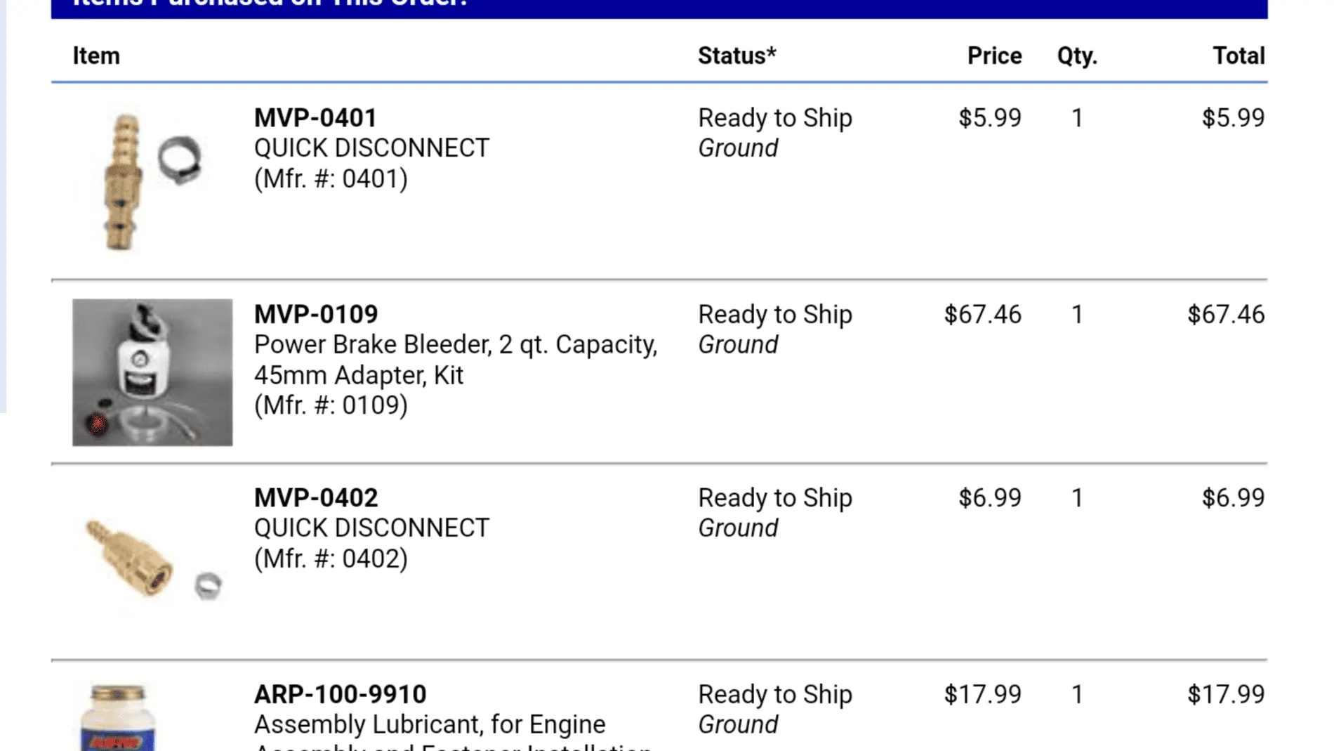

I am looking to flush my brakes for a upcoming track day. Can anybody confirm that the model I need is motive bleeder 0107? If not can someone confirm the proper product #? (2016 GT350R) The 3 prong does not fit, it looks like the screw on type.

I bought #0109 and it's worked great for me. I use mine quite a bit
Can confirm this works on my 17R as well.
It says “European model” — I bought it years ago for my ferrari and Aston Martin, and was surprised to see it work perfect on the R despite the European designation.

Edited to add MVP-0109, MVP-0401, MVP-0402

Ditto, works like a charm. Buy it.

Can confirm #0109. I used it on my GT/PP a few weeks ago. My kid knocked the power bleeder off the shelf I was using, so the pressure gauge is FUBAR and the swivel connection is bad (I replaced it with a barbed fitting). Otherwise, it worked fairly well! I need to see if this cap fits my wife's C300 AMG.

Thanks guys ordering one after work. Thanks for the information, Much appreciated

If you get the quick disconnect fittings listed above in my post, it will make your job easier. Also get some brake fluid catch bottles.

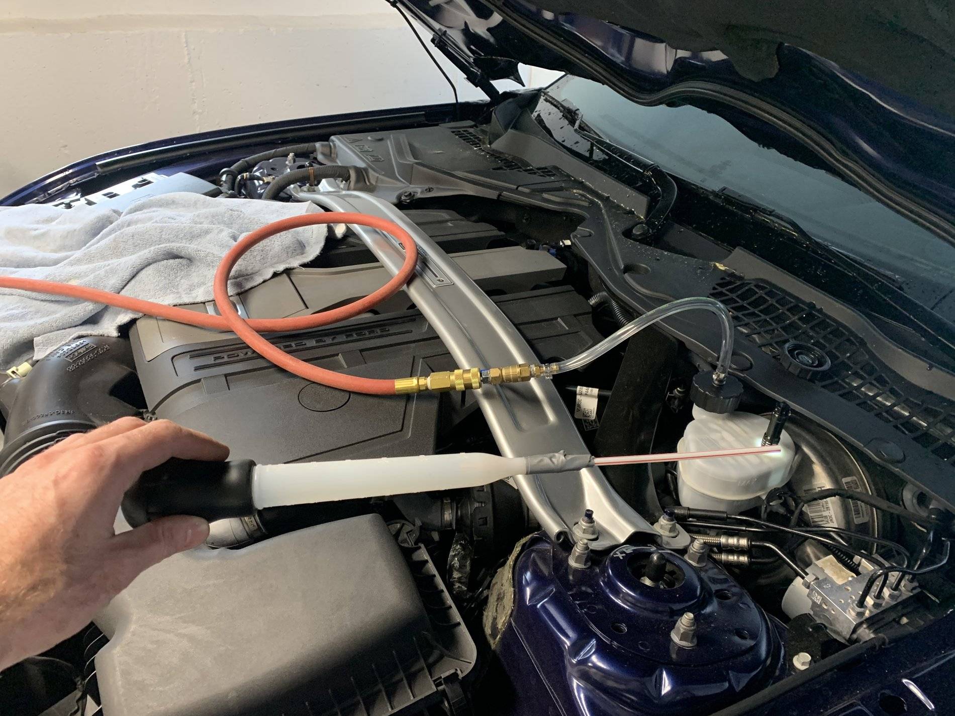

I connected the business of of the motive to my air compressor after setting the regulator to ~15 psi and attached a straw to a turkey baster to suck out the reservoir first. It makes the job so much easier to not have to pump up the motive and worry about air leaks.
I'm not sure I follow how you are adding the new brake fluid. I've done it before on my sold GT500 and I will be doing this soon on the GT350R and would like to understand how exactly you are hooking this up.
I topped off the reservoir manually with RBF600 before/ after every corner. I have a ball valve right before the motive in case that wasn’t obvious.
