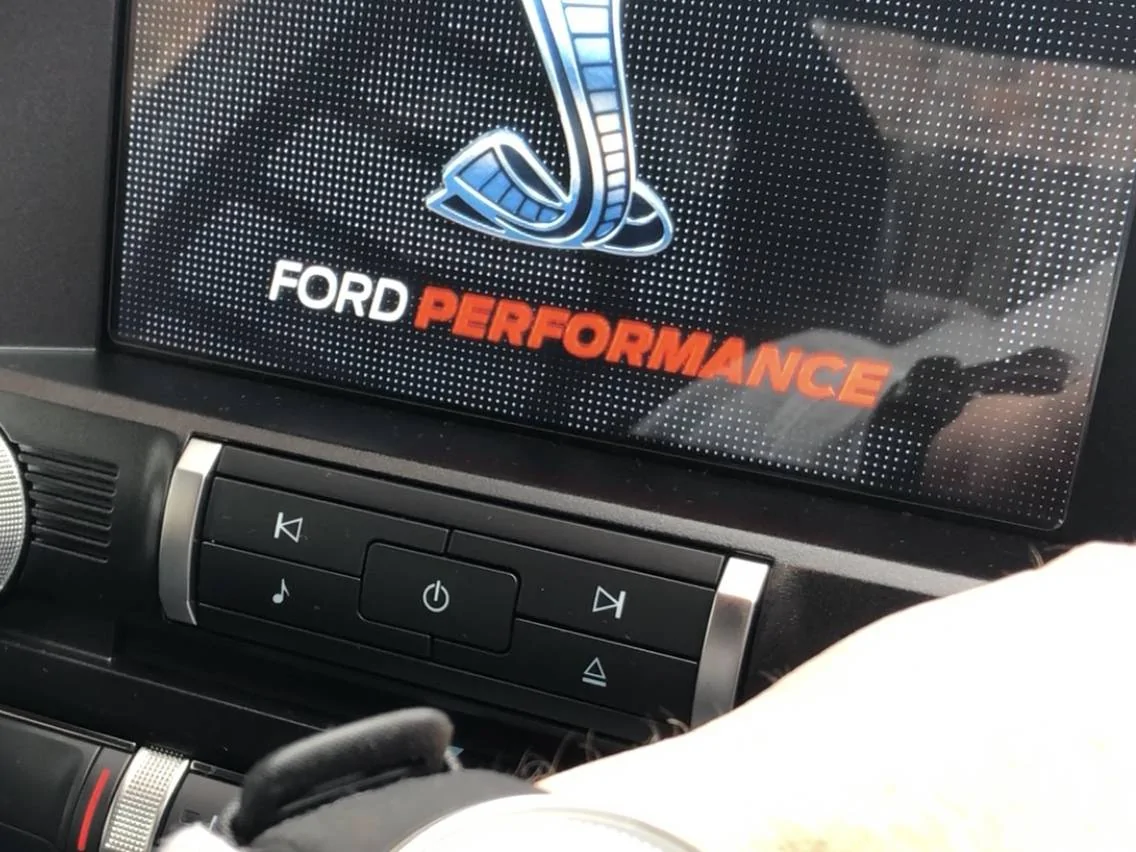

Just did a bit of forescanning.
Disabled the no key honk.
But, there is no longer the GT Ford Performance splash screen in the APIM.
In its place in position D is a generic ford oval.
I tried every number and letter in the alphabet. No joy.
So, for the Mustang there is only the Pony emblem splash screen (and GT 350)
07D0 02 01 xXxX X?xx xXxX
? Is the modifier.
WD Pro
Jan 18, 2018
132
6,816
13,662
United Kingdom
Lime GT
Have you updated something then since the 20’s were built ?
Mine has it for boot up and shutdown (screen grab from a video I did for the CarPlay2Air) :
