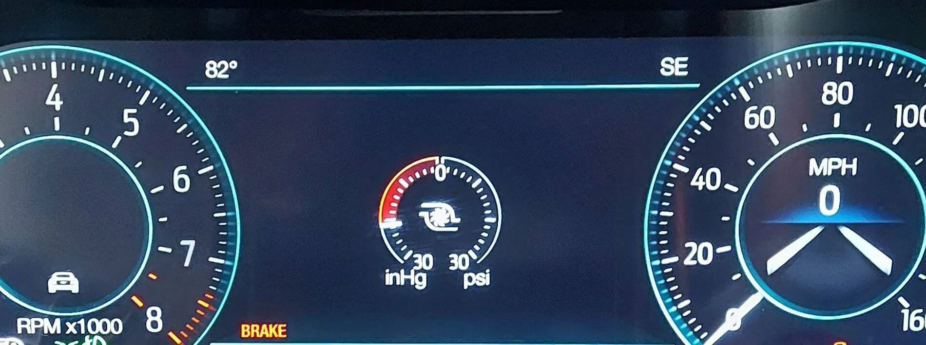

If anyone could help please . 2020 Mustang GT PP1 with digital cluster- Procharged...Got the boost gauge to come up in the cluster with FORSCAN, but it's only reading VAC stops on 0 and doesn't go into the boost side. Literally only moves in the highlighted side.

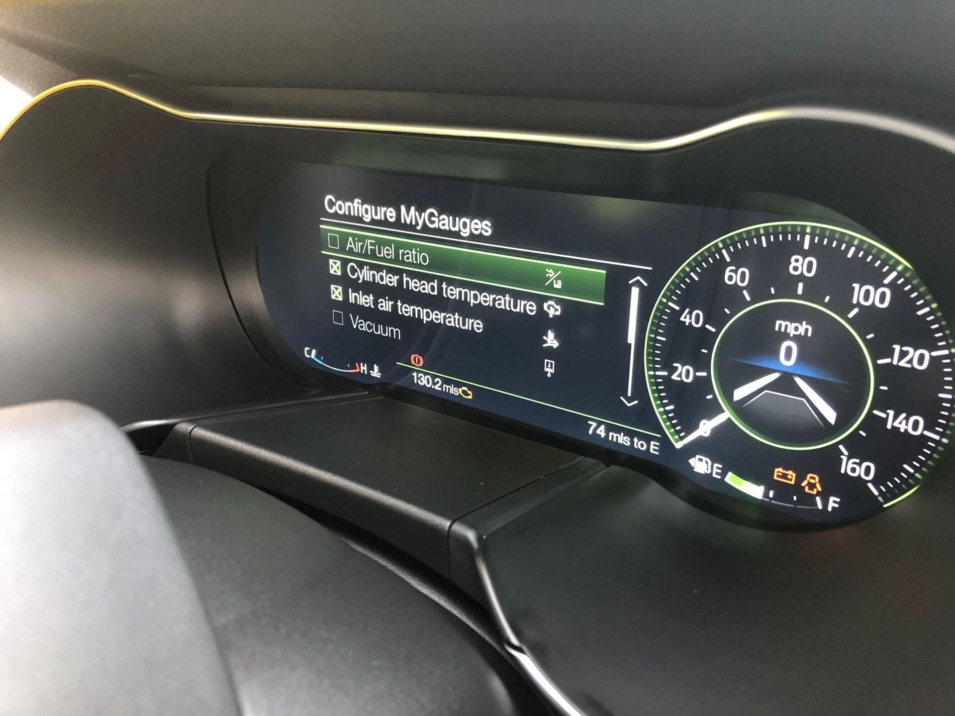

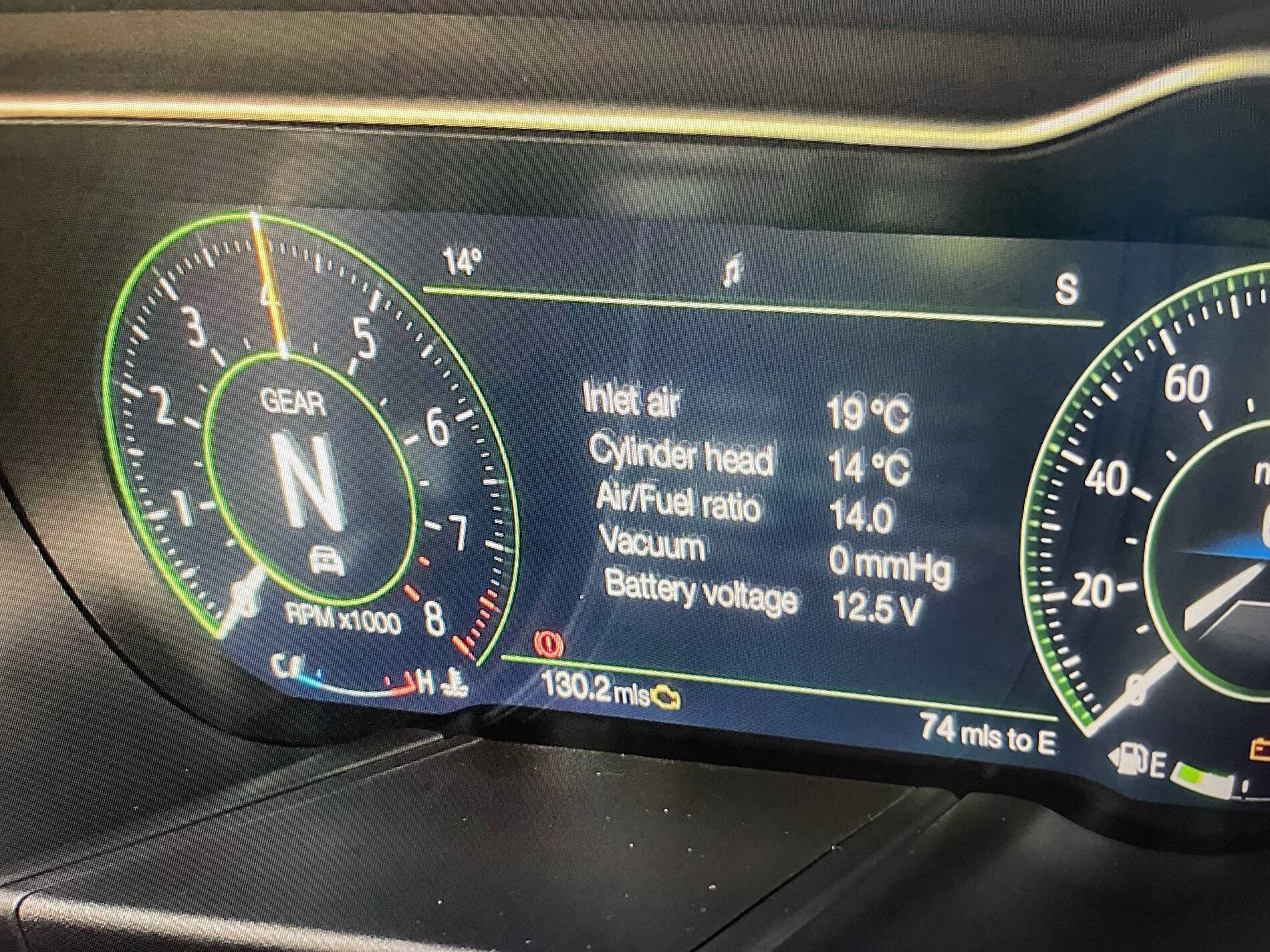

Does anyone know the values needed to add this to my digital cluster? I have a 2018 nonPP premium and want to add this gauge if possible to view the AFR the car is actually running at

Did your car come with the digital cluster? On mine I just arrow up on the steering wheel controls when I have the three little guages displayed in the center and that screen pops up.

Correct - and the gauges to be displayed can be selected from the settings, AF ratio being one of them :

yup it did coke with the digital cluster! When I select my gauges all I get are these gauge pods no matter how I scroll unfortunately

You need to go into settings and select the gauges you want from the available list (maximum of three) :like:

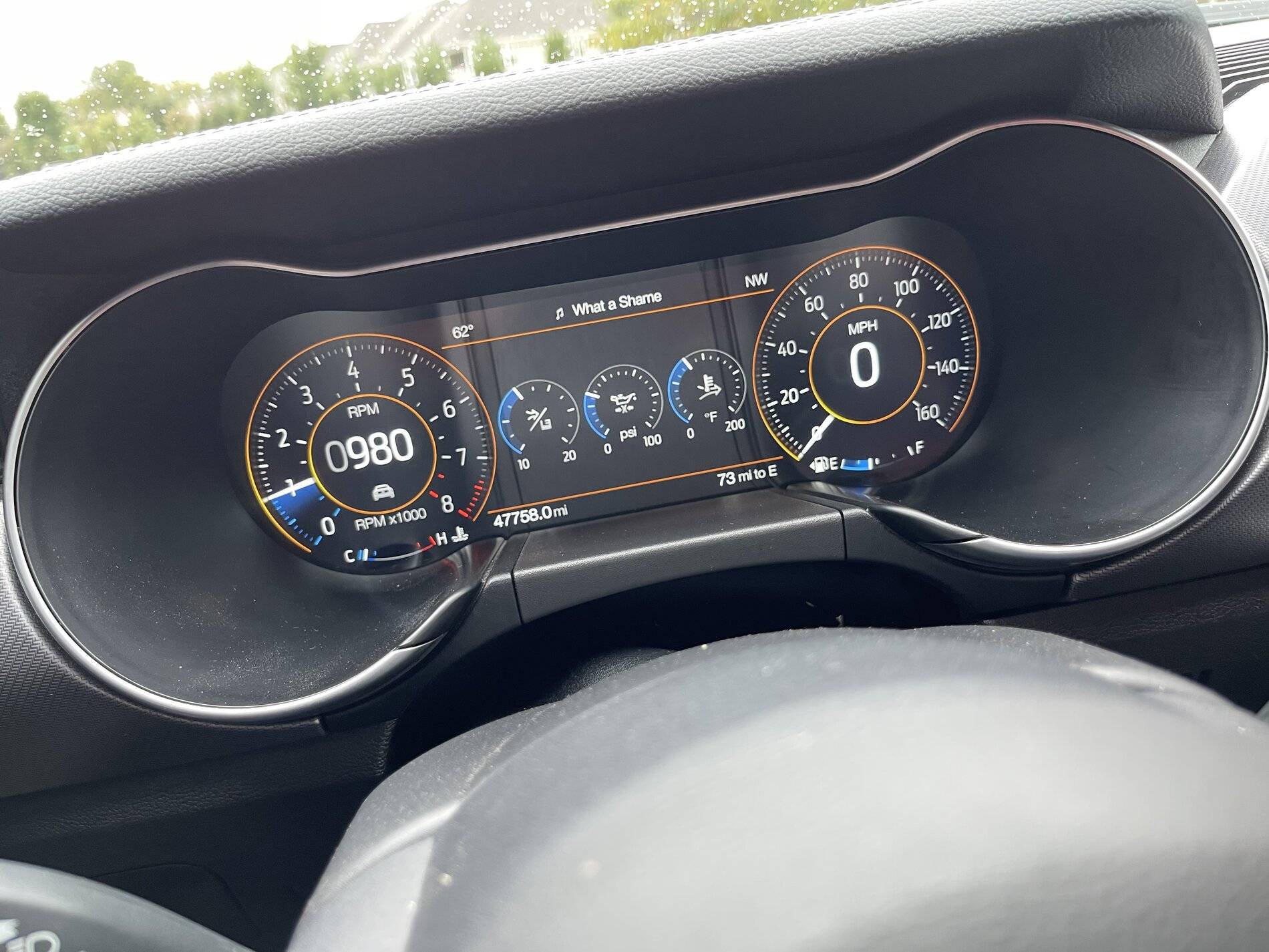

those three are the ones that I’ve set as my gauges, they appear that way as a cluster instead of as actual numeric read outs

is it even possible that there might be an asbuilt setting preventing the display of the textual key value pairs ? The arrow-down button should work displaying them if the cluster is delivered from factory.

Yeah, on my 2019 I can just press arrow down on the steering wheel when those are displayed and I get the text read out. If I arrow down again it shows telemetry.

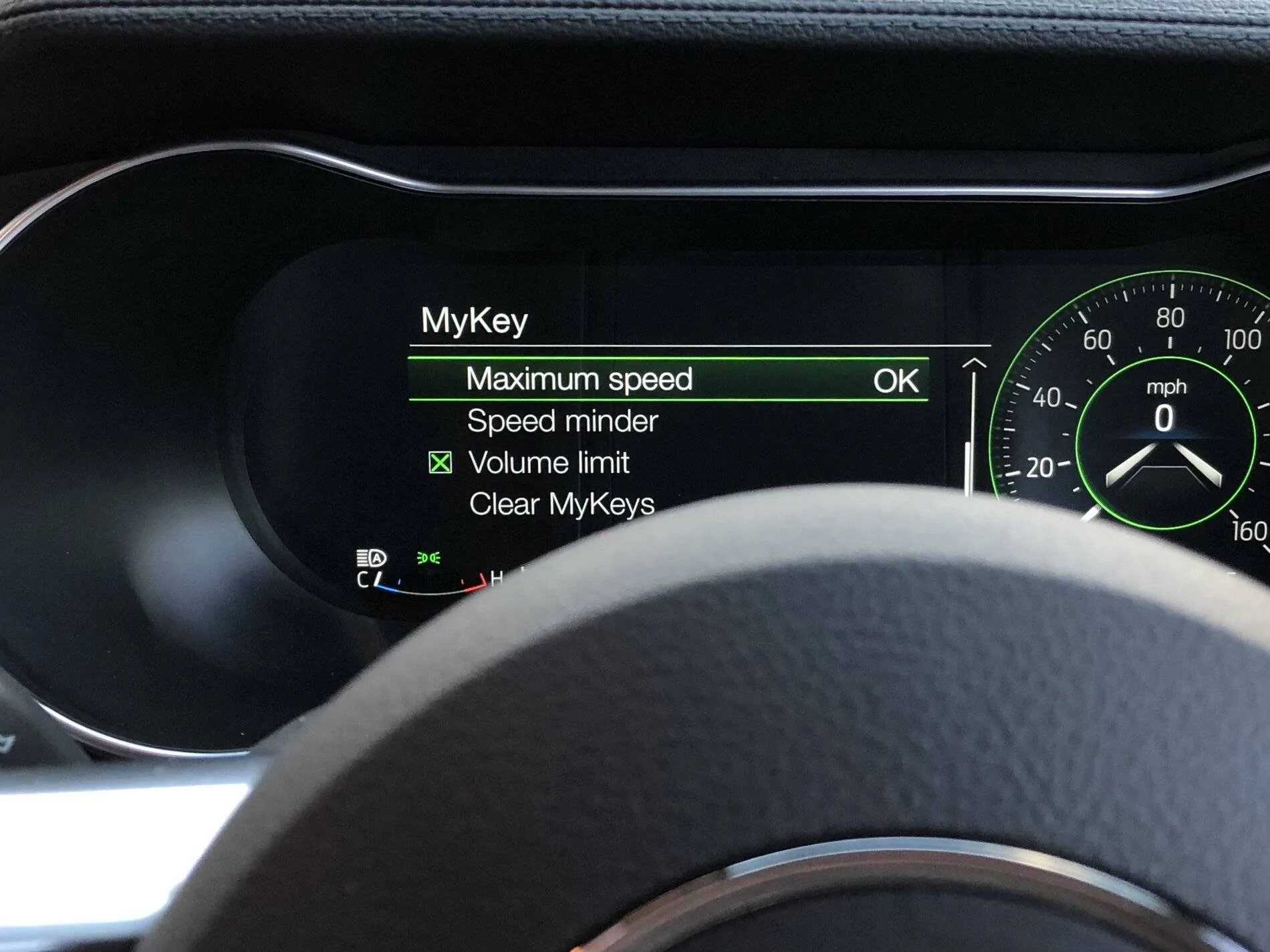

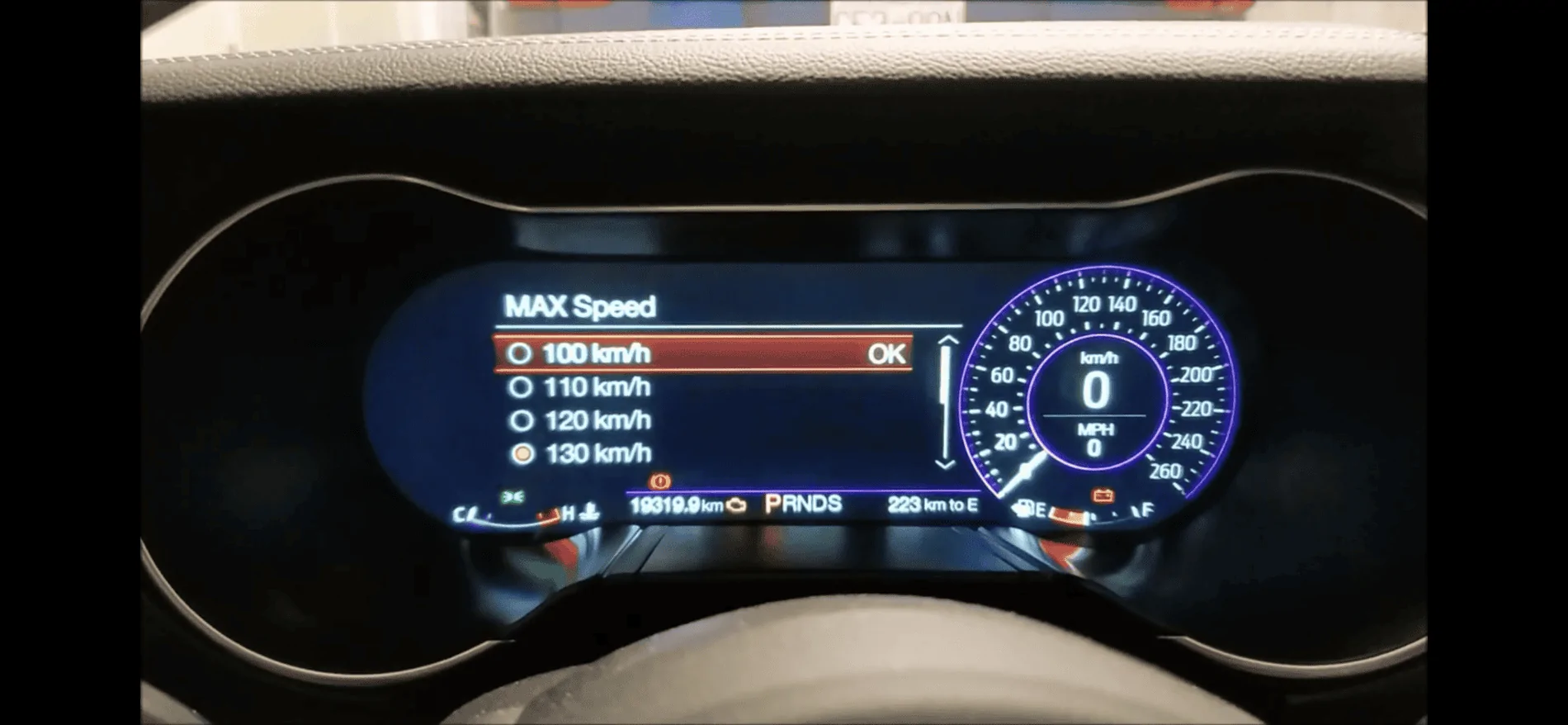

I have a 2020 RHD euro GT and I am hoping someone can help with codes related to the MyKey settings :like:

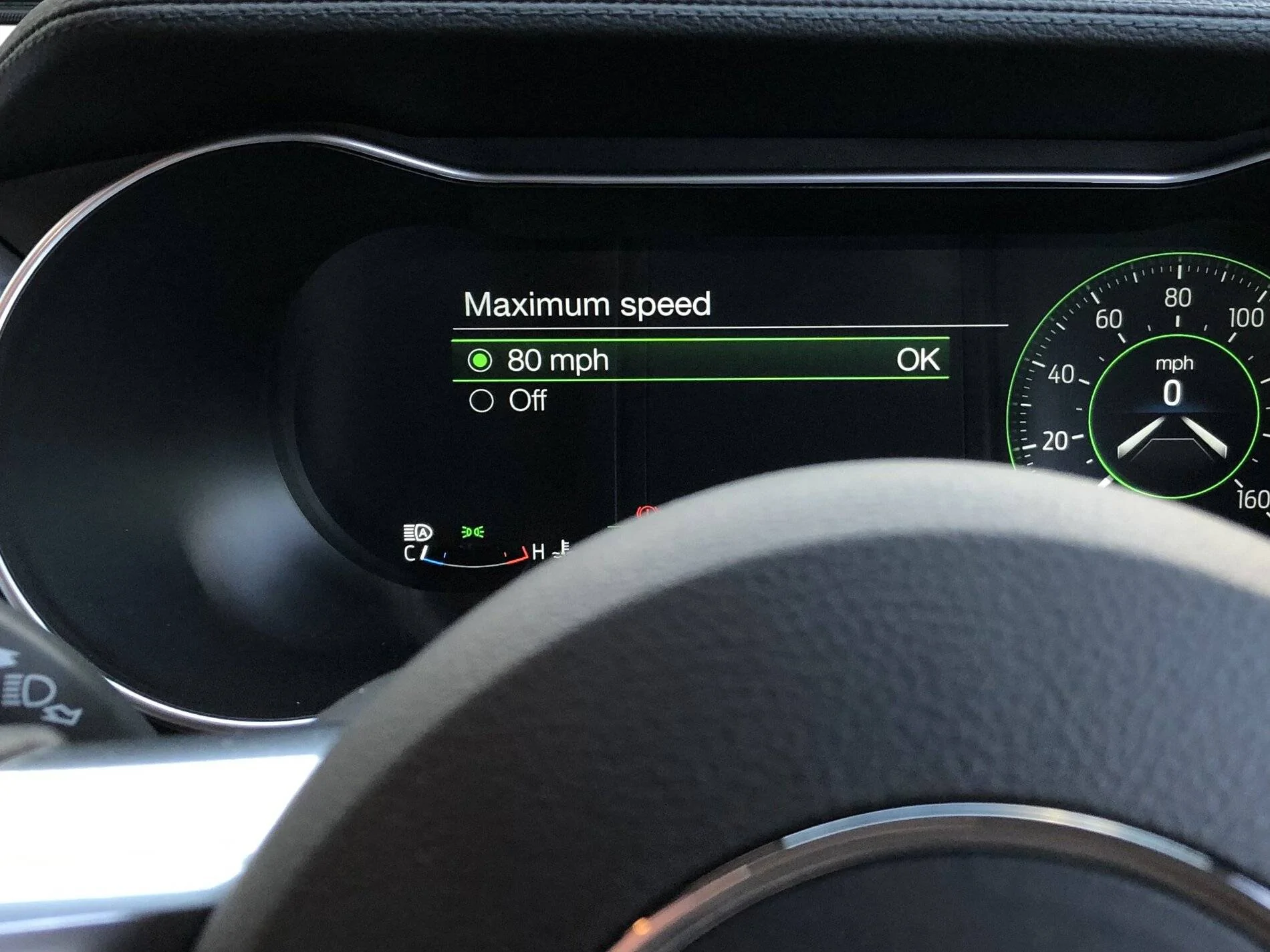

I have the speed limit option :
But it only has one speed setting which is pretty much useless :

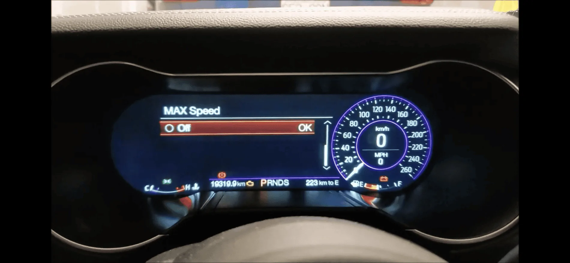

I want more options, like this guy who I pinched screenshots from one of his videos :
Is anyone aware of any FoScan codes that can help me to activate additional speed limit options ?
Thanks in advance for any responses :like:
WD :like:
Might be a UK thing? You can likely change your build code to say it's a NA car, but there is probably other hardware that will go bonkers.
