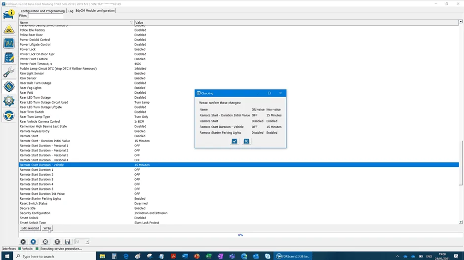

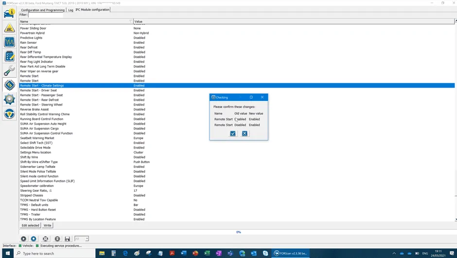

There were two control modules in FORScan where I made the changes 0 the Body Control Module and the Instrument Panel Control module:
BdyCMIPC
Remote Start Enabled
Remote Start Duration 1 15 Minutes
Remote Start Duration 2 15 Minutes
Remote Start Duration 3 15 Minutes
Remote Start Duration 4 15 Minutes
Remote Start Duration 5 15 Minutes
Remote Starter Parking lights Enabled
Remote Start Climate Settings Enabled
Remote Start Driver Seat Enabled
Remote Start Passenger Seat Enabled
Remote Start Rear Defrost Enabled
Remote Start Steering Wheel Enabled

Thanks Steve, appreciate that. Also do you have any link to buy the Remote Start module kit and installation instructions link please?

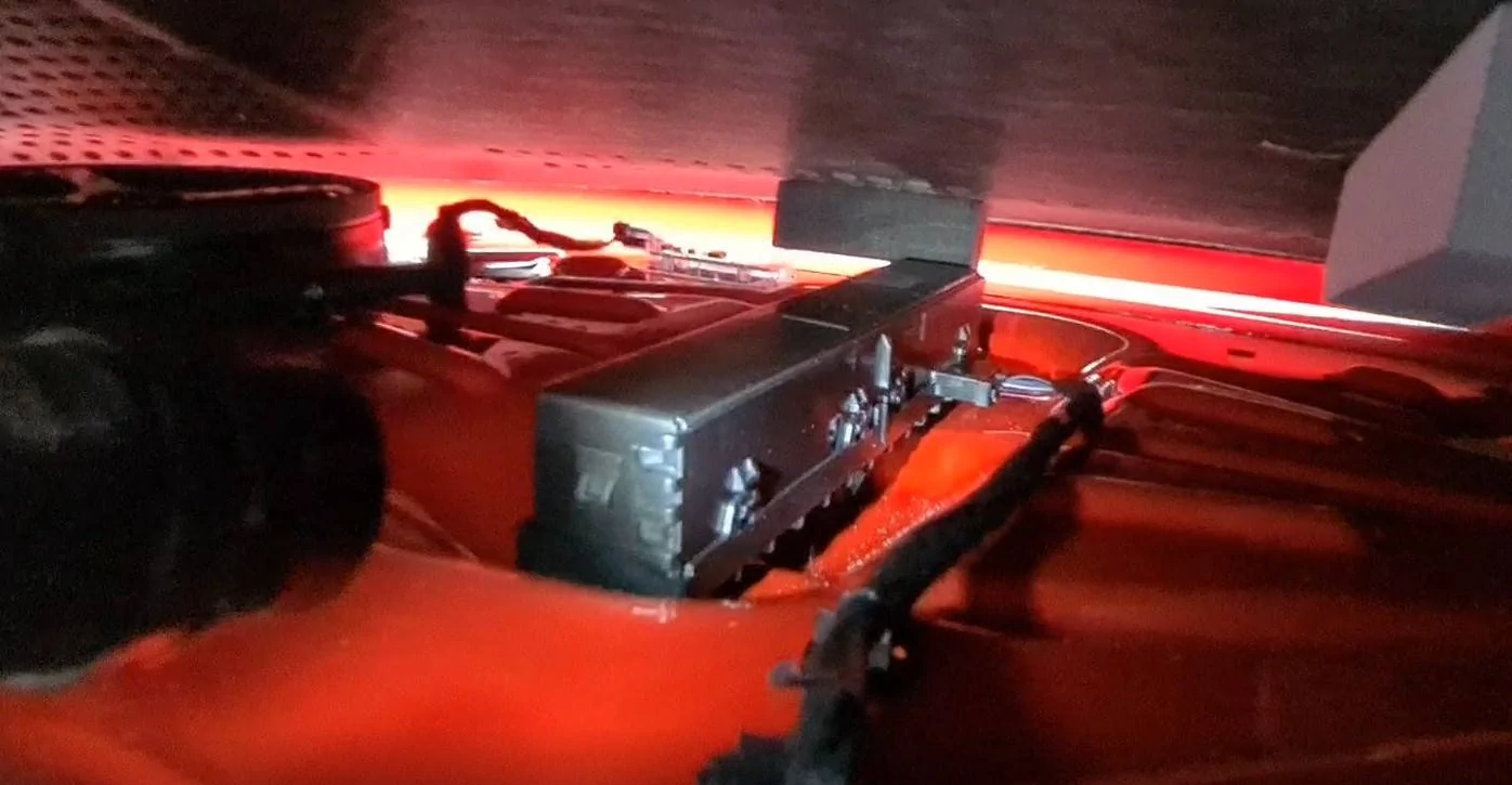

The sequence was to:
Replace the transceiver (antenna) module (under the parcel shelf in the back of the car. I got it from eBay)
Get two new keys (I got two from AliExpress - 868MHz to match the new transceiver)
Jingyuqin Remote Smart Car Key 434/868/902MHz ID49 For Ford Mondeo Mustang Fusion F 250 F 350 F 450 F 550 2017 M3N A2C93142600|Car Key| - AliExpress
Go to local Ford service centre to have the two new keys paired with the new transceiver
Use FORScan to enable features

I actually went through two transceivers - one didn't work or more like I couldn't get it to work :blush: and the other one .. well se attached for the full spec on it.
