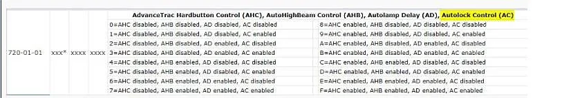

Are you able to tell me exactly what you change to enable auto locking on driveaway please?
Thanks
WD Pro
Jan 18, 2018
132
6,816
13,662
United Kingdom
Lime GT
Thanks
Here you go :
I have a better quality image of that on my work pc, just let me know if you need it :like:
Find what digit yours has in that position and then swap it for the digit with identical features but with AC enabled.
Once done you will then get a selection box in one of the digital dash menus to turn the function on or off (it defaults to off upon adding the option to your menu).
Hope that helps.

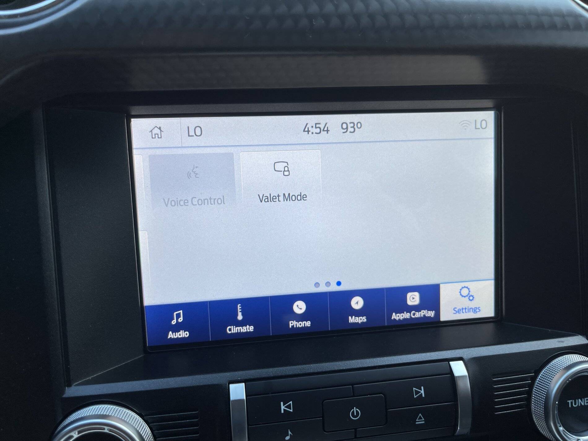

Anybody know the how to enable advance security package for the armrest to lock
Soulja4187
Apr 1, 2020
52
1,633
901
Greenacres, FL
David
2021 Mustang GT Premium & 2025 Explorer ST

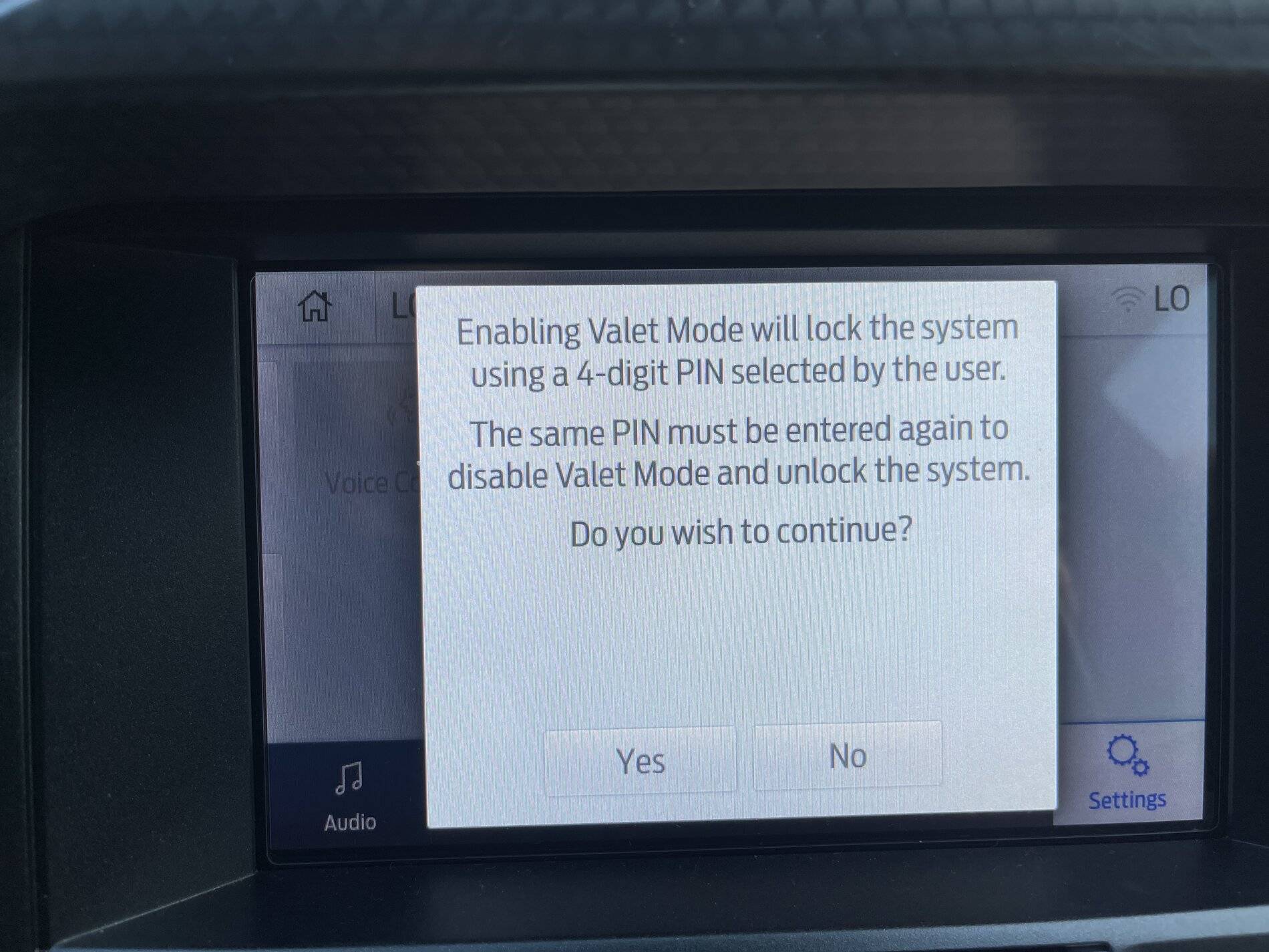

if you have this option your car will lock the armrest when you lock the doors and will only reopen if you unlock the doors with the fob or by touching the handle. If you leave your window down but lock car the armrest will be locked. This also includes the valet mode which if you enable it, it will lock your navigation, trunk and armrest until you put the pin code
Hope that helps.
WD :like:
Thanks. I’ll give it a go 👍🏻
