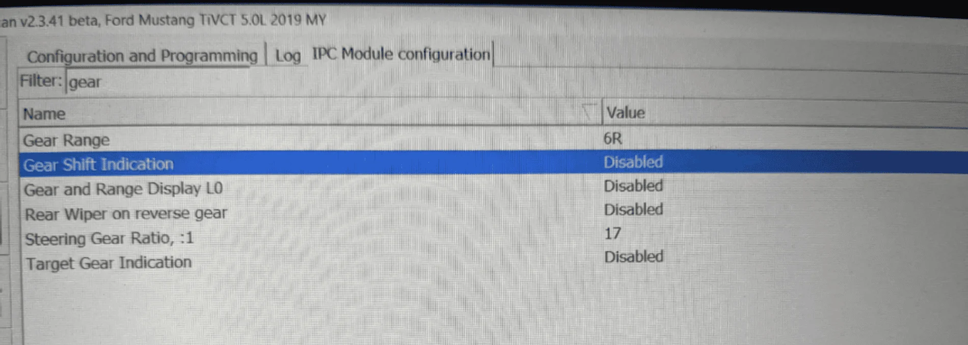

Are you trying to add the gear show function? I think it's a toggleable option in the list menu for the IPC rather than the bare code I'll check on mine once I get the free license.

Tried a bunch of things from the IPC drop downs. No luck, can you look at all of them and sort by enabled?
Thanks!
Thanks!
I've got a few corrections to do to my IPC after comparing with another IPC so when I go through it I'll let you know
Appreciate it, thanks. These are some of the ones I tried without success.
well i had a play about with the settings again over the weekend and i cannot for the life of me get the gear menu to appear i dont know what i did to get it to activate last time i even copied a 2019 IPC onto mine and the menu still didnt appear!? but i definitely had it on previously. i'm really stupid for not creating a back up. i'll have to do more research to see if i can find it.
That sucks man, hope you can figure it out. However, from what I was told it seems like it may be a software issue as my cluster is from a 2018 and the feature was not added until 2019. So it may need a firmware flash, this may not be a simple fix. But, maybe, just maybe :)
Yeah but I definitely had the menu option come up on my 2018 retrofit so it's frustrating as to why I can't figure out what it was, I'll keep playing and looking around. I tried a few more things a moment ago to no avail
