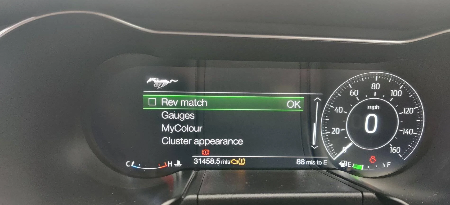

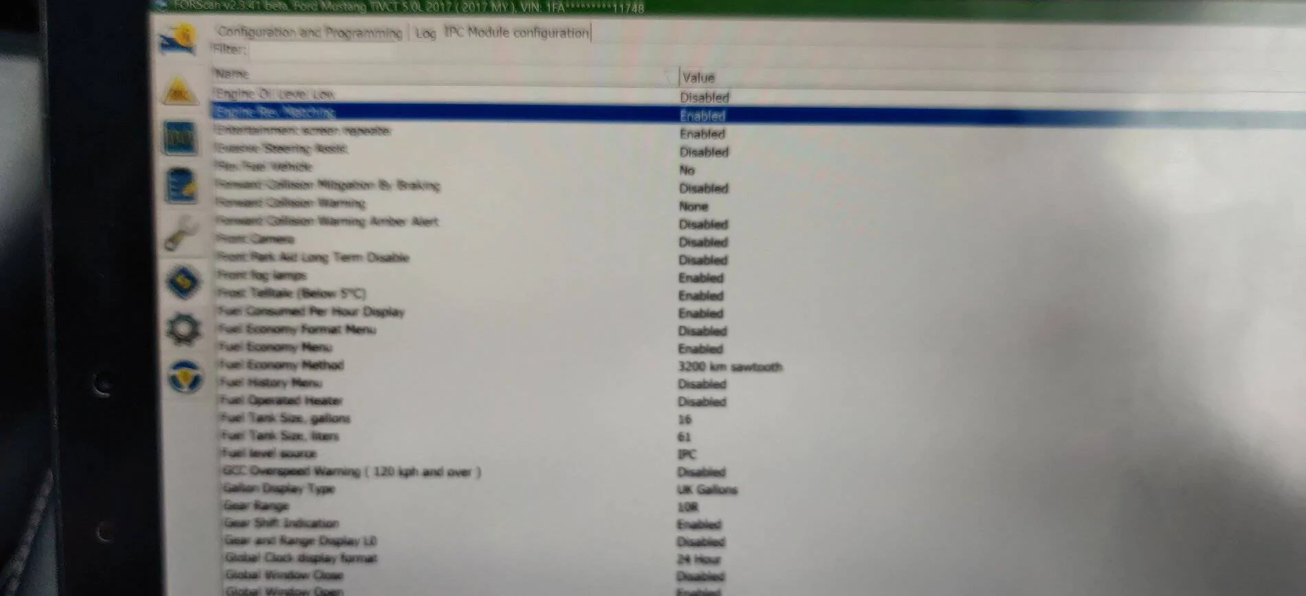

Just had a quick play and you can activate rev matching from the preset menu :like:
Apologies for the crap photo, but it's called engine rev match in the list just double click on disable and click enable then write!
The bad news is that I can't select it as like I said earlier I don't have hardware... Not only that now I've had a play I lost the menu for the gear show :curse: doh! And I couldn't find how to turn it on, I'll try and have a play another day to figure that out.
