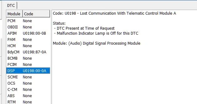

I made the change in the APIM, and now the FordPass page in the Sync settings has disappeared. So far, so good.
But the APIM, BCM and DSP are still complaining about the loss of communication with the modem:
The same DTC, U0198, is in all three modules.
So the information that the car has a modem must also be stored somewhere else. But where?
