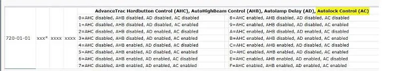

Thanks, JC. I did a search on the F150 forum and found this:
At first glance this looks correct, because my own As-Built data has an E at that spot (which seems to match my car's current configuration, I mean I actually do have everything active except autolock). So I guess I should change that E to F.
But then someone else said that if you change that digit, then you should also change the final one, because that's a checksum. Going from E to F is an increase by 1, so the final digit should also be increased by 1. In my case there's an 8 there, so I take it I should make that a 9.
I've never seen this mentioned before, but it does make sense. Should we calculate and update the last digit every time we do a change?
Edit: never mind that. It seems that ForScan will complain about the checksum being incorrect and will correct it automatically.

Indeed on your last sentence. And yes, I remember now that I changed an E to an F, so you should be fine :).
