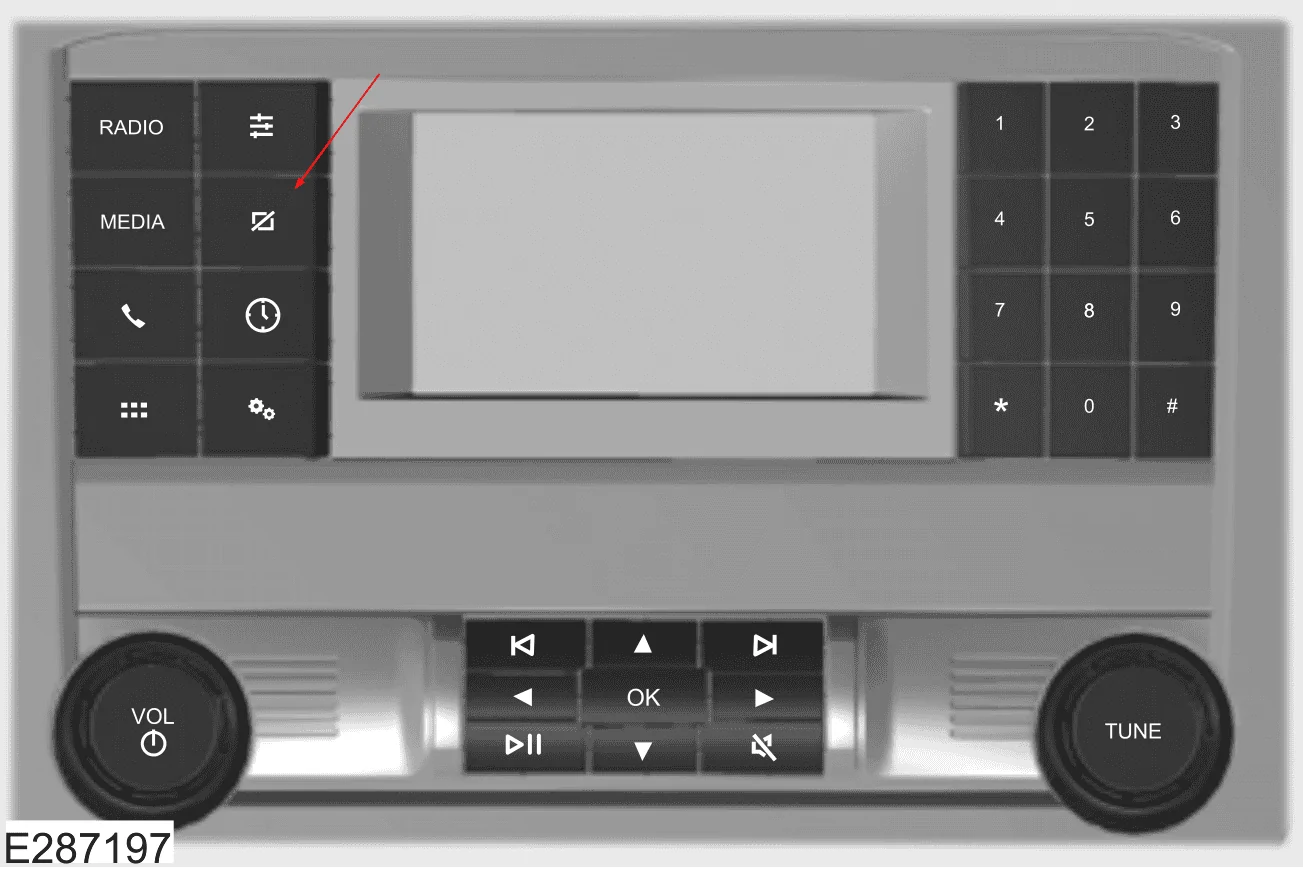

I checked the owner's manual and saw that the APIMs with smaller display have a button to turn of the center display (see red arrow).
Maybe I'm blind but I could not find this physical button on the newer APIM with bigger screen.
Right now I do navigate to the settings and turn it off that way which is kind of annoying after a few times.
Is there an easier way to turn off the display after starting the car or even have it off when starting the car and only turned on when touched ?

I don't think so, unless I'm also missing something. The only way is thru the settings, and it's so counterintuitive, that I don't even remember how to do that from the top of my head. I could find it relatively quickly if needed, but as mentioned, it makes that dangerous if done while driving.
Fortunately, the screen doesn't bother me, especially now that I have the gray/black Lincoln theme, so I always have it on.
1. open settings
2. swipe to the right once
3. tap display
4. tap turn off display.
Got an answer from my dealership today: They said the button was removed due to regulatory reasons: The display is there to show important messages.
They also mentioned that the brightness could be lowered a bit and that there is a night mode.
Still having a black and grey theme sounds more attractive.
What a load of bullshit. 'Important' (i.e. safety-related) messages are displayed on the instrument panel. Everything that's displayed on Sync is completely optional; nothing of that is legally mandated. Sync itself is an optional feature; you may not even have that screen at all for all the regulatory bodies care.
I wonder if they are taught this kind of garbage in their trainings, or they just dream it up on the spot.
