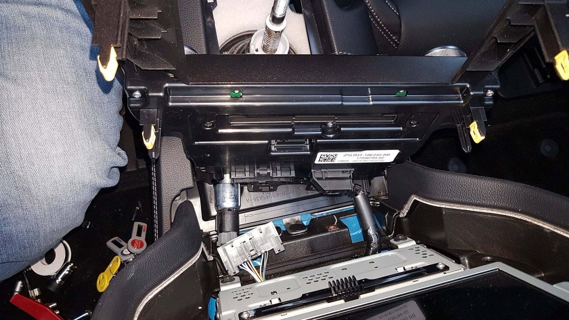

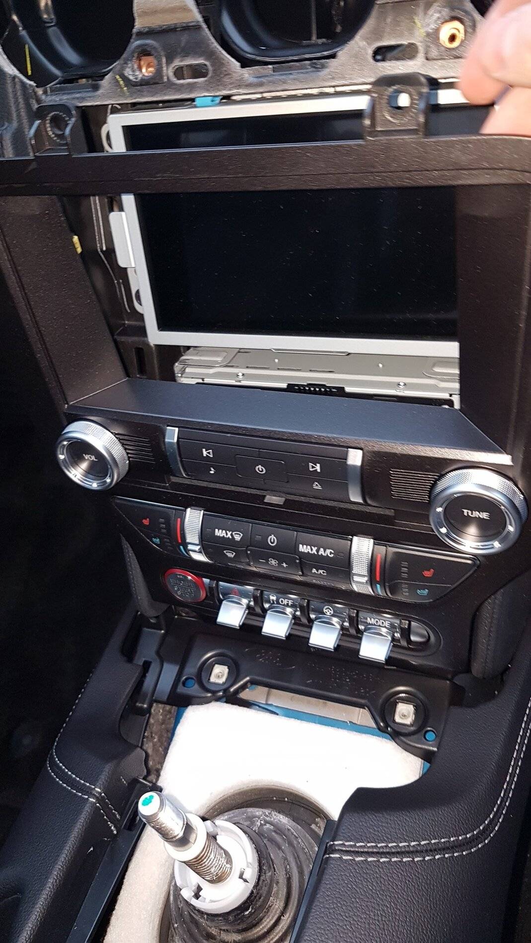

I also haven't seen any warnings so far. Everthing import was shown on the digital cluster display.
I disassembled the interior a few weeks ago when I was installing something and took some info in the process.

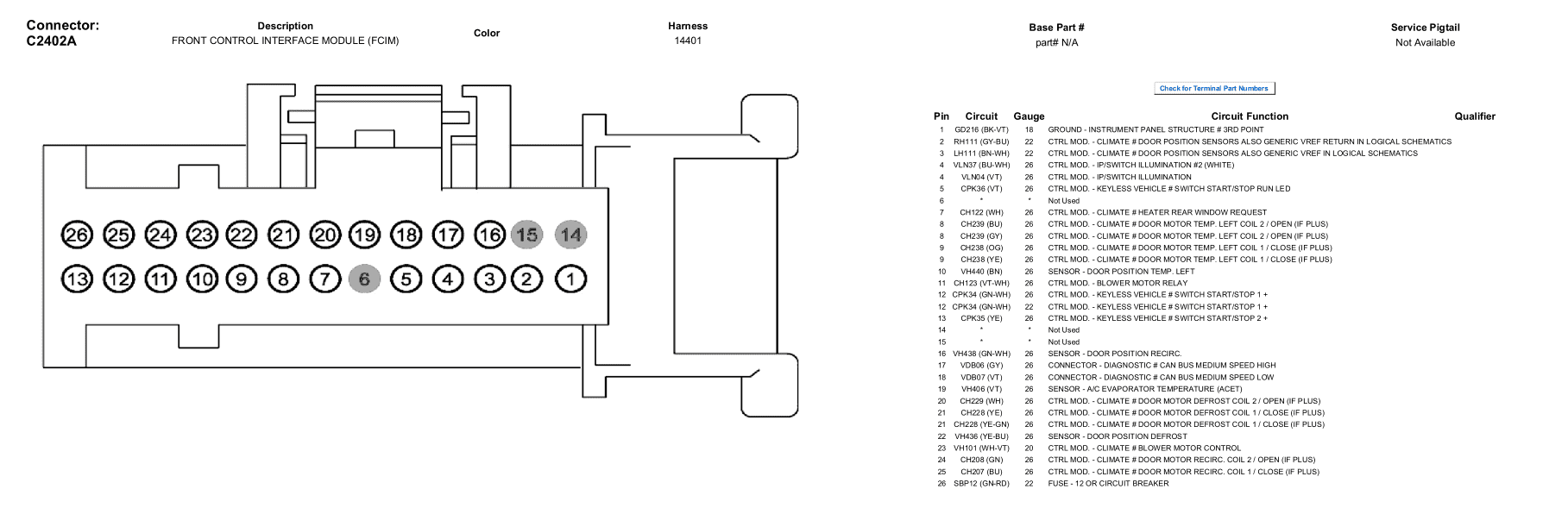

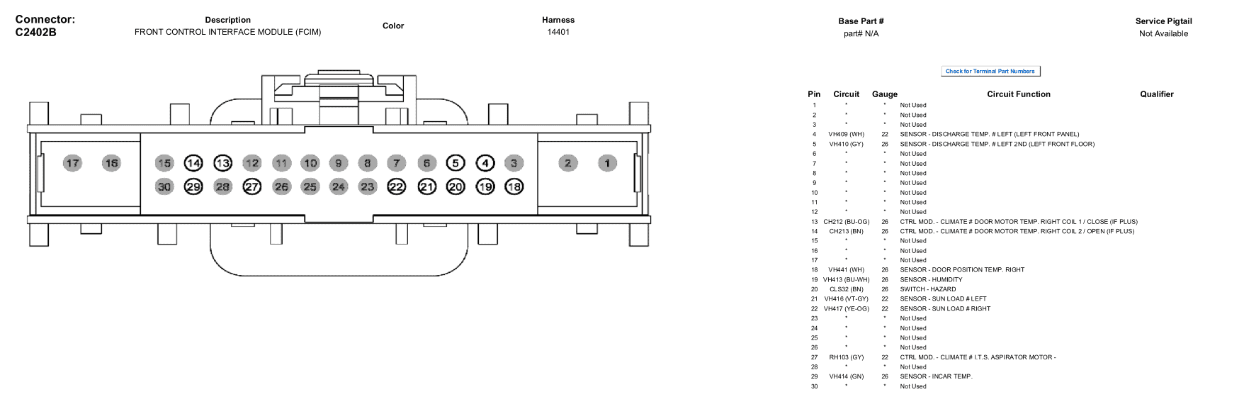

The center trim covering the APIM is called the FCIM (front controls interface module). Part number LR3T-18E245(-BB). There are 4 connectors, 1 for the start-stop-key, 2 for the other buttons and 1 for cigarette lighter.

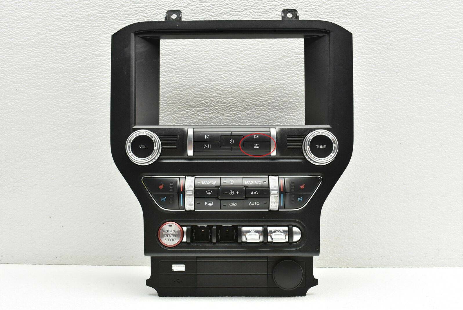

There seem to be different FCIMs probably depending on equipment level, I found this on ebay which has a different button.
Mine has the CD-eject function at that location.
The OFF-button in the center of the 5-Button cluster is for turning off the music. Maybe it is possible to reprogram this button to disable the display instead.
