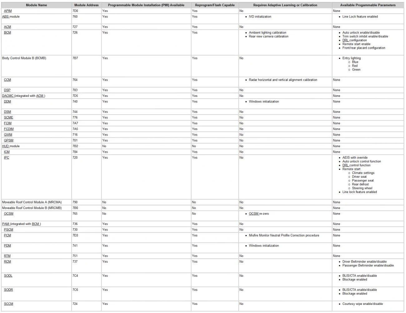

I just watched a video about the GT350, and have to ask, in the video the guy driving and reviewing it shows a Digital Speedometer, Can you confirm you have this on the GT350? The review was on a 2016. This would be something we all here would want and wanted to know if you knew its location, or if its in the Tech pack you were speaking of?
I have a 2016 Track Pack GT350 and it has the digital speedometer function as do the '15 and '17 models. It shows up centered on the gauge cluster when accessed. I used it on trips as it gives you an exact number quickly so you aren't guessing while glancing at the dial gauge. I can see why you'd want it if you didn't have it.

On the FORScan vehicle info log tab... what is your listed calibration and strategy loaded on your IPC?
Curious if they are the same as the guys without. Not going to be able to enable a gauge if it doesn't exist in the underlying firmware
Yes you can Neo :D
I left you a pm on the other forum [MENTION=25893]DanMc85[/MENTION], About the gills and it lighting up.
And I pulled a vin of a GT350, to compare. Heading down to try it now. And I'll see if I can find that info you asked.

found my service cd for 2015 mustang.
looks like the same thing as gt350 thread has, unfortunately. also no details about each.
I have a feel a combo of the IPC and BCM would be able to have the configurable DRL option back in the menus.
