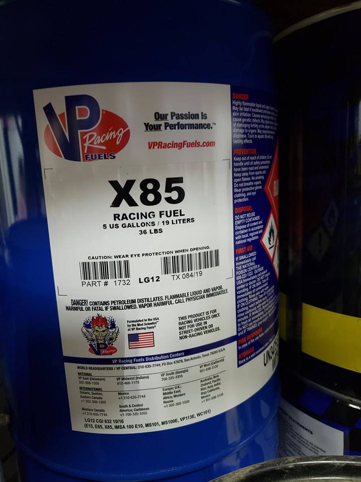

So I got a good deal on non-oxygenated E-85 ( bought four 5 gallon pails for $150 ). I believe FORD says E-15 max for 2017 5.0's correct?
But I read in this forum (and others) that with stock injectors you can go E-30. Now I'm not smart enough to argue what auto engineers say,
but has anybody do any definitive testing on up to E-30 - E-50 with stock injectors? Thanks!

That quite honestly was a little silly to pay 150 bones for when pump prices are $1.94 per gallon E85 down here.
Silly? Really? Hmmmm... no E85 available up here. And a 50gal drum costs $770 + tax. Thought I got a good deal?
Others: basically bought it for a little octane boost. Was gonna mix 30% with 94 octane non ethanol (I'm tuned for 93).
