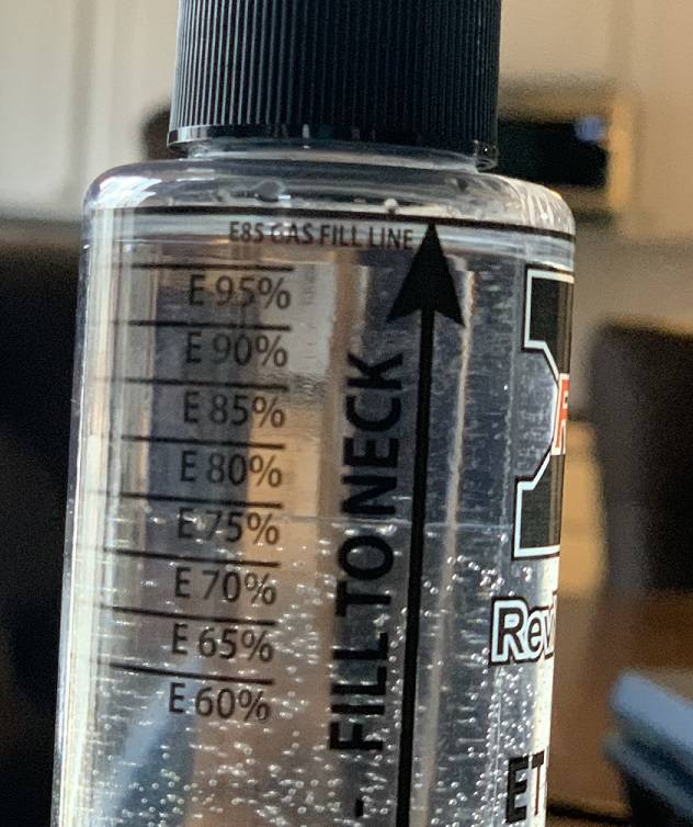

I just tested the local gas station. Am I reading this right? approx. E-78

e74...
