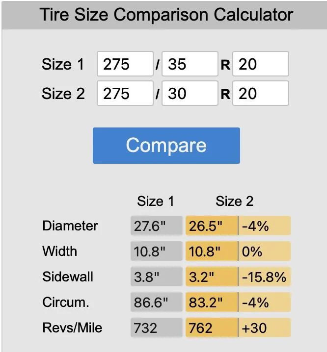

Even with 20s, most of us go with a 35 series.
Why? When I got my 20s I used the calculator and to stay within closest to stock radius it recommended 30 series, and the distributor also recommended 30 series. I don’t really notice much of a ride quality difference with the magnaride. Is it to preserve sidewall for ride quality?
