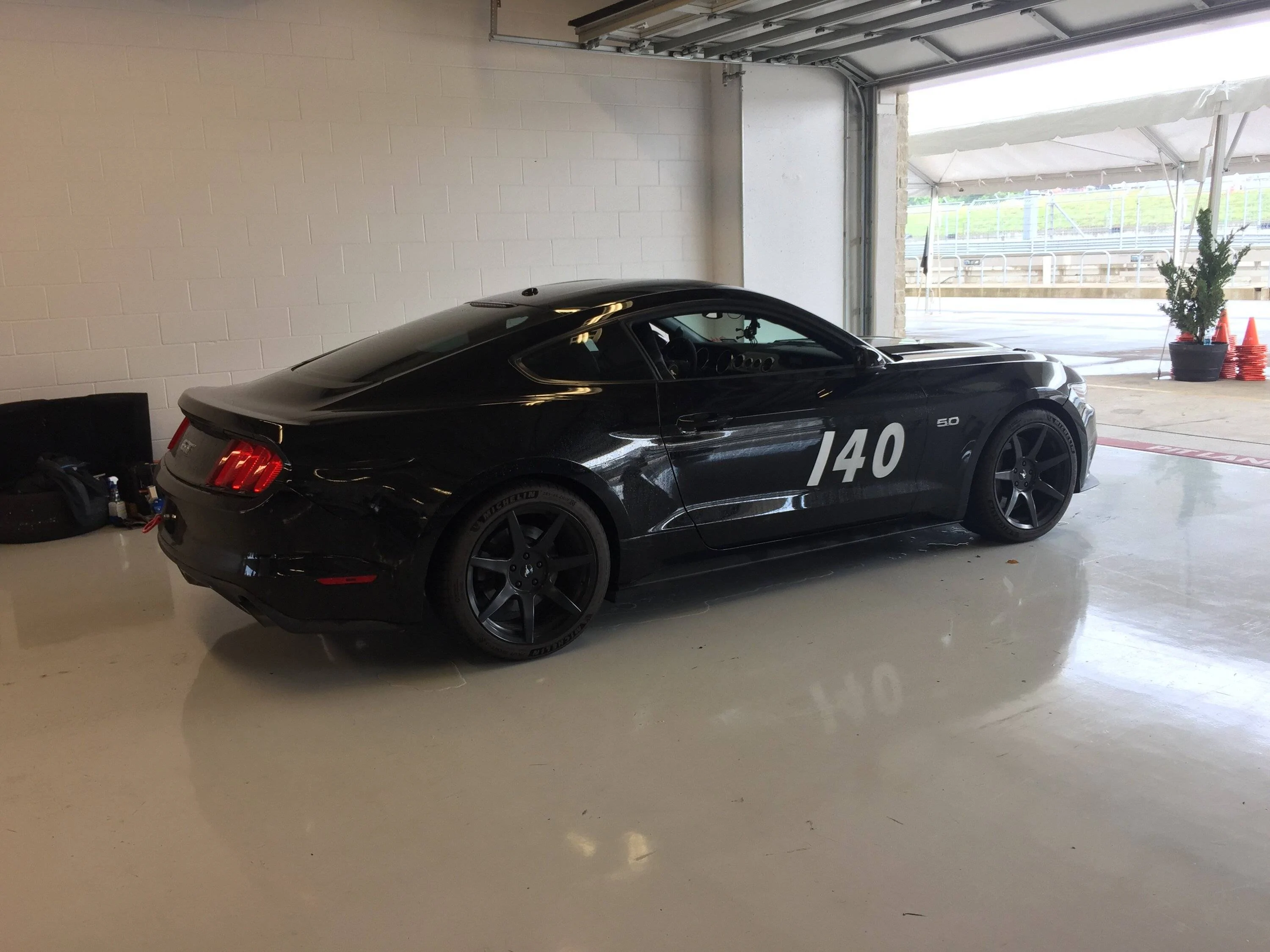

Can you post a photo? I am interested in seeing what they look like as far as fender gap. Do you run spacers? Is your car lowered? Did you keep stock back spacing (for the rears) on all four?
I would prefer not to run spacers and am not going to lower the car.

This is stock springs and ride height / fender gap. I may have a 5mm spacer on the front because I was running a bit more than stock camber in this photo, but this is pretty representative of what it looks like.
The ET35 10" wheel is a more aggressive offset than stock and so it will sit closer to the fenders than stock wheels, so that really helps to visually close the fender gap without actually lowering the car.
