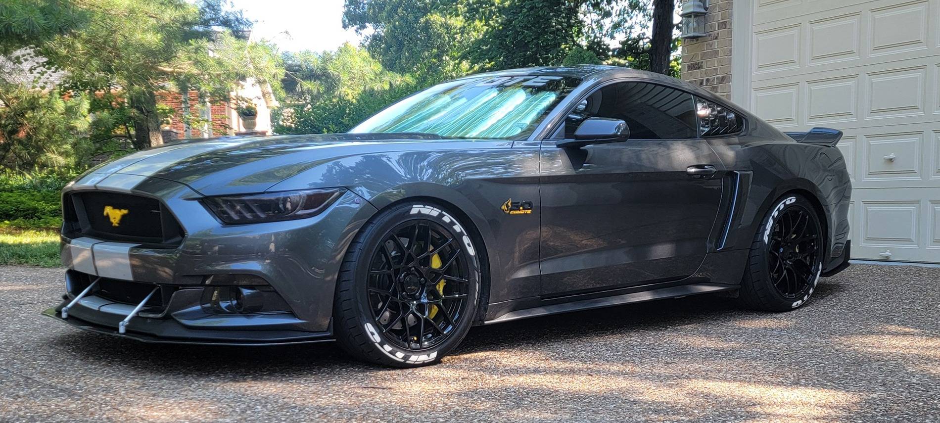

I'm kind of in the same boat. My 2017 was my daily until October when I bought a new SI. Originally the car had PZero, then Michelin 4s and then I gave Nitto 555 a try. Didn't like the Pirelli's, Michelin were nice and Nitto ok. So, now my Mustang is car show, auto cross and maybe a track day only car so I just put Cup 2 's on it and I really like the feel. Note: Handling is more important to me than comfort. I'm running Ford Track shocks and struts with Steeda linear springs. Also Gforce Outlaw axles. Car is also Roush Supercharged. If I get 10,000 miles I'll be happy because that'd probably be four years of limited use for me.
I've been on this site since I purchased the car and it's an encyclopedia of Mustang knowledge. If you don't know ask and I guarantee you that someone knows it. It's saved me a lot of time, money and head scratching.
Finally I'll say it's different strokes for different folks. If it floats your boat do it but check out your decision on this site for a possible problem you haven't thought of. Thanks to everyone of you Mustang nuts who've helped me out many times. BTW... I'll be 80 in August.
Semper Fi!
