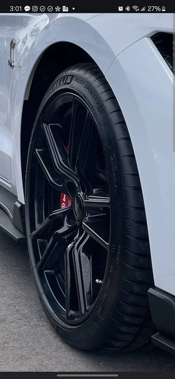

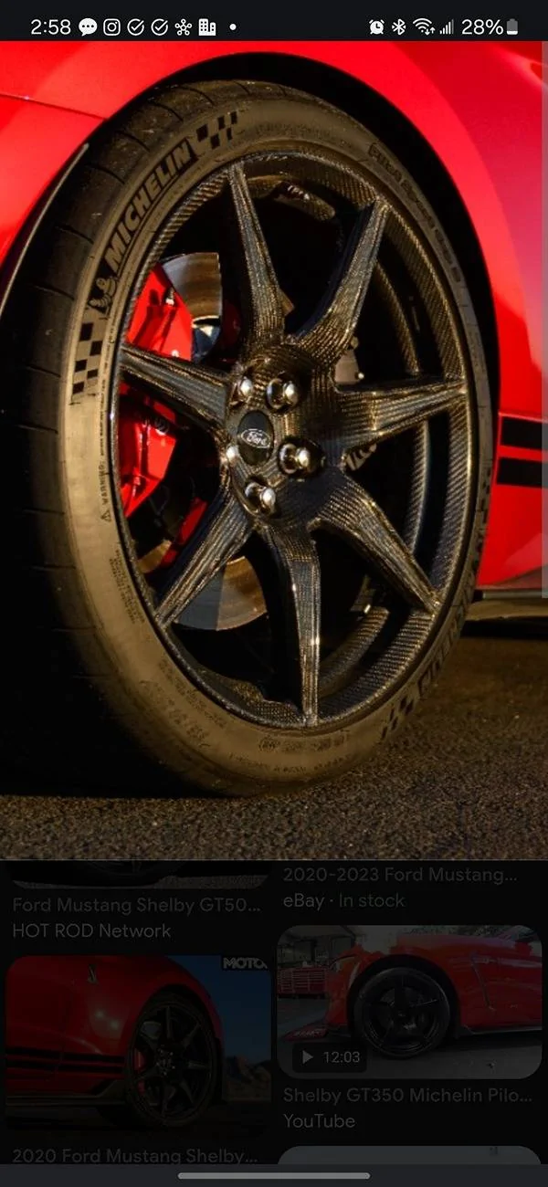

The cup2 have the big blocks on the side so it almost looks like a slick and the outside grooves dont come over the sidewall of the tire, where as the 4s has smaller blocks and grooves that come over the sidewall of the tire, plus the graphics look a bit better on the sidewall.
My car is 2018 so it came with super sports and the old suspension set up so it tramlines like crazy, doesn't bother me much i kinda like how it makes me drive the car more. Not a daily so not looking for comfort.
4s
Cup2
