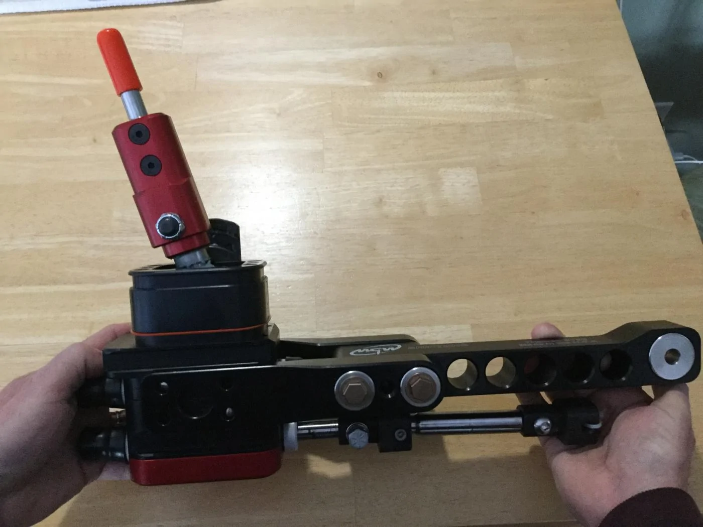

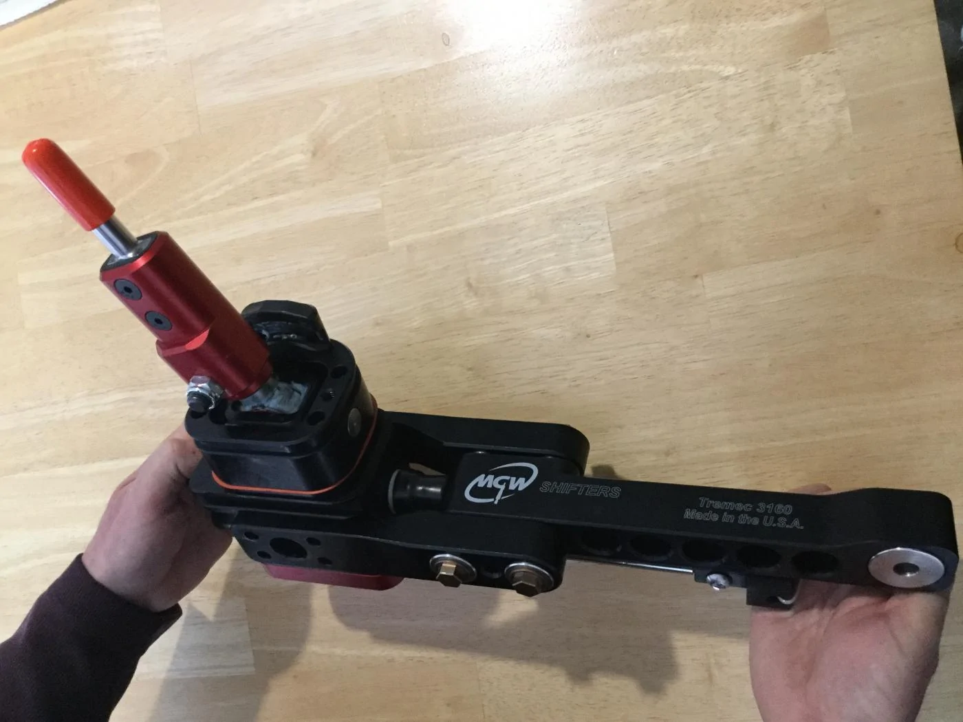

So, I take delivery of my MGW shifter yesterday; I pull it out of the box and start fiddling with it when my wife walks by and says “You paid $500 for that?” Understand, she’s a very intelligent woman and was certainly not implying that I got ripped off. I said “I know, this thing is amazing!” We both examined it closely and marveled at its sheer beauty and heft. On background, I’m a Mech. Design Eng. and have worked in the Aerospace/Defense industry for 32 years; worked on a lot of interesting and complicated projects. In my business, I can’t imagine being able to buy just the linkage rod for $500, unless I was buying them in the thousands. This is an incredible piece of kit! If it works half as good as it looks and is built, it’s going to be spectacular. As a matter of fact, I think I might buy another one just to display in my garage!
Installation will have to wait, as the weather in these parts is currently uncooperative. But I’m looking forward to turning some wrenches and will report back with my impressions of its functionality. I’m sure I won’t be disappointed!
I added a few pictures of me holding it, because, based on all the pictures I’ve seen, I never got a sense for how big this assembly is. Very nice! Great job MGW team!

If you like the way it looks wait to you feel the way it shift's. It is so crisp and clean. You will love it.

What impresses me most about George is that he never stops looking for ways to further refine the design. It is never a matter of something being "good enough." He takes advantage of material properties, coatings, and tolerances such that the finished mechanism is extremely robust while providing shift quality second to none. My favorite - the second to third shift. You can hit the knob/ball forward with an open palm as hard as you want and the shifter guides itself up and over into gear. Extremely satisfying.
Simply put, this shifter makes the GT350 experience a better one.

I like the way the side arms are now pinned to the shift box. Very robust.
Of course it is always easy to look at someones design and suggest changes, but one thought I had was to integrate the fixed side of the linkage rod with the linkage rod itself - make it all one piece. Maybe there are reasons this doesn't work or make sense - Just a thought.
Either way, it is quite an impressive design and I'm looking forward to experiencing the shifting experience!
One other thing - MGW should should provide you with a small MGW sticker or two - I would proudly affix them to my car.

Zombo, the reason for the linkage break is ease of installation.

I suppose I wasn't clear. The linkage rod itself has 3 main components: the rod, and 2 end fittings. One end fitting is fixed to the rod, and the other has a swivel joint. I was suggesting integrating the fixed end and the rod into 1 part. This would not impact installation, as the linkage rod would still be a separate sub-assembly. It was just a thought...
