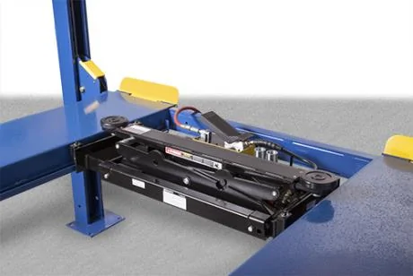

Due to the ceiling restrictions, I can only have about 38" of room under the car with the lift.
I have a rolling scissor jack (see picture). The issue is (or maybe its not an issue), as you can imagine the jack sits level with the runways and is about 3" from the exhaust pipes. That means in the best case scenario, I can lower the transmission by that much. This is why I wanted to ask how much you lower it because I dont want to spend another $200 on top of $1200 I spent for this rolling jack.
[MENTION=19066]Epiphany[/MENTION], I could do that yes but how stable will that be? Also, are you saying you have to lower it 6"? :)

Yup I use 4 posts all the time. It's a love hate thing.
The thing I linked you with will come in hand a lot
It's basically an extra set of hands and will not be in the way like your rolling jack will be

Probably you are right but I will try to make do with rolling jack and if not ephipany's advice of 4x4 on a floor jack. I spent so much money already another $200 is too much. Plus hardly any space left in my garage to even walk!:) I already bought a 2 ton crane to install the lift:)

Also noticed that jack goes to 48" lowest, i cannot have more than 36-38" under the car due to ceiling. So my backup will have to be floor jack.
I ll build a custom adapter from 4x4 so it grabs the trans and floor jack and doesnt move around.

Don't overcomplicate the simple solution suggestion I made. Cut the lumber as I indicated so that you can both raise and lower the trans as well as being able to slide it into place or remove it. Place the jack so the lift point is directly beneath where you wish to make contact with the trans. It doesn't get any simpler than that.
And if you can't manage that without any modicum of safety you probably shouldn't be doing any work to your own vehicle.
ON EDIT....you could also place a 4x4 across the channels that are used for your rolling jack, place a bottle jack atop of that horizontally placed 4x4, and use a much shorter length of lumber placed vertically between the jack and the trans.

I will do that (the first one - I dont think second one with bottle jack will give any more clearance than rolling jack).
I think I wont need this though because 3" will be plenty I think. I seem to remember George saying you need "couple of inches" in the first MGW video. I also think too much is bad for the engine mounts anyways?
I did exhaust/brake work before as well as plugs and standard maintenance work. Nothing like this though, never lowered or dismounted transmission.
I was planning on using that rolling jack in the future for changing the clutch as well but I dont know if thats possible at all.
