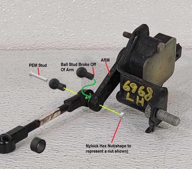

If it was a contest, both of you would have won. It turned out to be a broken sensor on the driver's side, I must have hit it when installing the strut and never noticed it. The MR sensor arm has a molded ball which snaps into a socket on a little rod connected to the control arm. The little plastic ball snapped off. I was also able to fix it stronger than it was. This little piece was molded with a hole through the middle top to bottom. I found a small pem stud that would fit through it and then ground the stud head down slightly to match the shape of the ball. I now had the same plastic ball but improved with a thread stainless shaft. I fit the stud through the hole on the arm and added a nylock nut. It now has an inner steel stud instead of just plastic. I took her for a drive and the message is gone now. I really appreciate the quick responses.

Glad you got it fixed without too much trouble. Did you take pics of the fix to post here, in case someone else needs to make the same repair?

Dude, okay now you have to post pictures of that fix!
(My suggestion was going to be to inspect the plastic ride height arm. Whenever I do this type of suspension work, I disconnect the battery, and make sure to disconnect the ride height sensor(s) as needed, since they are fragile plastic bits attached to big spring-loaded parts!)

Unfortunately, I was in a hurry since I had to get done so I could drive to work. I went back and made a crappy Paint image of what I did that may help. Some of you may have never heard of a PEM stud, but basically they are studs that are pressed into sheet metal to provide fastening of parts. These have a very minimal head which worked perfect for inserting it through the broken ball stud. All I had to do was file it a little so it would be flush to the ball. Once the stud was through the ball stud, just drill out the hole on the arm and insert the ball stud with it's new stud. All it's left is to fasten with a nylock nut(hex nut with nylon inside) and all is god.
