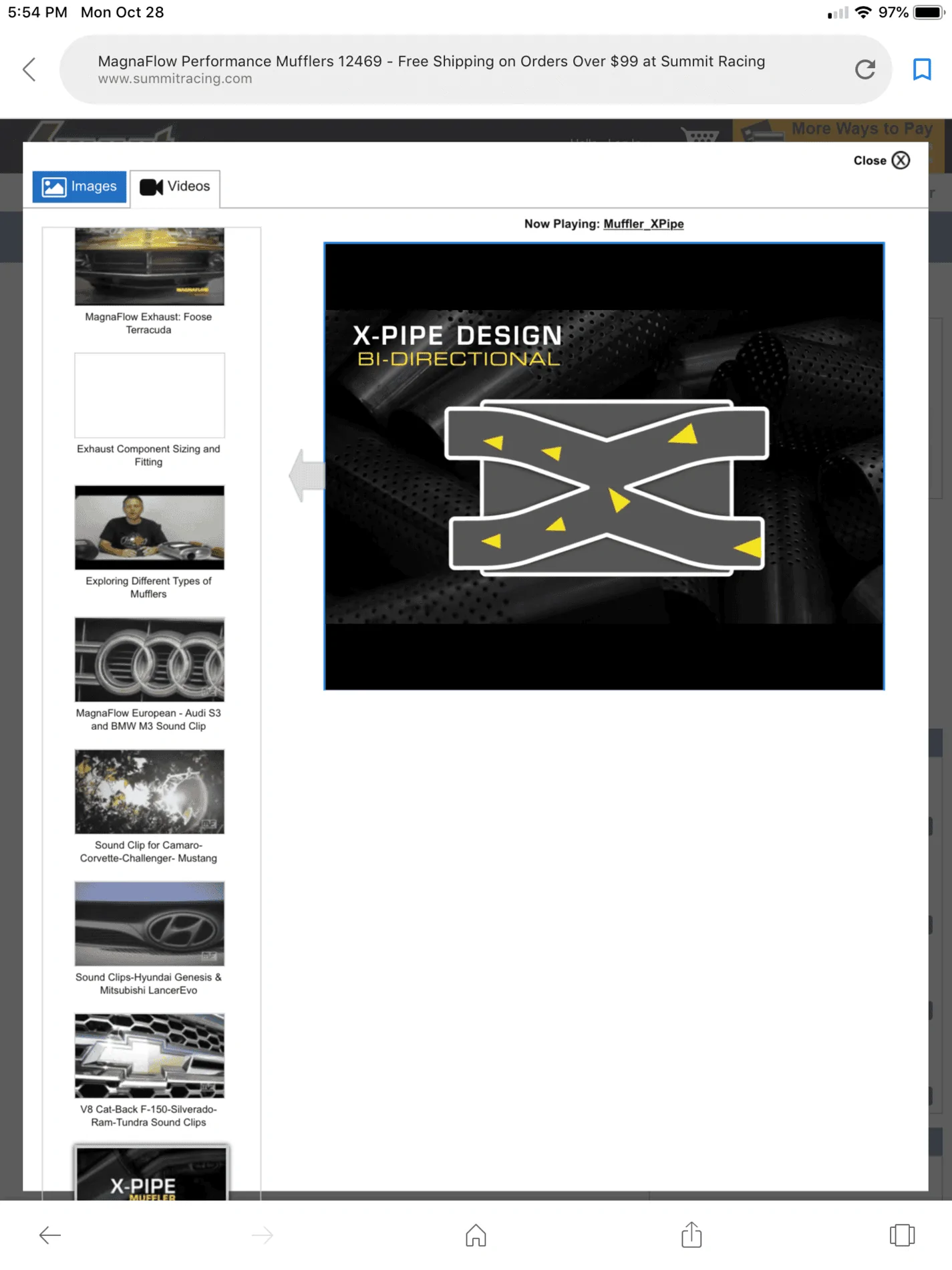

This is what I find when I look up the
MagnaFlow Performance Mufflers 12469
3inch in and out.
