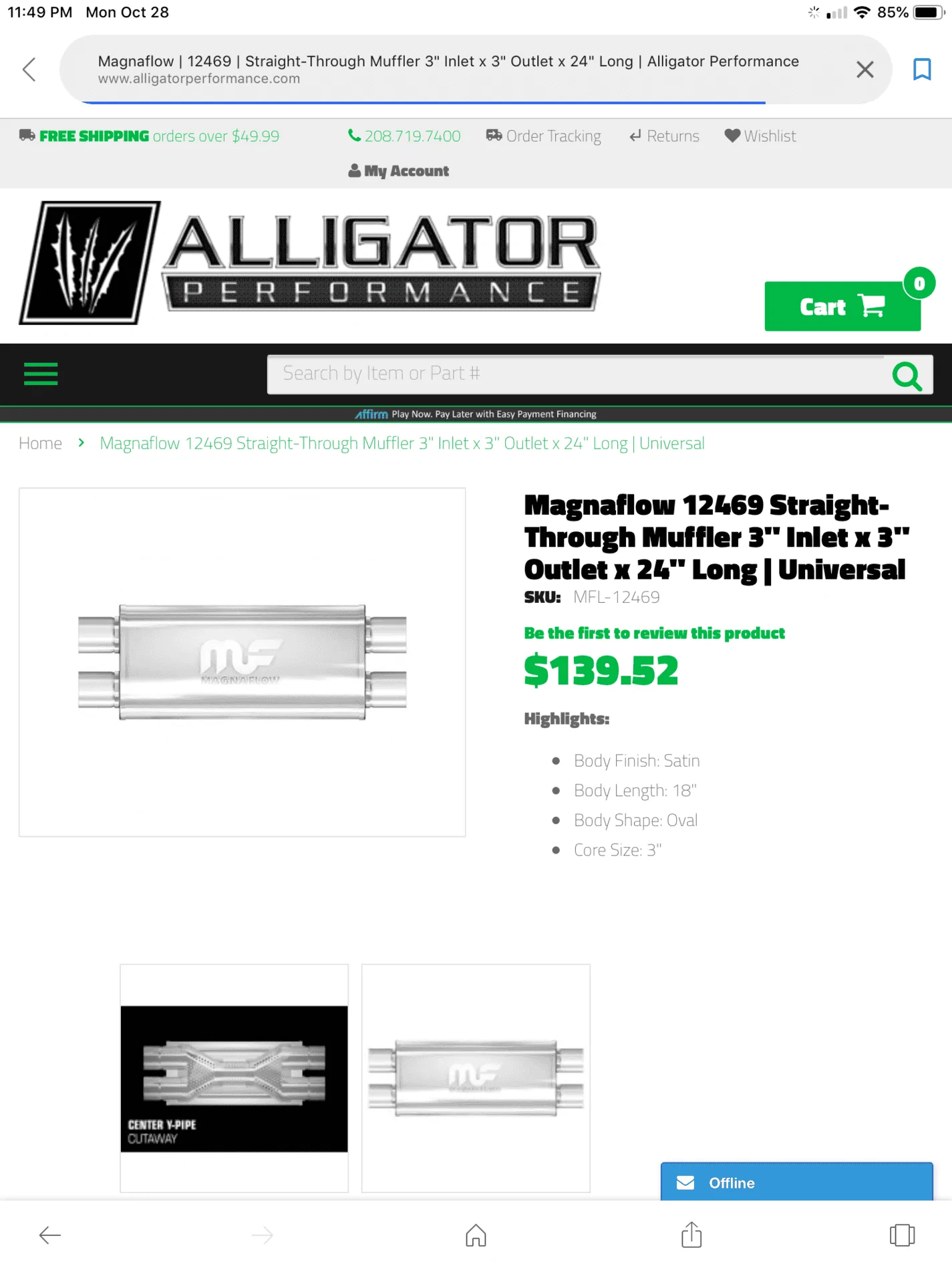

That would be awesome. If I ordered that and looked inside and saw this it would be sent right back.
Kellys69z
Jun 30, 2015
264
83
Mesa az
2015 gt premium, Dodge 2500 Cummings, 69 Camaro
I had one on my car for about 6 months. That’s how long it took to blow the packing out. I never took a picture looking into it, but the one I posted is how it’s made.
17gt3black
Jan 30, 2017
Coatesville
2017 mustang gt premium
Cool thx. Guess I’m not going with them. Going to hit up solo 2maro to see about there Mach Xv. Or just going with 2 resonators. The email I received from maganflow told me to put this or cats on. Explained stainless works said cats will not hold up to over 700rwh.

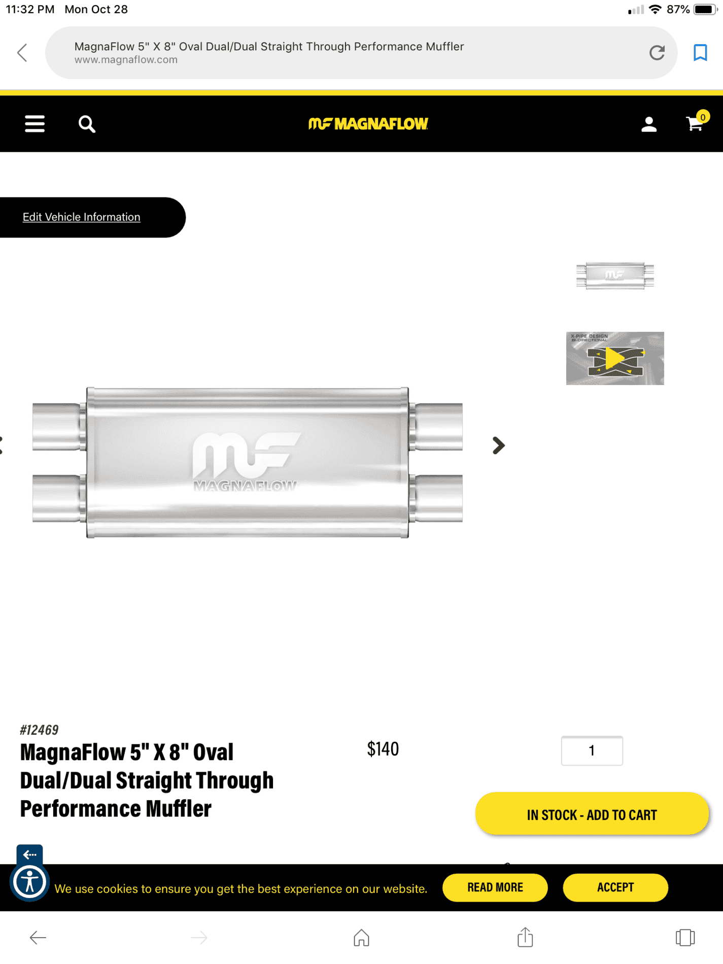

Here is a double 3" to double 3" muffler that says its an X pipe design from magnaflow now.. Anyone try one of these?
#12599
https://www.magnaflow.com/products/...dualdual-straight-through-performance-muffler
Also here is a dynomax dual 3" inlet 3" outlet resonated x pipe
17554 , this one kind of looks like it necks down from 3" to 2.5 inside the muffler though..
https://www.jegs.com/i/Dynomax/289/17554/10002/-1
12599
straight through double 3"
https://www.holley.com/products/exhaust/mufflers/parts/12599-FM

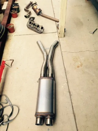

Home built resonator delete on my 2018. This MF muffler is true 3" in and out.
Before this install, it was too loud since I added the MAK deletes. Had to chop off the factory connects on the MAK pipes and then the muffler was welded straight to the MAK pipes.
Ran some 3" pipe to the axle backs.
Car sounds amazing!! Highly recommended.
