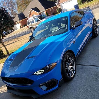

Can I do this upgrade without any adjustments?
I have the Appearance and Elite packages only, with the 5-spoke base wheels. Recommended tire sizes? TIA

Yes, mine is a Non HP car with HP wheels. I have the factory HP sizes (305 30 19/315 30 19) and they fit just fine. I have the front fender lips and rear fender spats from the HP car though, they are kind of needed on the front since the fronts poke out past the fenderwell without them...

You'll likely need to dial in a little negative camber to get the front wheels properly tucked if you stick with the stock HP wheels.
The SVE wheels won't require that because the fronts are 10" wide not 10.5" like the stock HP wheel.
Also if you are an anal clean freak, adjust your weekly allotted time to wash the car, because the HP wheels are a challenge to clean. That alone has me looking at other options for street use.

I just did the whole LMR kit (LMR is local to me). Bolts right up and includes tire sensors. Make sure you have the TPMS relearn tool.
The only thing I’ve noticed is I think my Speedo is a few mph off. I haven’t dug into that fully so I could be wrong, it’s just a seat of the pants thing. I’ll use FORSCAN and verify.

I just got done doing the HP conversion myself, couldnt be happier with the look. The prices of the HP wheels came down quite a bit and I got them for $1500 delivered. I stuck with the PS4S instead of the cup 2s and and very happy with the results. You will likely want to add in the front wheel well flares and the rear GT500 splash guards. The tires do stick out a bit but the stance improvement is extremely noticeable.
