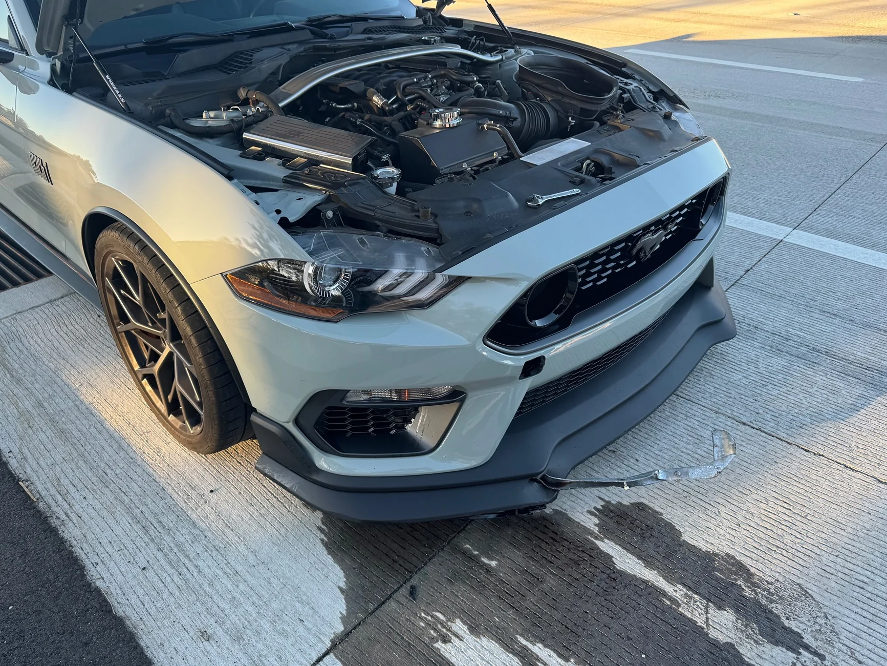

I hit a sharp metal object that pierced through my bumper into my oil cooler. Seems to be the transmission oil cooler. I made a claim and it’s at the shop. I have made it clear I want new OEM parts but these insurance companies always try to go for used / aftermarket based on my policy. Would this be something I should do at home? Just seems like it will cost me a good amount out of pocket might as well go with my deductible and pay the difference if they refuse new parts. Let me know your thoughts

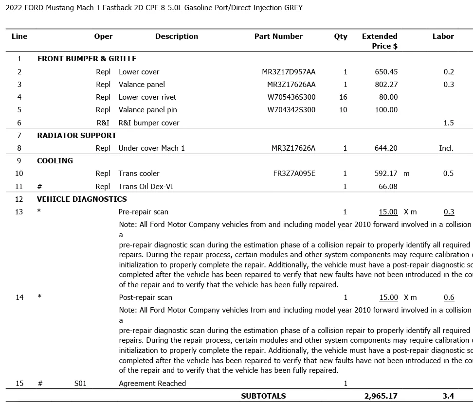

Here is the approved estimate with the part numbers.

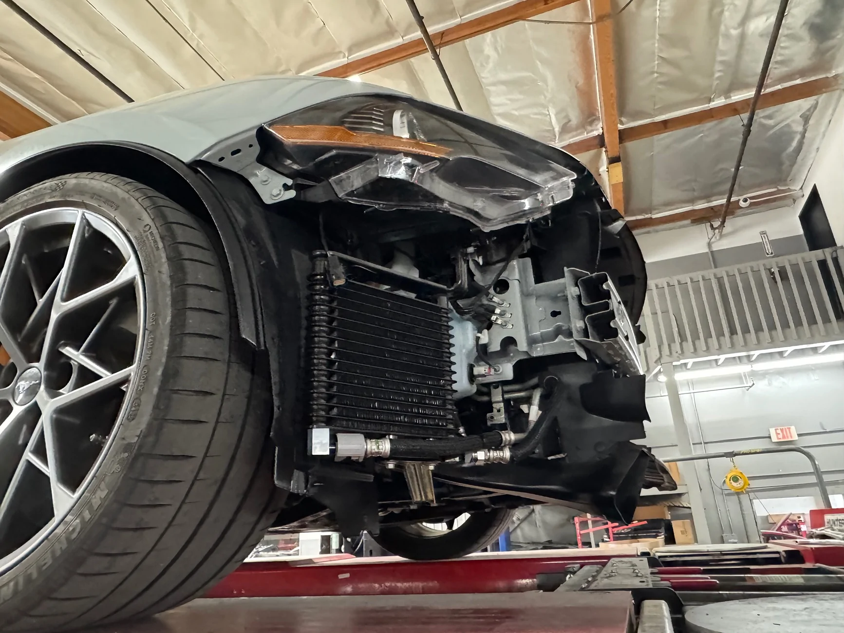

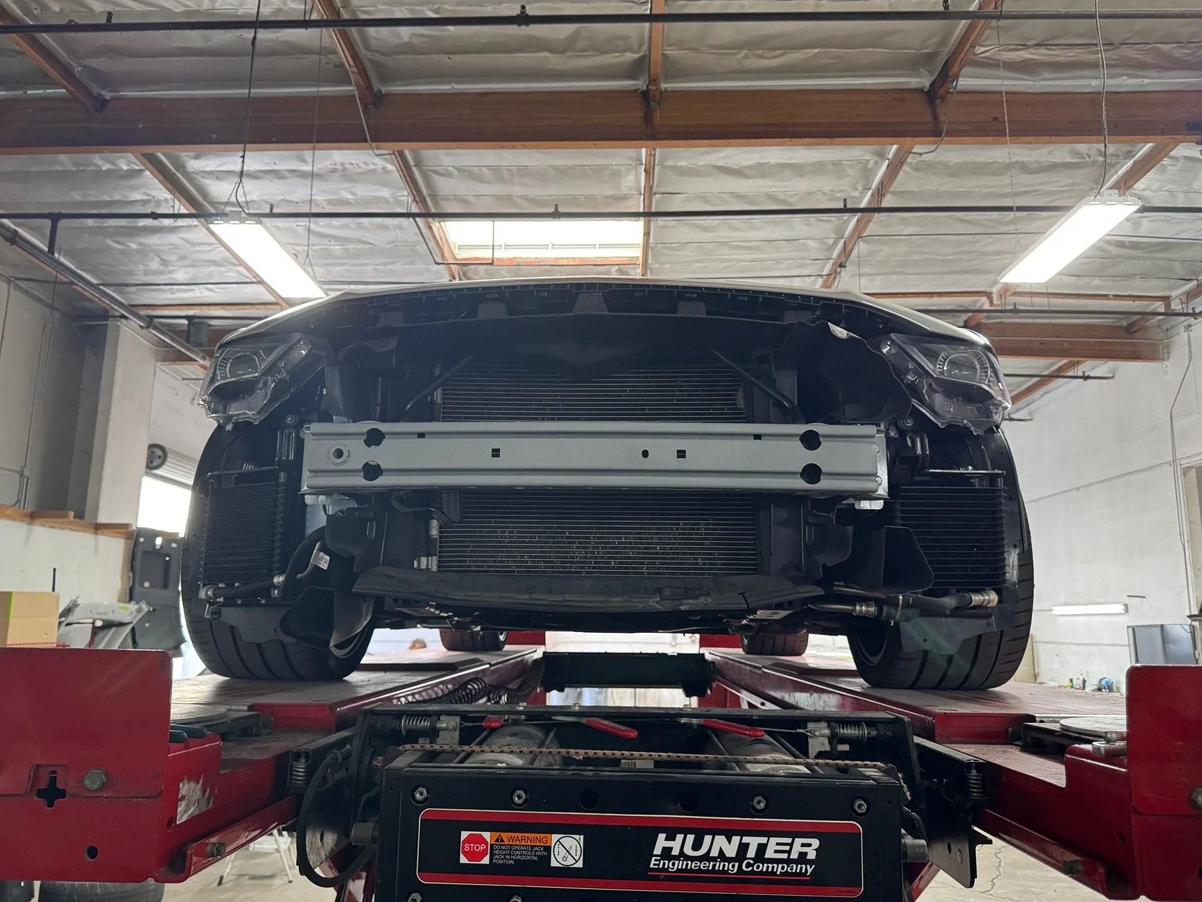

Inspected the new parts, all look new OEM.
Looks kinda cool with no bumper. Those wide front tires look nice.
It's pretty cool seeing them with the bumper and belly pan off, you can see all the coolers and work they did to plumb coolers, package components and direct grill, cooler, and underbody airflow. I do think the engine oil cooler needs to be larger though.
Hello; Two things come to mind. One is why a fender bender can be so expensive because of all the stuff under the front covers.
The other is I get the idea of a larger oil cooler but as most vehicles do not even have one at all, the one in place is a good add on. I guess they put in what would fit. But yes, bigger would not hurt.
Check out the 7th Gen cars. They have coolers in the same places as the 6G, AND moved the PCM to right in front of the right front tire. Where something as minor as knocking down a mailbox can leave you stranded. Pretty much just above and behind the trans cooler in the above picture.
