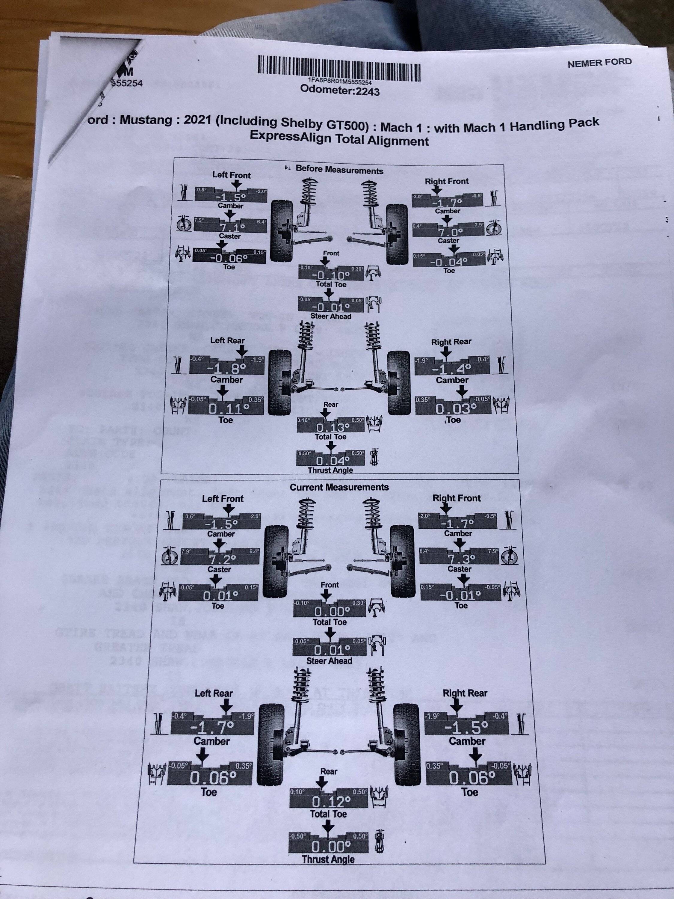

so here what they gave me. Left front toe was RED and corrected. The "it s good enough" answer I was feeling. It was free, how s it look? Plus I don t have the HP, not sure the title on top means anything? Car drove fine on way home.

so I just notice if you look at the top of the printout, I don t have an HP first.
Then checking further my camber is set up for track. 1.03 is street for non HP.
call the dealer and he ll look into it. (he has a GT350 or 500).
They also told me if the toe is 0 I don t have to worry about inner tire wear with the aggressive camber. ???? I don t know, awaiting answer. anyone know?
Street car only.
Correct, what wear tires is mostly toe, not camber and 1.5 or so camber is still pretty mild

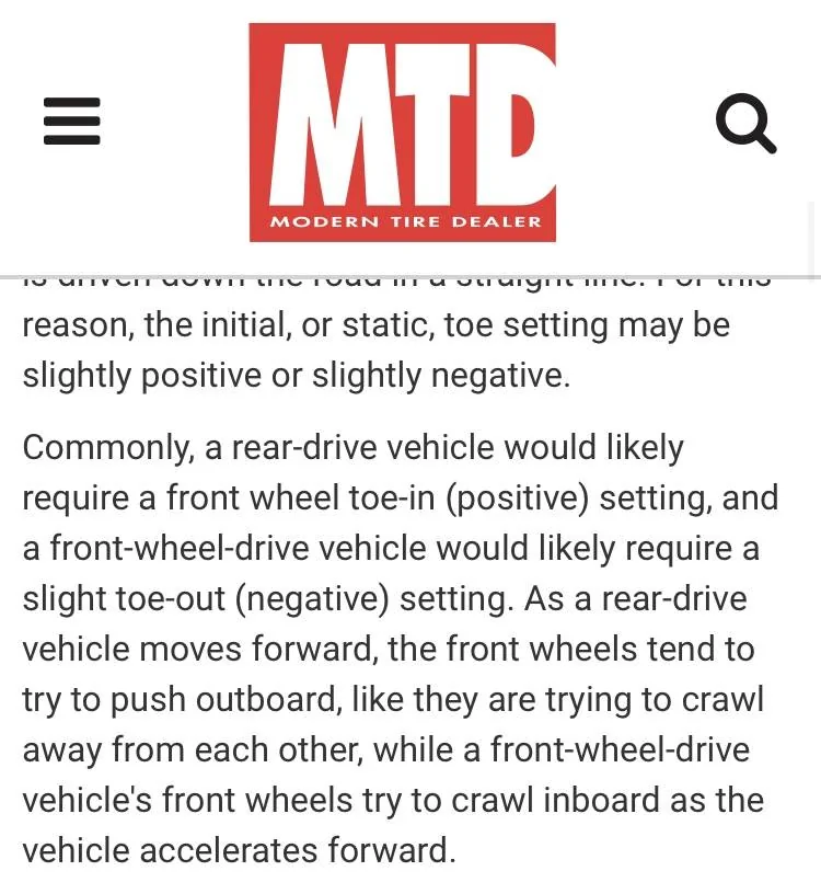

The front tires toe-out due to road load, breaking and when turning. You need a hair toe in to stop the inside front tire wear.
I 100% disagree with that
With 0 toe there is no reason, assuming no play in steering/suspension, for the toe to change
Also, even assuming that you were right, you spend way more time driving straight without braking than turning or braking therefore you will get way more inside wear due to constant toe in than the occasional toe out
Also with anything beside 0 toe, under braking, simple physics would dictate that the braking load would tend to increase whatever toe setting that you have

OP, your car is fine. Could it be more perfect? Sure. But it's fine for daily driving. Also, those laser machines are far less accurate than what anyone could do with strings in their own garage if so inclined.
